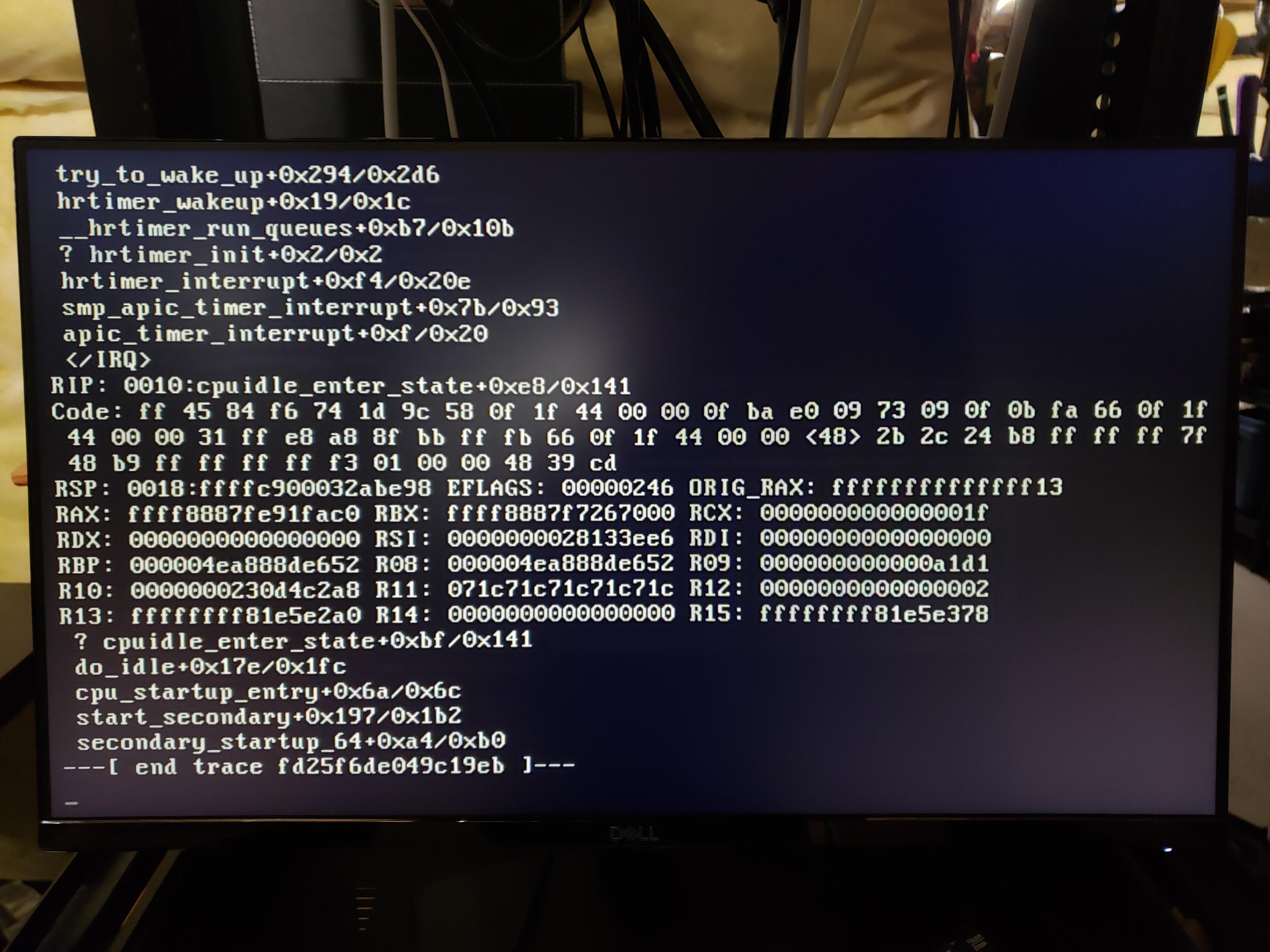

I've setup and installed UNRAID, mainly following Spaceinvader One's AMD guide. After a couple hours it locks up or throws an error. I've attached the diagnostics and a photo of the issue on screen of the device.
Is there any way of having the logs persist after shutdown?
Really appreciate any help. Nothing really on my drives yet, so I'm willing to restart if needed.

Also worth noting what threw the exception:
cpuidle_enter_state
If it continues, try disabling "AMD Cool&Quiet" in the BIOS and see if it stops happening. If it does - try updating the BIOS and see if it persists. It's possible there is a cpufreq issue with the AMD frequency scaling when switching power states; this has happened in the past with new platforms and new power management features with Linux.
EDIT:
Many users are reporting kernel panics with "cpuidle_enter_state" on Ryzen platforms, Google will reveal.
Seems to happen on kernel version 4.7x+
Stems from the way Ryzen generates random numbers.
See this ArchLinux forum thread:
https://bbs.archlinux.org/viewtopic.php?id=247900
Adding "nordrand" to the kernel parameters is a band-aid workaround; but AMD has supposedly issued fixed firmware to all motherboard manufacturers. I would update the BIOS and see if the issue persists.
cpuidle_enter_state
EDIT:
Hum... BIOS I'm on the latest which was released on 2020/02/19. I'll keep the params in mind, do you think the `Tips and Tweaks` plugin could help with this?
