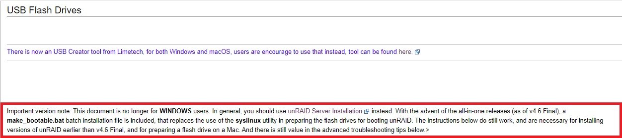

Ha. I'm not being "critical"; because again...you were the only one, to hang in there with me. But...that information; could have helped me, a lot sooner...lol.
Pretty "weird". That blurb clearly says "no longer for Windows"! And don't use that...use this🙄

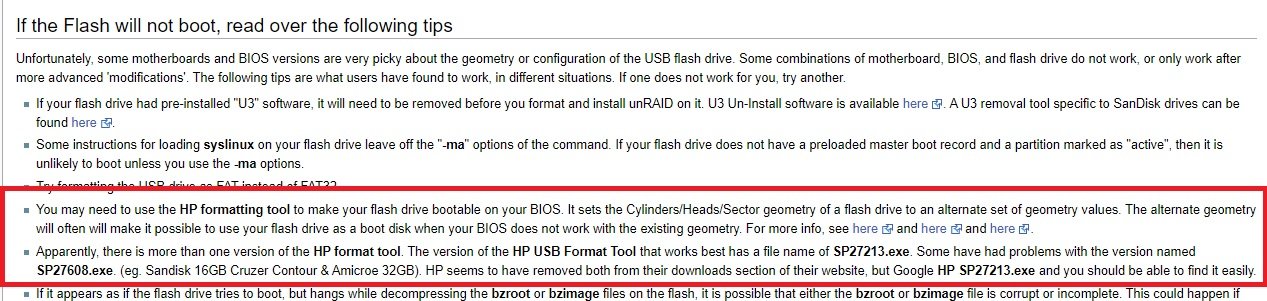

So...first I tried formatting, with the HP sp27213 tool that was mentioned. That kept saying the drive was write-protected; even though it wasn't. Then I did a "regular" format; copied over my files. Ran the make-bootable batch. I was able to get my HP to boot, to new drive.
Then I took it to my unR box. Kept getting this "error 5", when I tried to re-register. Had to Google this...
