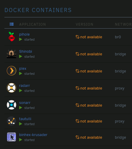

I did a rebuild on the disk and now my dockers versions say "not available" but the dockers are running and the webiu is accessible.  I've restarted docker service, restarted the system, and checked for updates. However, when I checked for updates, it just stalls and never finishes.
edit: 1 hour later, the Shinobi and radarr containers changed to "not available"

I assume the original "disk disabled" problem is resolved and now your only issue is docker connectivity?
So is this just cosmetic?

My guess is that the above errors are generated due to a lack of internet access and are directly related to the docker updates showing as not available. With that in mind, I'd start with some basic network troubleshooting. Try to rule out one hardware component at a time such as the ethernet cable, NIC, (maybe SSD that houses Docker but I doubt it). Then move to software settings such as unRaid network settings, docker configuration, CA auto update applications settings etc. If you haven't already, you should enable syslog server just in case and always include your latest diagnostics... On a final note, if your original issue of 'disk disabled' is resolved you may want to either change the title to better reflect the current problem or start a new thread. A disabled disk is pretty basic whereas docker connectivity is a whole different specialty.

yeah, I redid all the network paths and everything was back. Not sure how it broke in the first place tho! thanks for the help
