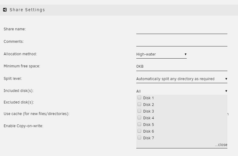

Hello, I installed a new hard drive to my unraid as a data drive (not as another parity). It detected in system and mounted. But yet when I check my total space on the shares it is still 23.6tb (should be roughly 31tb with new 8tb drive added). I checked that my share's "include all disks" but it only lists the original 7 data disks (8 including my orig 8tb parity drive), not the new 9th 8tb drive.. suggestions?  (it has completed parity syncs/ data rebuild, but seems I am doing it again because I tried doing a "new config")

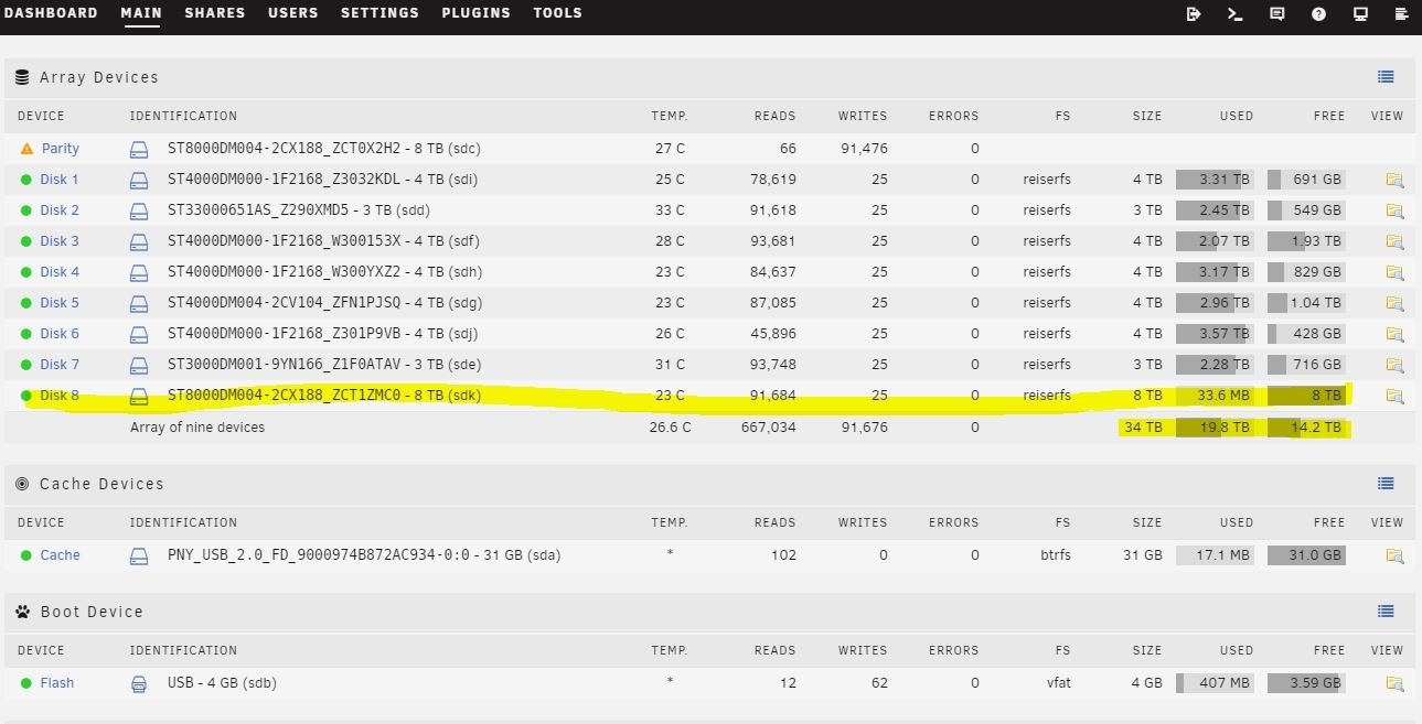

Seems like both my cache (just a flash drive) and my new hard drive are detected but not used..

Where exactly are you looking that makes you think the shares don't have enough space? The screenshot you gave doesn't have anything to do with your shares, and the total storage displayed there is the correct sum of all data disks in the array.

Go to:
Settings -> Global Share settings -> Included disks
And unselect all disks, or also select disk8, but first option recommended.
1 minute ago, johnnie.black said:
Go to:
Yes, that is it exactly. Currently you don't allow disk 8 for any user shares.
Best to not select any disks so it will allow all.
