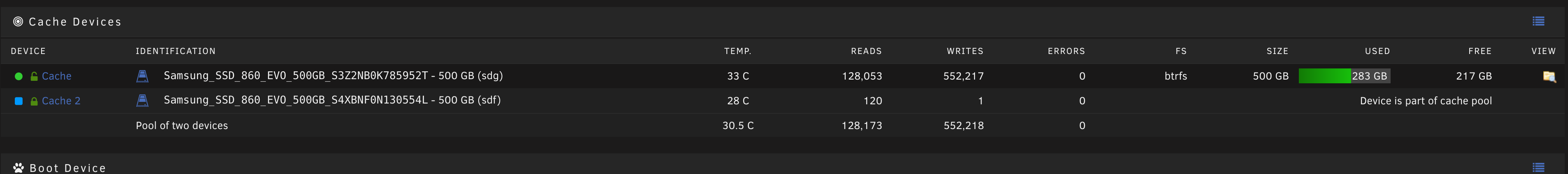

I have recently bought a new 500 GB SSD in order to create a cache pool with my existing encrypted btrfs 500 GB SSD cache device I installed a while back.
What I have basically done is to shut down the server, installed the drive, start the server and lastly followed this guide:
The thing is that I don't think it started to balance the drives when I started the server. I had to trigger a full balance manually and after balancing I'm not sure if the pool is working or not. See attachment for screenshot. As you can see, it still have "new drive" status and have basically no writes to it. I also SSH to the machine and ran "btrfs filesystem show" with the following output:
Label: none  uuid: fd9abfd5-7e13-487f-ba5d-419b90608d6b
        Total devices 1 FS bytes used 263.25GiB
        devid    1 size 465.76GiB used 264.03GiB path /dev/mapper/sdg1
Label: none  uuid: bf870768-3cdb-4f9e-836b-4b1ed2c4c253
        Total devices 1 FS bytes used 384.00KiB
        devid    1 size 238.47GiB used 1.02GiB path /dev/sdk1
Label: none  uuid: e15f3b51-09b3-4cab-bbee-13670824960d
        Total devices 1 FS bytes used 10.86GiB
        devid    1 size 30.00GiB used 20.02GiB path /dev/loop2
How can I test or otherwise verify the pool is working? If not, how can I fix it?
Edited by walle
Cache2, is not part of the pool, please post the diagnostics: Tools -> Diagnostics
I don't see why on the syslog, but for some reason the second device wasn't added to the pool, it should be if you try again, just make sure cache backups are up date in case something goes wrong, then:
stop array
unassign cache2
start array
stop array
re-assign cache2
start array and hopefully it will work now.

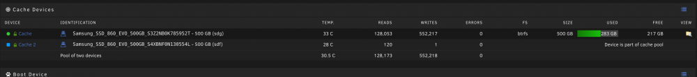

The balance operation is done, and I think this looks like that everything is in working order (correct me if I'm wrong):
        Total devices 2 FS bytes used 262.61GiB
        devid    1 size 465.76GiB used 293.03GiB path /dev/mapper/sdg1
        devid    2 size 465.75GiB used 293.03GiB path /dev/mapper/sdf1
        Total devices 1 FS bytes used 10.89GiB
Thank you for your help @johnnie.black!
Yes, looks fine.
