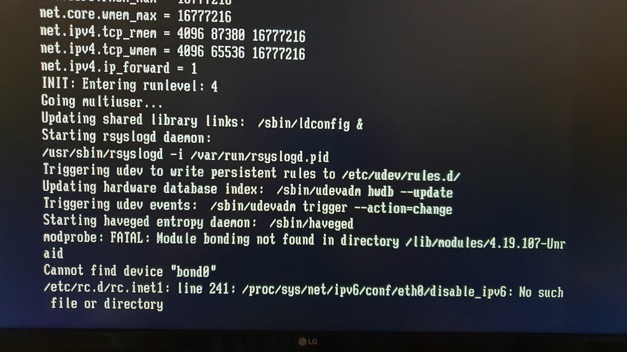

6. The whole UNRAID is unresponsive, forcing me to restart the server.... now UNRAID refuse to boot! It says "...waiting for /dev/disk/by-label/UNRAID (will check for 30 sec) at boot up..." and "cannot find device Bond0" and the whole gui refuse to start.... (see attachment)...
I just can't imagine UNRAID releasing so unstable release and it actually kills hardware without a possibility to fix it. This experience has really leave a bad impression, even if I rebuild the whole things (which will take days), I don't know if I can trust the solution again....

Your issue with booting looks to be a problem with the USB stick.
  • Are you able to plug it into another (Windows) computer and run a disk check?
  • Is your stick USB 3.0 or 2.0? Are you using USB 3.0 or 2.0 port on your motherboard for the stick?
Corrupt / failing USB sticks are known to cause inexplicable issues e.g. hanging VM etc.
Your corrupt drive last time and this time could just be due to a forced reboot while data is being written, leading to corrupt data.
Are you able to plug it into another (Windows) computer and run a disk check? - I can try, it is booting but then failed to load the necessary stuff to load the UNRAID GUI...
Is your stick USB 3.0 or 2.0? Are you using USB 3.0 or 2.0 port on your motherboard for the stick? USB3.0, it has been working perfectly before the upgrade, no issue whatsoever... it worked for 1-2 days after the upgrade, so I am not sure what has changed since the last time, other than it crapped itself... but too many coincidences, first drive failure then USB drive failure after 1-2 days, after upgrading to 6.8.3... all point out to 6.8.3 version that create unstable environment somehow and then all these issues....
-NOTE: The login screen works, I can enter my root password and get in, but the Mozilla GUI is saying Unable to connect (the address here is localhost)
One thing that really painful here is not only I have issue with the array (and VMs) but I have issue with the USB drive itself after the upgrade, the devs should build an automatic roll back feature inside the GUI/through the boot prompt similar to what Windows have (albeit that one only occasionally work)....

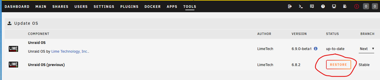

Already exists:
EDIT:  You can do the same thing manually by copying the contents of the previous folder on the flash drive back to the root of that flash drive.
Edited by Frank1940
I wish I can do that through the Web GUI, it doesn't work currently (can't connect to the GUI). Is there a way to do it through command prompt?

If you did the Upgrade from the GUI, it is in the previous folder/directory found on the Flash Drive.  (As a part of the upgrade process, the folder is created and the necessary files for restoragation are copied there before installing the new files in their place.)

When you do this, be sure you do a    chkdsk     on the flash drive before copying any files!  With problems like you first described, this is always a good idea.  (Plus, USB3 and Unraid have a checkered history.  Some MB's and BIOS seem to have problems while others work fine...)
I managed to do a chkdsk and fixed the error -> Try to reboot my server again, didn't work
I then copied the previous folder to the main/root folder -> Still doesn't work, the localhost still refuse to connect and display the GUI
But I managed to do a diagnostic (now attached), any help would be appreciated!
Note: I am unsure why the date is showing Feb 15? I can only tell that's the latest diagnostic file that I did....
