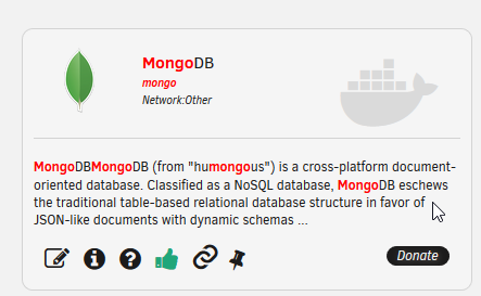

1. Install MongoDB from the CA Tab.
2. Look if it is already running and note the IP and the port!

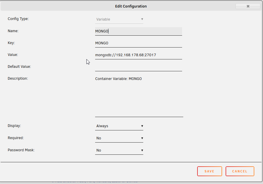

9.2 Choose Path and fill in like this. The IP Adress of the Value from Step 2. and save it

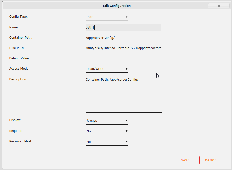

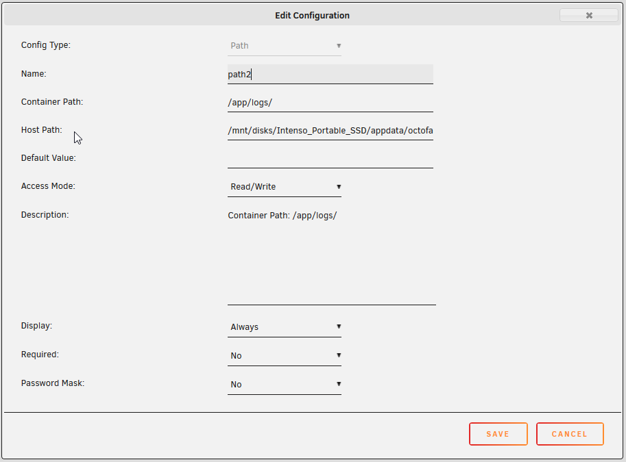

9.3 Add this two paths. The Hostpaths should point to a octofarm folder in your appdata

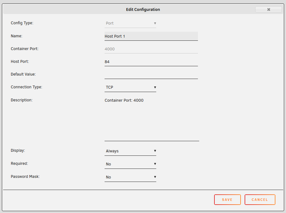

9.4 Add a Port. Remember the Step 8

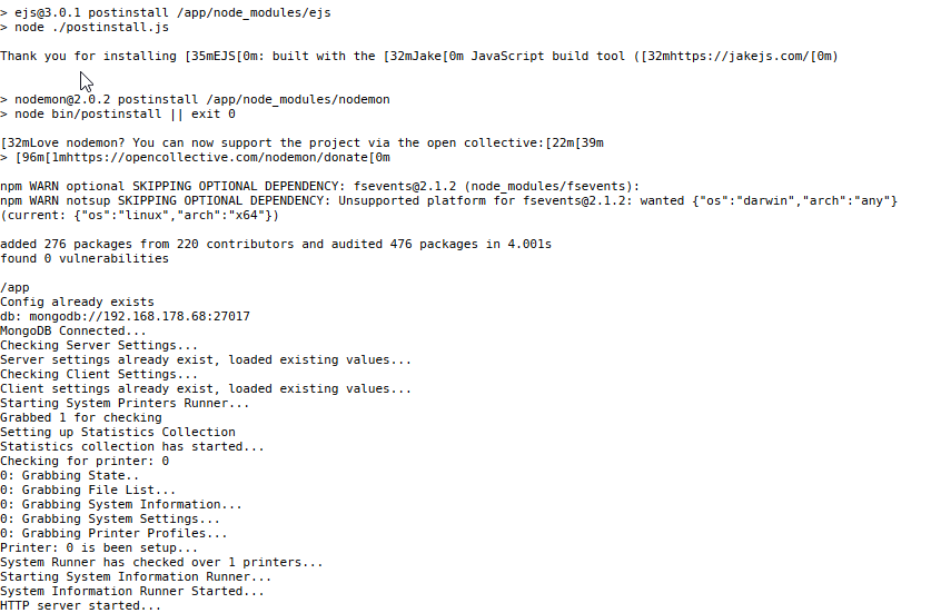

10. Press Apply. After that you can check the log if everthing went OK. Press this Button. grafik.png.f85dfb0792d3784772d65d56e31bb35d.png
It should look like this
