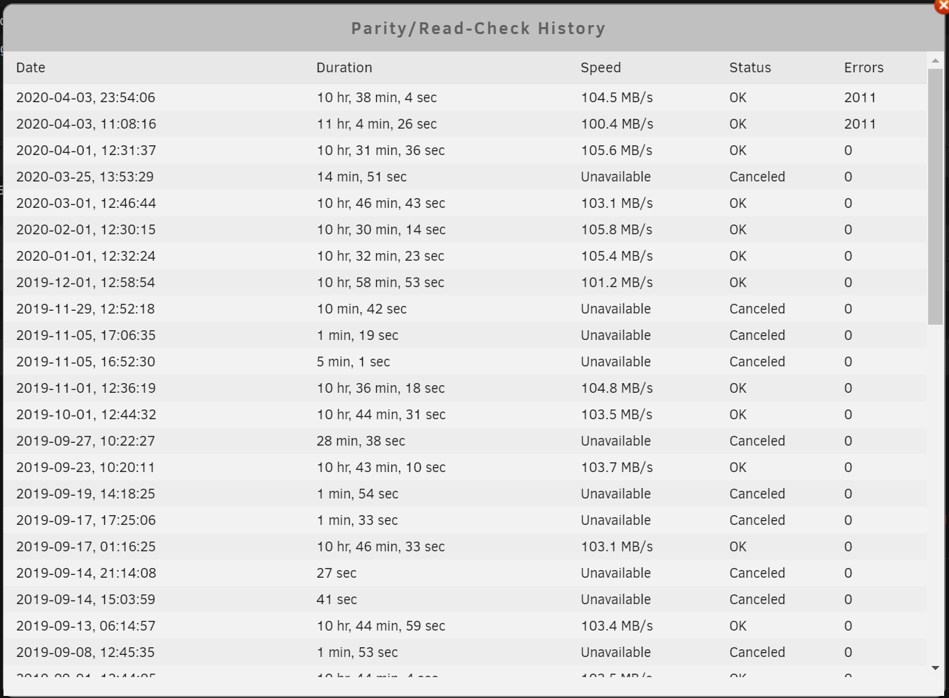

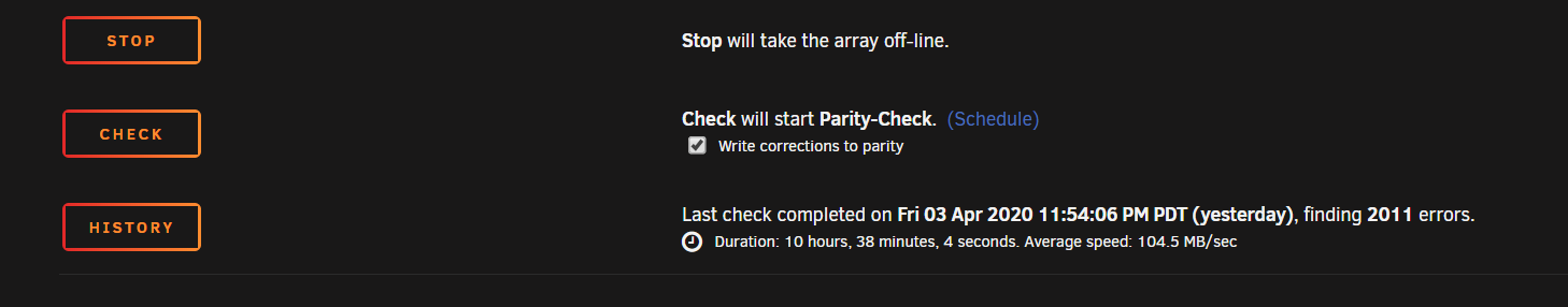

so two days ago my power went out for a few hours and when it came back on, i was at work and unraid automatically booted back up and did a new parity check, when the check was done it said i had 2011 errors, i thought maybe it was writing to the parity when the power outage happened so i cleared all logs and did another parity sync.. sadly im still getting 2011 errors... can anyone help me identify what is causing this? bad parity drive? any help would be awesome, i attached the diag.

then why are the errors still showing? sorry if im not making sense of this, but maybe i worded things wrong? the errors are still there same amount as the unclean check [2011] errors
Edited by Lassley7
First check detected 2011 sync errors.
Second check fixed those 2011 sync errors.
Yes - the second check is reporting how many parity errors it has corrected.   It is a GOOD sign that the number was the same as was reported by the non-correcting check.    You could it your really want to now run another non-correcting check to prove the count is now zero but that is not really necessary.
