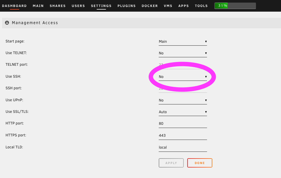

I sometimes need to enable SSH because I use an application called Transmit to connect to my unraid server remotely over SFTP, when I am not on my home network.
Initially, not knowing any better I just left SSH enabled on my server, but the plugin "Fix Common Problems" warned SSH was enabled and the port was getting hit thousands of times. Someone was scanning ports and trying to brute force their way in, I kept seeing "wrong password attempt" in my log file from an IP in China. This also started filling up my cache disk with a massive log file. So I disabled SSH (see attached).
Now I only enable SSH through the unraid GUI when I need to connect with SFTP, and then I disable it afterwards. Is that the proper way to do this or is there a better way to securely connect over SSH/SFTP and not worry about getting bruteforced?
