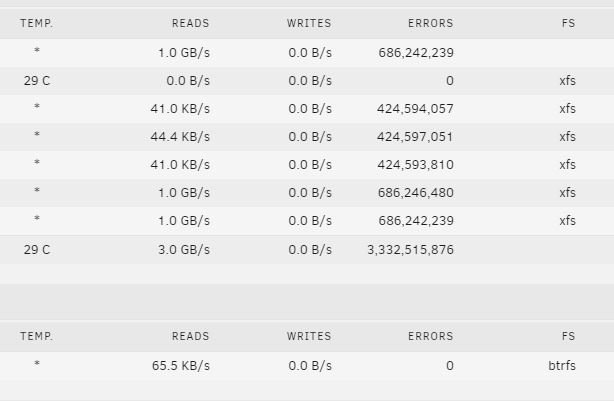

I was having a drive go bad, so I took the old drive out and put the new one in. During the data rebuild it came up with a lot of write errors. The cache drive also seems not to be working. I don't know what I should do. Any ideas would be great. Thanks!
All disks have dropped. Could be connections, could be controller. Shutdown, check all connections, and restart rebuild.

I am pretty sure it needed replacing. It came up multiple times with 5 to 10 disk errors. I will check all of the connections. Thanks.
SATA controller problem, this is fairly common with Ryzen boards, according to a recent report upgrading to v6.9-beta1 which includes a much more recent kernel fixed it.
Ok, I checked all of the connections and they were good. I restarted the machine and all of the disks showed up. I decided to do a parity check. It started off fine and when I woke up this morning, disk 1 wasn't mounted. I am going to upgrade the OS and check in later.

Yeah, It completed just had a lot of errors. I already tried to do 1 parity check but it stopped about half way through with a lot of errors. I went a head and upgraded to the beta OS and started a new parity check. So far so good!
