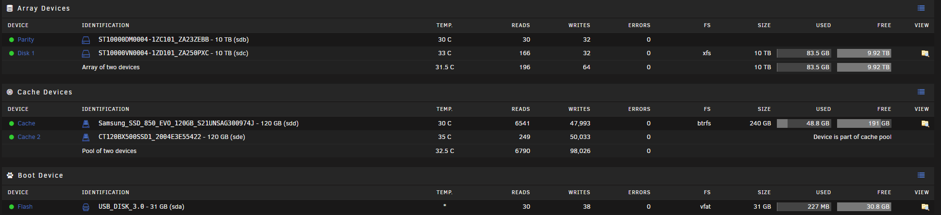

On 4/8/2020 at 2:32 PM, johnnie.black said:
A redundant cache pool, you need at least 2 devices.
On 4/8/2020 at 4:07 PM, trurl said:
That is a good start. It would be enough for me and the way I use cache.
so i added another ssd in a case of hdd failure am i good now or is there still something i need to do ?
It's showing 240GB usable, so it's not a mirror, or screenshot was just after adding it and it's still balancing, if yes wait for balance to finish.
how do i create a mirror? i just added the drive stared the array and made the screenshot
Like mentioned if you just started the array it's balancing, wait for cache activity to stop.
is there a way to see if its done balancing ? it only shows the capacity of the first one and for the secound it just says e Device is part of cache pool
sorry to bother you with so many questions but im a newbie to unraid and thanks again
If it's showing 120GB total space it's done.
