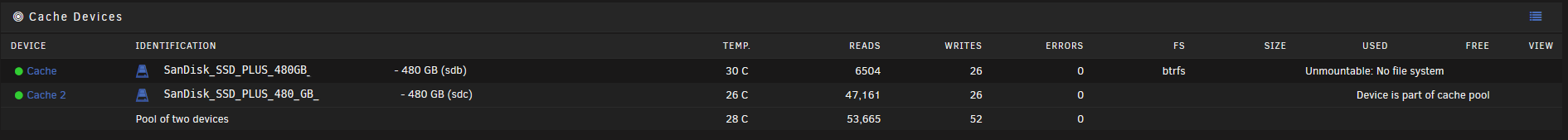

Wondering if anyone can help me with an issue I am having with my Cache pool. Basically after a reboot today, when I started up the array I saw the following:
Along side this I see the below asking me if I want to format the primary cache drive. Now obviously I do not want to as I don't want to loose data.

So at this point I am stumped on what to do to resolve the issue.
I have been able to set the primary cache as no device and then start the array at which point it seems the secondary cache drive is working fine and has all the data I need. However preferably I do not want to run at a reduced redundancy for an extended period of time.
If I am infact being stupid and do need to format the primary cache drive to then make it re-sync the raid I can do that. Any help infact would be very much apprriciated.
Appologies this post is VERY long, I just wanted to make sure that I covered all the options I could find before asking for help.
