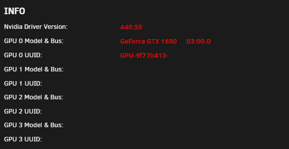

Got the card plugged in and checked the nvidia plugin settings and its detected.

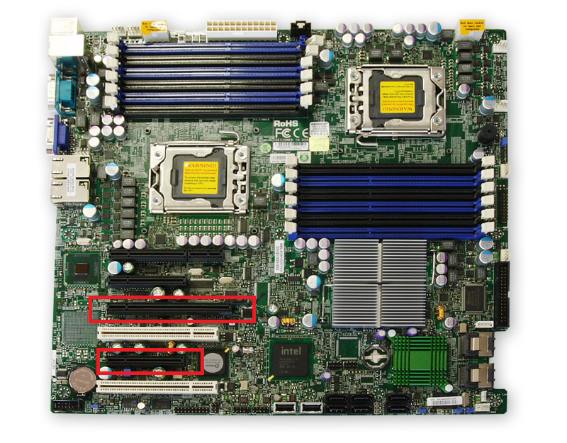

GPU is the first larger red box and the LSI card for my backplane in the bottom. I am assuming this is correct.

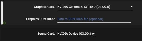

The only issue I have now is I cant RDP to my Win10 VM, I changed the setting for Graphics card from VNC to NVIDIA GeForce GTX1650 but I cannot connect to the VM using RDP do I need to add ROM BIOS or do I need to get dummy HDMI dongle as nothing is plugged into the card?
Followed SI video on YT for Plex set up and confirmed transcoding working correctly.
Looks like I can't do both at same time.
