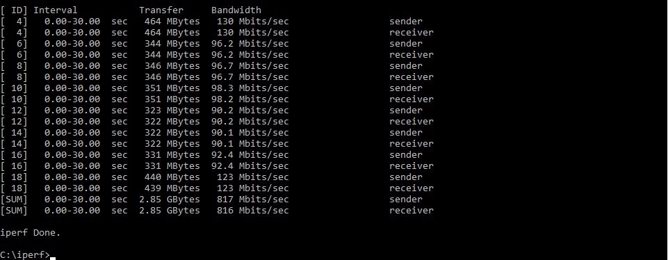

Here are the iperf results from my Windows 10 PC to UnRaid. I set iperf up in server mode on UnRaid and set my Windows 10 PC as the client. I ran it for 30 seconds with 8 streams. There was a total of 2.85GB transfered at  817Mbps. So my network can handle 100MB/s transfers.

with 8 streams.
Test should be run with a single stream.

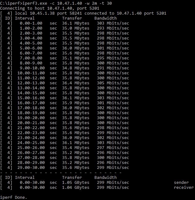

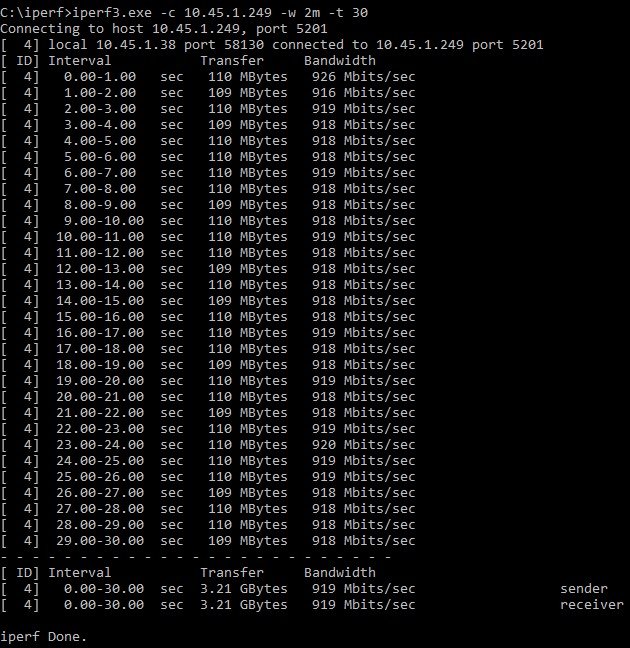

And that'll do it....So from my main PC to my secondary PC I'm getting 919Mb/s on a single stream. From my main PC to UnRaid I'm getting 299Mb/s. So my network connection to my UnRaid server is basically capped at 40MB/s on a single stream. Should I open a new topic for that or can I ask here, why is my network connection to my UnRaid server capping at 299Mb/s?

I never did get that PCIe gigabit adapter but I did state I'd come back with any changes. Turns out my issue was a failing hard drive and not network related. I don't know why iperf showed 300mbps on single stream tests. I have read the only way to saturate a 1G connection with iperf was to do multi streams though. I don't know much about it so I'm not even going to sit here and pretend. That's just what I read. Either or, I continued to see transfer speeds of 30-40MB after I left back in April with 40MB being the peak and the average being between 30-35MB (obviously, since I hadn't changed anything in the server). That started to slow down to around the 20-25MB range. And then one day I could no longer stream a 4K movie smoothly from the server when I had streamed it many times before. It would play the first 10-20 seconds and start to buffer for minutes before playing another 10-20 seconds. I poked around. Ran some tests. Out of the 6 2TB data drives I was only using roughly 2.75TB with the first 2 drives having 1TB of data each and the 3rd drive having .75TB of the data. The first data drive showed over 200 in the relocated sectors count. So I ran a SMART test. It failed at 33% with read errors. Moved all of the data off drive 1 to drive 4. Pulled the drive (have not replaced it yet due to financial hardships caused by this pandemic). Now when I transfer to the server I hit ~60MB peak and average around 52-54MB. I'm happy with 50-60MB/s. A lot better and faster than 30MB/s. That's all I wanted to being with since I saw many people stating they could achieve 60MB/s. Stupid failing hard drive....
