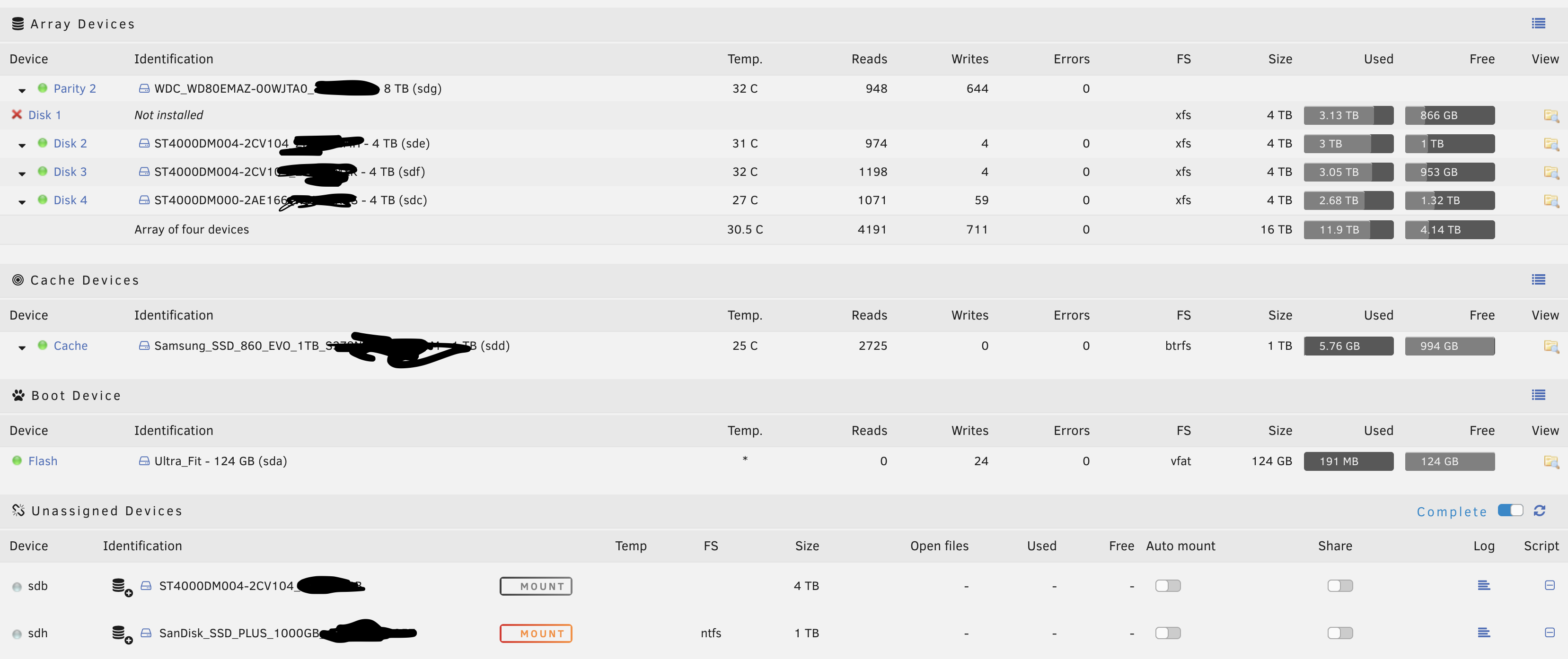

ok, so i removed parity 1 which was the original 4tb parity drive. Array is back up with just the 8tb as parity 2 and disk 1 does show as missing with its contents now being emulated. Verified they are also actually available by accessing the files on that drive.  The question is how do i now use the old parity 1 drive to replace the missing 4tb disk 1 drive without losing content.

  1.  Stop the array
  2. assign the old 4TB in place of disk1
  3. start the array and UnRAID will start rebuilding disk1 by writing the contents of the emulated disk to the physical drive,
