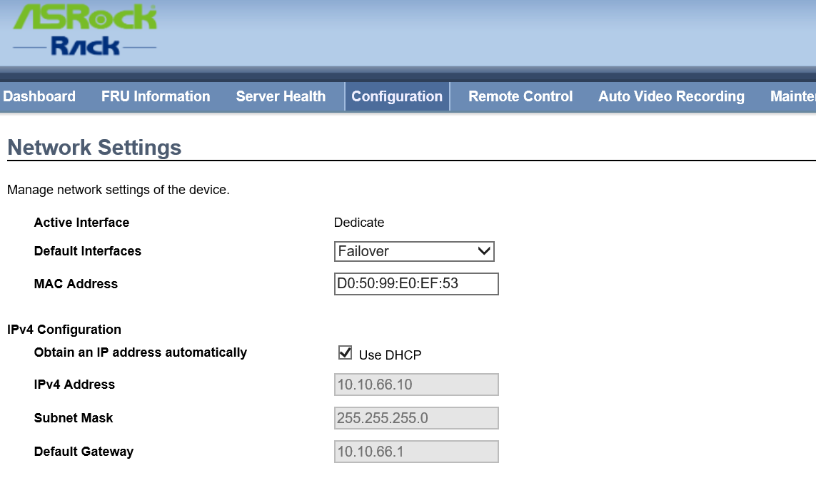

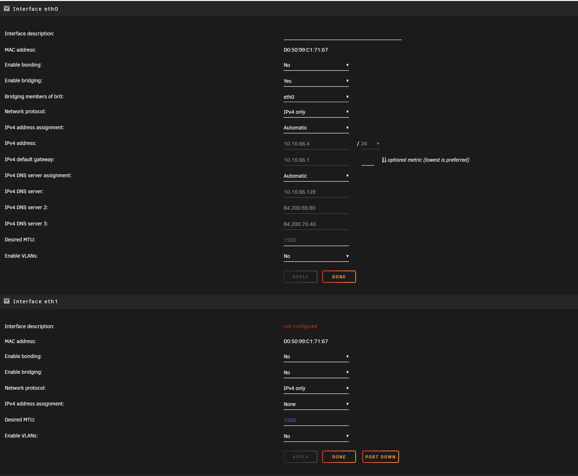

Replaced Flash disk just in case. Boots fine after I deleted network.cfg, rebooted and it stays. IP assigned from DHCP then I turn off Bonding and it drops I can no longer contact server.

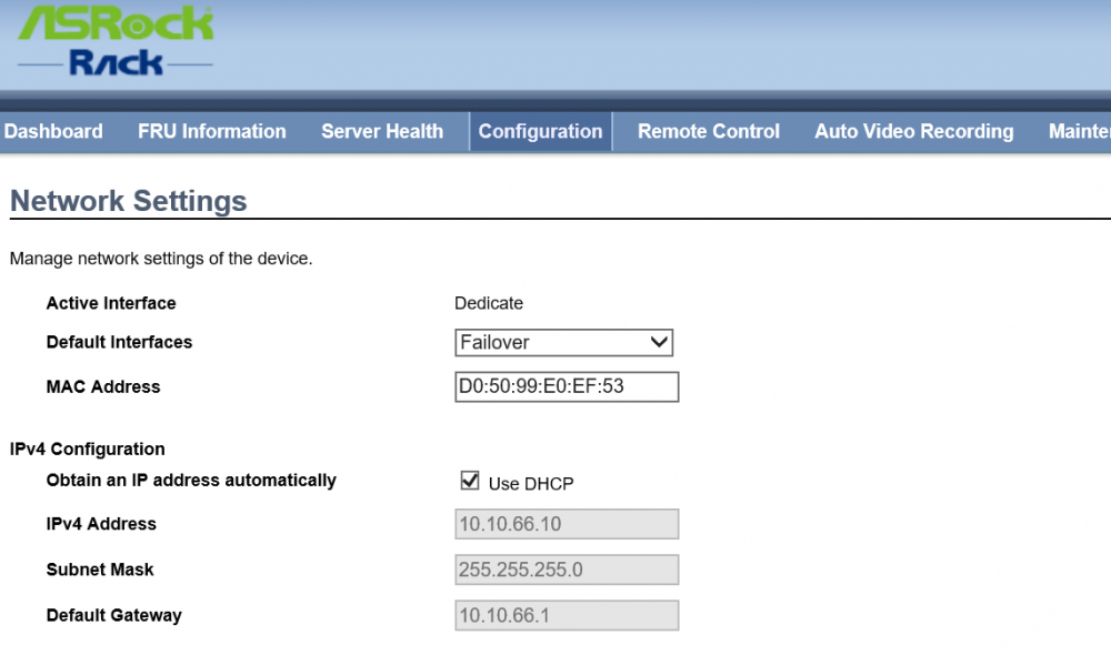

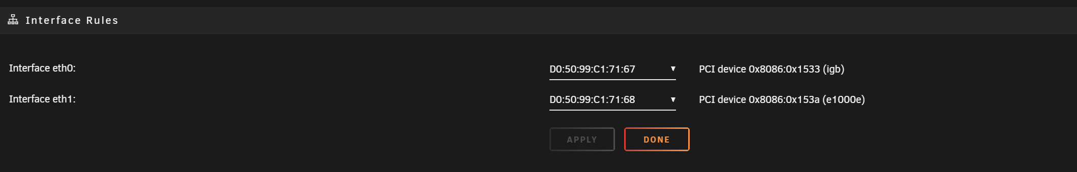

I restart Network service via IPMI, can get back on box. What I have noticed now is both my eth0 and eth1 have the same MAC Address? See below, last image is what my MAC should be for IPMI nic.

Same users have issues getting a DHCP address with latest release, try setting a static address.
As easy as that.. :). Working fine now after a reboot, guess I can just keep it static anyways. Thanks to Squid and Johnnie for the help here.
