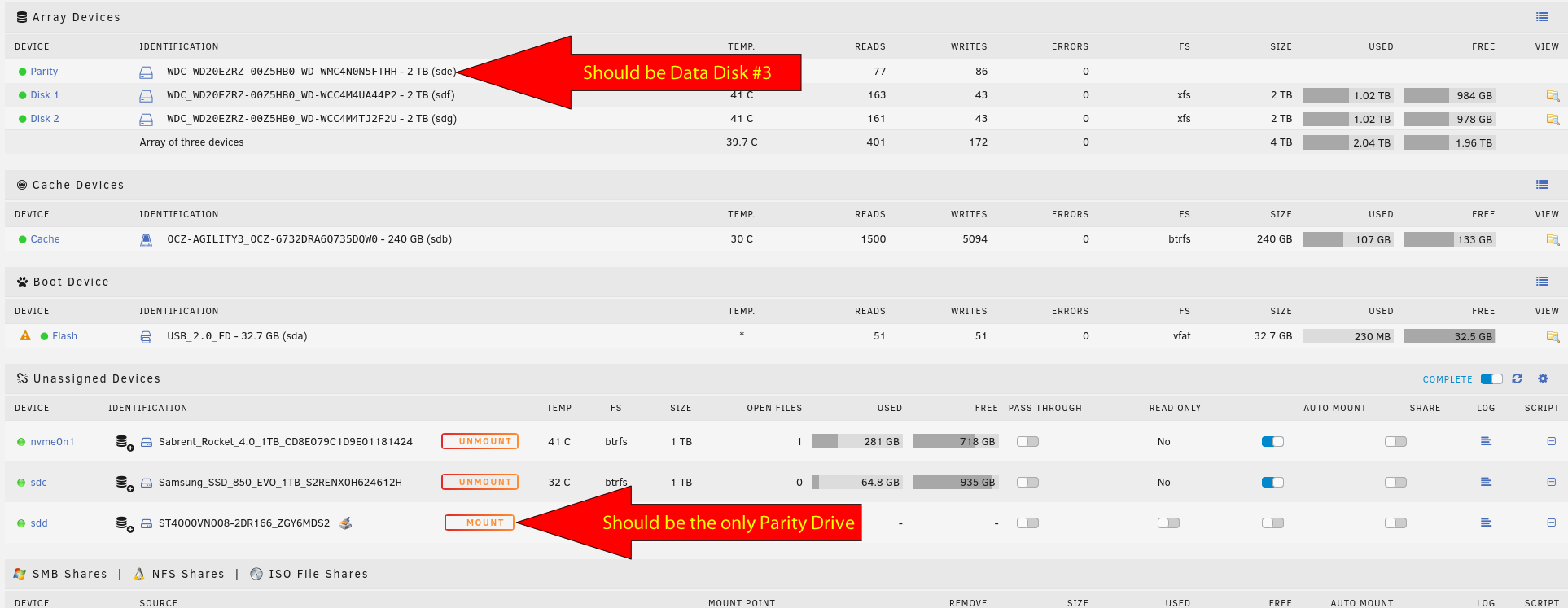

I recently had a issue where my Unraid USB lost my configuration. I suspect that the USB drive is going bad and needs to be swapped out. To get myself back up and running (unraid acts as my main workstation VM), I copied the config from a backup I created about a month ago. This got the server back "online", however I have since changed the disk configuration by adding a new 4TB Parity drive and reusing one of the older smaller drives as just a data disk.
The problem is that I can not tell Unraid to use the correct Parity drive (error is wrong disk). The other issue is that the Array has now wrote minimal changes to this data disk it now thinks is the parity drive due to the old config being used. I assume that IF I can get Unraid to accept what should be the correct Parity drive and Data Disk#3, a rebuild of the Array should correct any data that has been written to that drive. (attached is a image to help visualize the problem).

Not necessarily since there were also writes to other data disks that made old parity out of sync, still a filesystem check might be enough to recover the old or a rebuilt disk, in any case you need to do a new config first:
-Tools -> New Config -> Retain current configuration: All -> Apply
-Assign correct parity drive in place of current disk3
-Leave the array like that for now, don't start it.
Now before re-assigning old disk3 you want to make sure it's still mounting, see if it mounts with UD (use read-only option) then post results so we can decide best course of action.
