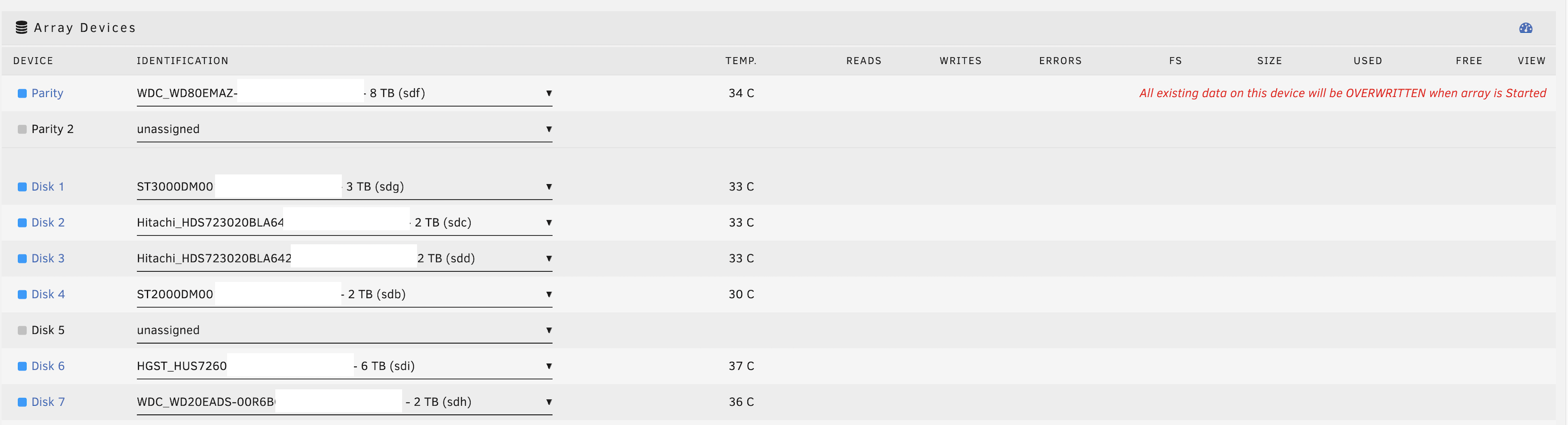

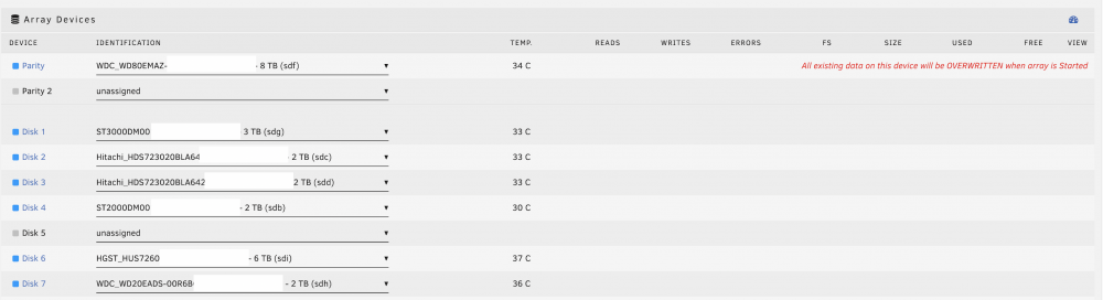

So, I know this has been covered 1000s of times all over the web. It's just that there are a few scenarios/options out there and want to make sure I understand them.
** The Set up **
- 8 disks in the array.
- 1 parity, 7 data.
- As well as few empty bay slots.
- Disk 5 started throwing errors.
** Option 1: Shrink Array - Less safe**
Rather than replacing disk 5, Just shrink the array to 6 Data disks and 1 Parity.
- Stop the array
- Select Disk 5 as "unassigned" under the "Main" tab
- Start the array
- Stop the array
- Tools > New Config > "Preserve current assignments: ALL" > Apply
- Main > Start array.
- **(One worrisome thing I see is that next to the parity drive; it says "All existing data on this device will be OVERWRITTEN when array is Started").
- ** I'm assuming it means JUST the parity drive? Because to make the new array it has to redo the parity right? But no data on the array will be lost? Right?
- Completed after rebuild.
** Option 1: Pros and Cons **
- Pro: It's fast and easy.
- Con: It leaves your array venerable during the rebuild process. And since the rebuild process is more taxing than normal; another drive may fail.
** Option 2: Failing Drive - Shrink - More safe **
- Use something like unBALANCE to move data off disk 5 to the other drives.
- Then follow steps in Option 1.
** Option 2: Pros and Cons **
- Pro: Doesn't leave it unprotected like Option 1.
- Con: Takes a bit longer to transfer the files off. Esp if the drive is failing and has really shitty speeds... (My situation).
Does this all sound about right? I'm currently about to start the array again. But seeing the "All existing data on this device will be OVERWRITTEN when array is Started" Warning scares me. So just want to double check.
**EDIT** Or should I stick Disk 5 back in and do something else? I did start to use unBALANCE, but the speeds would drop too slow and i would have to cancel it. I also then got some "Duplicated file errors" from the "Fix Common Problems" plug in even though i was using "move" and not "Copy" in unBALANCE... But figured that would go away once disk 5 was out of the picture. No?
-Thanks,
Edited by Maximus01701
Added additional info.

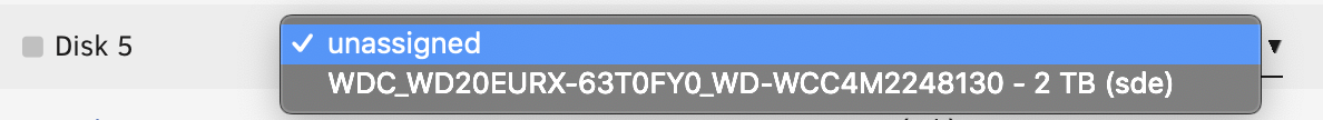

Is this the disk that was previously assigned as disk5: WD-WCC4M2248130 ? That disk looks OK.
Yes, that was/is Disk 5.

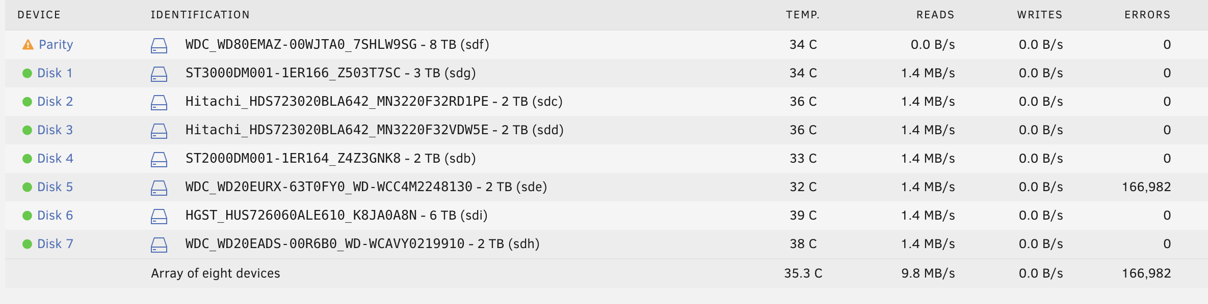

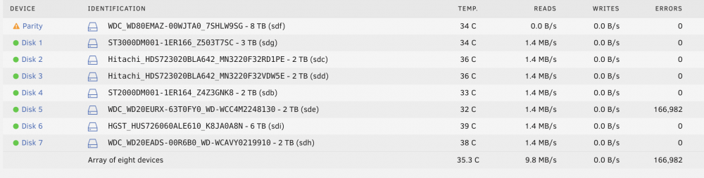

And there it goes... tossing errors and slowing everything down.
If i restart the server, i can almost guarantee the speeds will go back up for a bit, then back down.
fs02-diagnostics-20200426-1537.zip
Disk still looks fine. Are you sure you did this?
1 hour ago, trurl said:
double check all connections
Both ends, power and SATA, including any power splitters. Change cable if you have another. The connector must rest squarely on the connector on the disk, with no tension on the cable which might make it otherwise. Also, if you are bundling your SATA cables, don't.
I just swapped the SATA cable.. it's coming back up online now.
