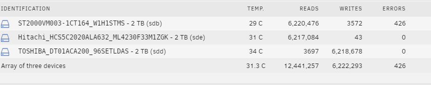

Hi all,
Upgraded a 1tb drive in my array to 2tb and it started the rebuild, now I have around 400 errors on my parity drive.
I know I need to replace the drive asap, but would some data be corrupted?
I have attached my diagnostics.
Cheers

Hi all,
How do I replace the parity drive? Do i need to do a parity check before replacing it?
Any help would be appreciated

Just stop the array, assign the new parity drive in place of the old one and restart the array to build parity onto the new drive.    No point in doing a parity check as you are about to discard the current contents.

Rebuilt disk will likely have some corrupt data, unless by chance the read errors on parity coincided with empty sectors on disk2, if you still have the old disk use it to re-sync with a new parity then upgrade again.

if the original 1TB drive is still intact then it might be best to assume the rebuilt drive2 has nothing useful on it?   You can check if the 1TB drive mounts under Unassigned devices and appears to contain the expected data..    In which case the thing to do will be to get the array back into a useable state with valid parity and then reformat disk2 to set it back to empty and copy the data from the 1TB drive.

-Tools -> New Config -> Retain current configuration: All -> Apply
-Assign old disk2 as disk2
-Assign new parity
-Start array to begin parity sync
Note: Any data written to disk2 after the upgrade will be lost

Right sorry I am very new with Unraid, please bare with me.  So I would assign the old 1TB drive replacing the new 2TB drive that I put in yesterday. Assign the new parity drive and let the parity sync to the new parity drive.  Then when that is done, I could replace the 1TB with the new 2TB in the array?  Is that right?
5 minutes ago, Theldron said:
Is that right?
Yep.

No, power down, disconnect old parity and new disk2, connect new parity and old disk2, array won't start because some disks will be missing, ignore, follow steps above.

So the new 2TB (current disk2) i have has already been precleared and confirmed OK. Could I reuse that after I pull it as the new parity drive and use the 1TB in the array until my new 2TB comes and then replace that for the 1TB drive?
Yes.
Everything seems to be working perfectly, the parity is rebuilding. Thanks for all your help.
