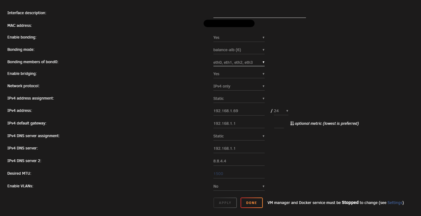

Hey guys not sure why but ive changed the bridge method for eth0 to the following (see pic below) but since doing so it has broken the network on the VMs. previously the VMs were set to virbr0 but the VMs cannot find the network anymore, i've change it to br0 but still nogo, I dont have any other network options in the VM config.

so here is my current network.cfg
# Generated settings:
IFNAME[0]="br0"
DHCP_KEEPRESOLV="yes"
DNS_SERVER1="192.168.1.1"
DNS_SERVER2="8.8.4.4"
DHCP6_KEEPRESOLV="no"
BONDNAME[0]="bond0"
BONDNICS[0]="eth0 eth1 eth2 eth3"
BONDING_MODE[0]="6"
BONDING_MIIMON[0]="100"
BRNAME[0]="br0"
BRNICS[0]="bond0"
BRSTP[0]="no"
BRFD[0]="0"
PROTOCOL[0]="ipv4"
USE_DHCP[0]="no"
IPADDR[0]="192.168.1.69"
NETMASK[0]="255.255.255.0"
GATEWAY[0]="192.168.1.1"
USE_DHCP6[0]="yes"
IFNAME[1]="br4"
BRNAME[1]="br4"
BRSTP[1]="no"
BRFD[1]="0"
BRNICS[1]="eth4"
PROTOCOL[1]="ipv4"
USE_DHCP[1]="yes"
SYSNICS="2"

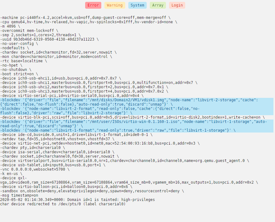

no error in the VM logs

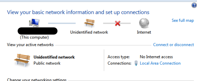

it just dont want to connect, even with a static IP
been messing with it all day today.. still zero success. any recommendations?

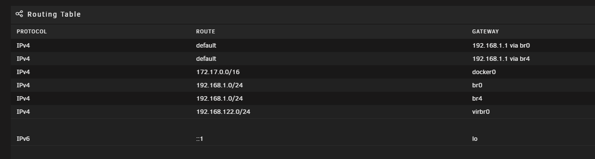

virbr0 is a virtual network created by libvirt (VM manager) and has nothing to do with network settings.
Please provide diagnostics.
Your diagnostics show virbr0 is present.
virbr0: flags=4099<UP,BROADCAST,MULTICAST>  mtu 1500

Try to re-assign the interface in your VMs

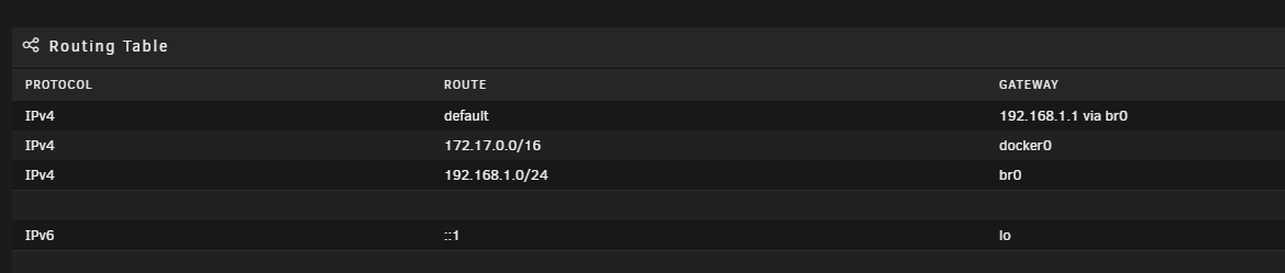

oh wow.. didnt see that. i wonder when i did the Unraid Nvidia  plugin and did the OS upgrade then OS swap to the Nvidia Plugin one if it reinstalled it? this is what i see now under network settings
before virbr0 wasnt there.. see above screenshot. now i need to change it to 192.168.1.0/24 because its not getting any traffic still.
edit:  nope all good. it had the static setting in there from trouble shooting. changed to DHCP and its working we have web again!!
