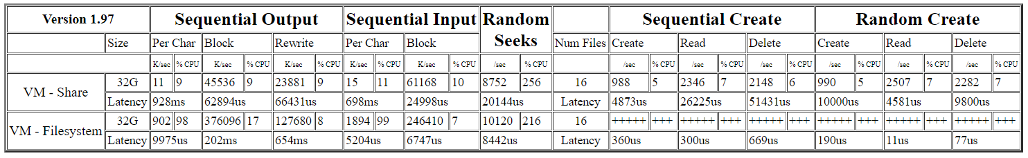

I've done some additional tests and believe my issue doesn't have anything to do with the cache but instead of mounting shares within my VM.
First I tried various other shares and they all ran at approximately the same speed.
Then I made a copy of my VM disk and moved it within a share that also had the project (on the array) and also set it to mount that same share.
Booted it up and tested compiling from the VM's filesystem - it was snappy as I'd expected.
I then tried compiling from mounted share (which again, is the same share the VM is running on) and it was upwards of 20x slower like all previous tests.
This makes me believe it isn't the cache at all but something with mounting Unraid shares on my VM that's causing the issue.
I've attached the output of bonnie++ on both the local filesystem of the VM as well as the mounted share.
The differences are quite large so something is definitely up with these mounted shares.

What do you mean by "mounting shares"? That field in the VM template where you enter the /mnt/user/share and a mount name and then mount the mountname from within the OS?
If so that's a known issue for quite some time. It is theoretically possible to tune that (according to Red Hat) but nobody has ever managed to do it so performance is terrible.
You would have better performance mounting smb shares instead. The best performance with NVMe is to create custom smb config to access /mnt/cache/share (to by pass shfs).
Alternatively mounting the NVMe with Unassigned Device will also bypass shfs and give you best performance.
