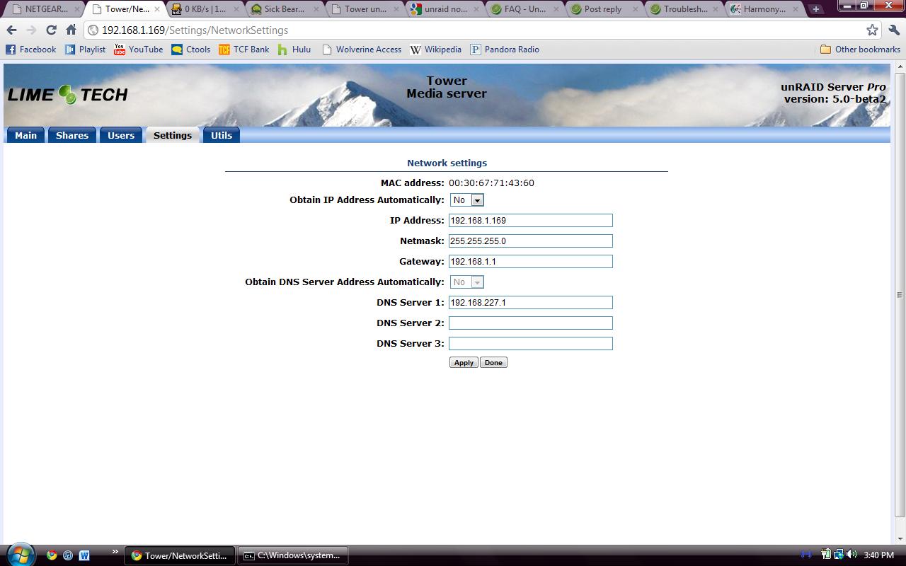

I have the Tower set to a static IP 192.168.1.169, I kind of want it to stay static for the SABnzbd and Sickbeard.
I wonder if your DNS server address is wrong. In my settings page, DNS matches the Gateway. I am also using a static IP.
yep seems DNS is wrong...
should be same as your router or the dns servers ip that your ISP gave you
poor unraid can not resolve the ip addresses he need to access the web :)
