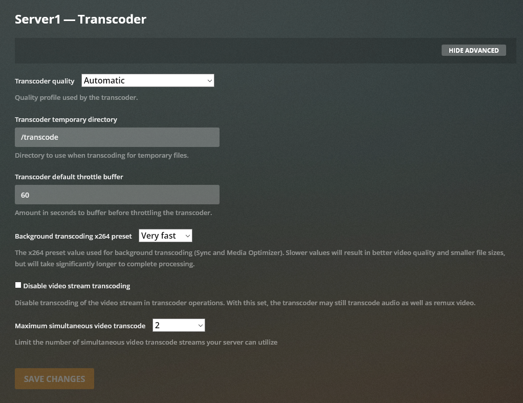

And what do you have for the transcode directory within the plex application? Do you use the plex DVR feature?
Here are the settings.  I haven't touched these since I set up Plex about a year ago.
And no, I don't know anything about Plex DVR.
Edited by tkohhh

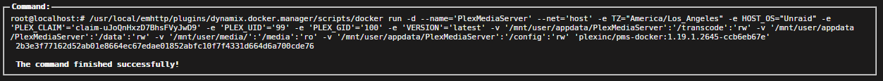

I don't use the plexinc docker, I am using Linuxserver.io plex instead. But your plexinc docker mappings don't make sense to me. Why do you have 3 different container paths mapped to the same host path "/mnt/user/appdata/PlexMediaServer"? I just looked at the plexinc documentation on dockerhub, and your mappings don't seem to conform to those docs either.
What is the purpose of the container path "/data" in your mappings? And wouldn't it make more sense if the "/transcode" container path was mapped to something other than the exact same path "/config" (your plex library) is mapped to so your transcodes aren't just dumped into that same folder with your plex library?
None of that would cause filling docker image problem, but it does make me wonder if you know how to setup dockers.
The reason I picked on NextCloud and Plex is because I am using those myself and have some idea what they are and how to set them up. One of the others you are running may be the cause of your problems but it would take a lot more research for me to figure out what you may have done wrong with those.
Do you understand docker mappings of host paths to container paths? Do you know Linux is case sensitive? Do you know to use absolute and not relative paths to refer to the container paths within the application? Do you know why I'm asking these questions and what their importance is?
