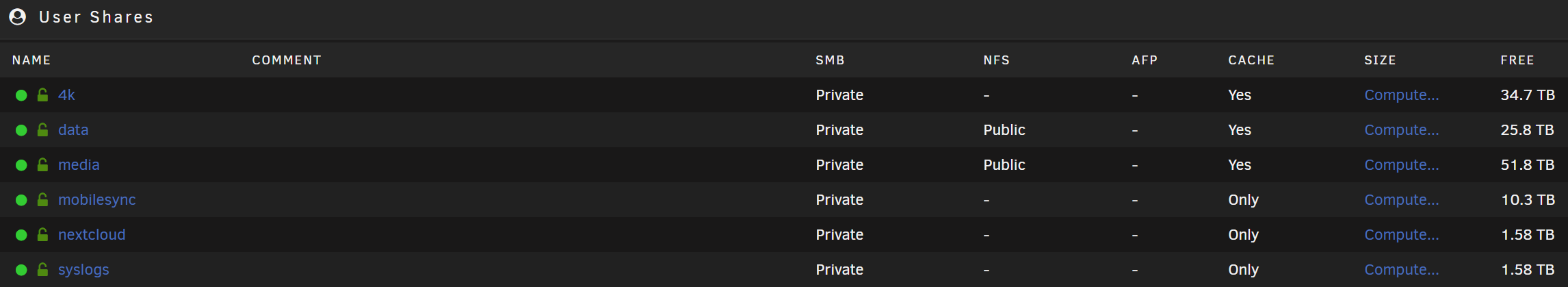

Ok so I see all the extra share cfg files.  Most of those shares don't exist anymore and I've confirmed none of those folders exist on any of my disks.  The only shares I have left are the following:
Furthermore, while those shares were originally created with capital letters, they've all been converted to lower case.  I guess the 'mv' command while changing the directory case does not change the share.cfg file, I'll have to fix that.  The only shares that are set to Use Cache = Yes (meaning they eventually write to the array) are 4k, media, and data.  And on every disk, those top level folders are indeed lower case.  I've also confirmed all my docker templates reference the lower case shares.  I've also just done a test file transfer to each share and every transfer wound up on cache and not on any of the disks.
So if all the top level folders are correct on each of the disks to match the current shares, I'm not sure what could be causing the disk spin ups.
