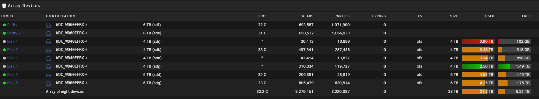

So I use my unraid server for basically docker containers and a backup target.
Below shows my current usage, I have no more physical space in my server to install new drives, and have no additional SATA/SAS ports either.
I want to upgrade all of the drives (with the exception of the cache) to 10tb drives.
How would i go about swapping all of these drives out without data loss?
Any help would be really appreciated.
