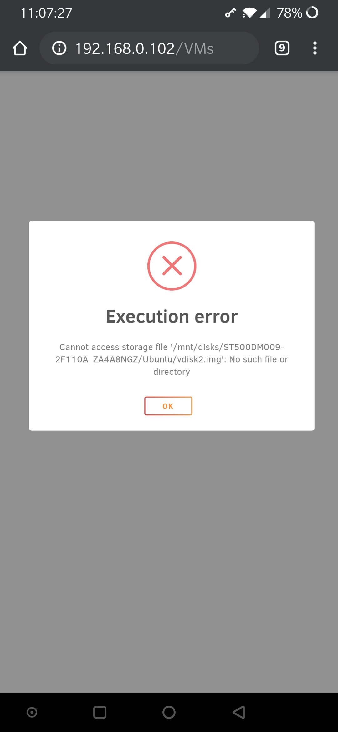

If I try to stay the VM without mounting the disk first I get this error. So where am I going wrong here?
If using a vdisk then the Pass thru option should NOT be checked.    You only use that option when the VM has complete control of the whole physical drive.
Aaahhhhh, I get what you mean now. Thanks for clearing that up!
