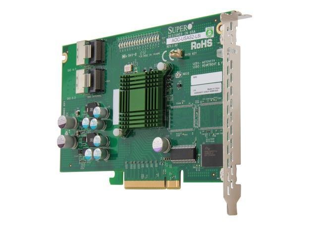

I have a Supermicro X10SRH-CF motherboard. I am setting up a UnRaid Cache Disk using two 2TB Crucial MX500 SSD drives setup as RAID 1. Is the SUPERMICRO AOC-USAS2-L8i card shown below compatible with the UnRaid OS?  The card claims a transfer speed of 6gb/sec. For a lot more money I could buy the Supermicro AOC-S3008L-L8I which claims a transfer speed of 12gb/sec.  Is the UnRaid OS capable of supporting 12gb/sec. transfer speeds? If no, then I will just save my money and buy the card with the 6gb/sec. transfer speed.  If anyone has a recommendation for a better card please share. Any opinions welcome.
That's a RAID controller (though it might be flashable to IT mode) better to use any of the recommended LSI HBAs instead.

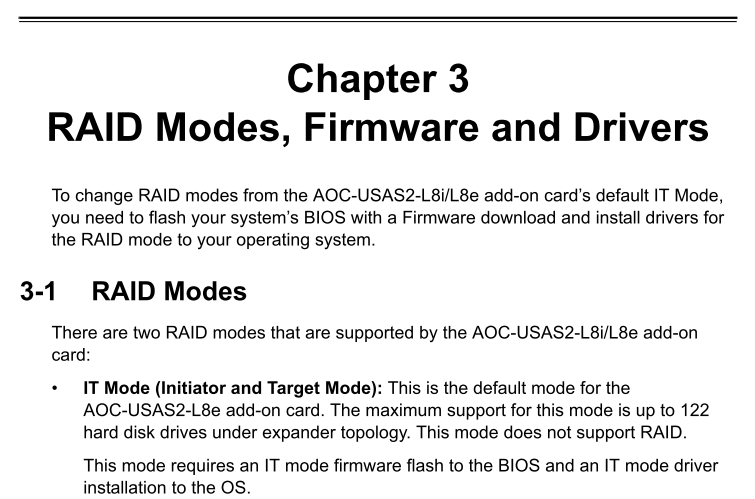

I actually downloaded the manual for the manual for the AOC-USAS2-L8i/L8e and found the following in it:
It appears a bit confusing (at least to me) as to whether it is in the IT Mode out of the box or requires flashing to that mode, but the card spec's definitely indicates that it will work in that mode.
