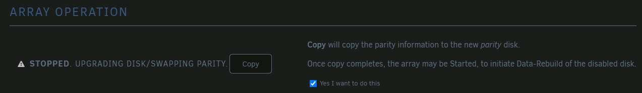

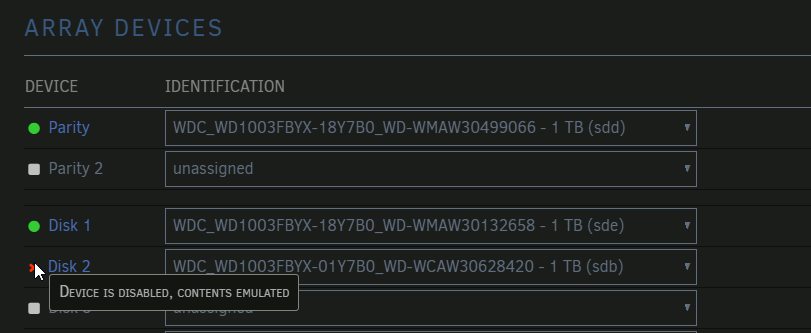

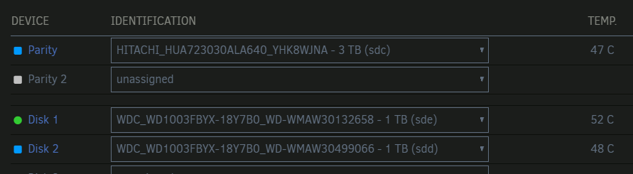

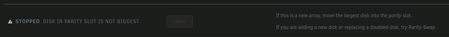

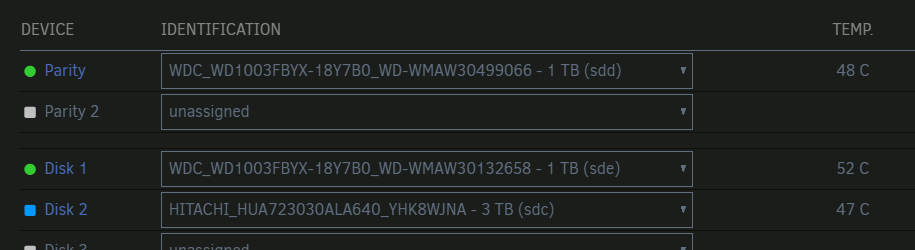

Initial configuration here:
This would be nice
But:
So this is necessary:
However, after it's complete and everything says it's valid, If I attempt to change the disk configuration in any way, it goes back to the original configuration. Rebooting the system also reverts to the original configuration.
That's normal, parity swap procedure needs to be done from start to finish without any assignment changes, if there are any after the copy (or a reboot) it will be reset and you need to start over.

Appreciate the clarification, that makes sense. A warning or tooltip suggesting that would have been nice. It's good to know that's the only problem. I am slightly concerned that after the second copy, I got a green icon on the [new] 3tb parity drive, with the [old] 1tb parity drive in disk 2 saying it's contents were emulated, which is what gave me the confidence to switch assignments without booting up, but that's probably a symptom of having done the procedure twice without starting the array and I doubt many people would experience the same set of conditions that led to that.
