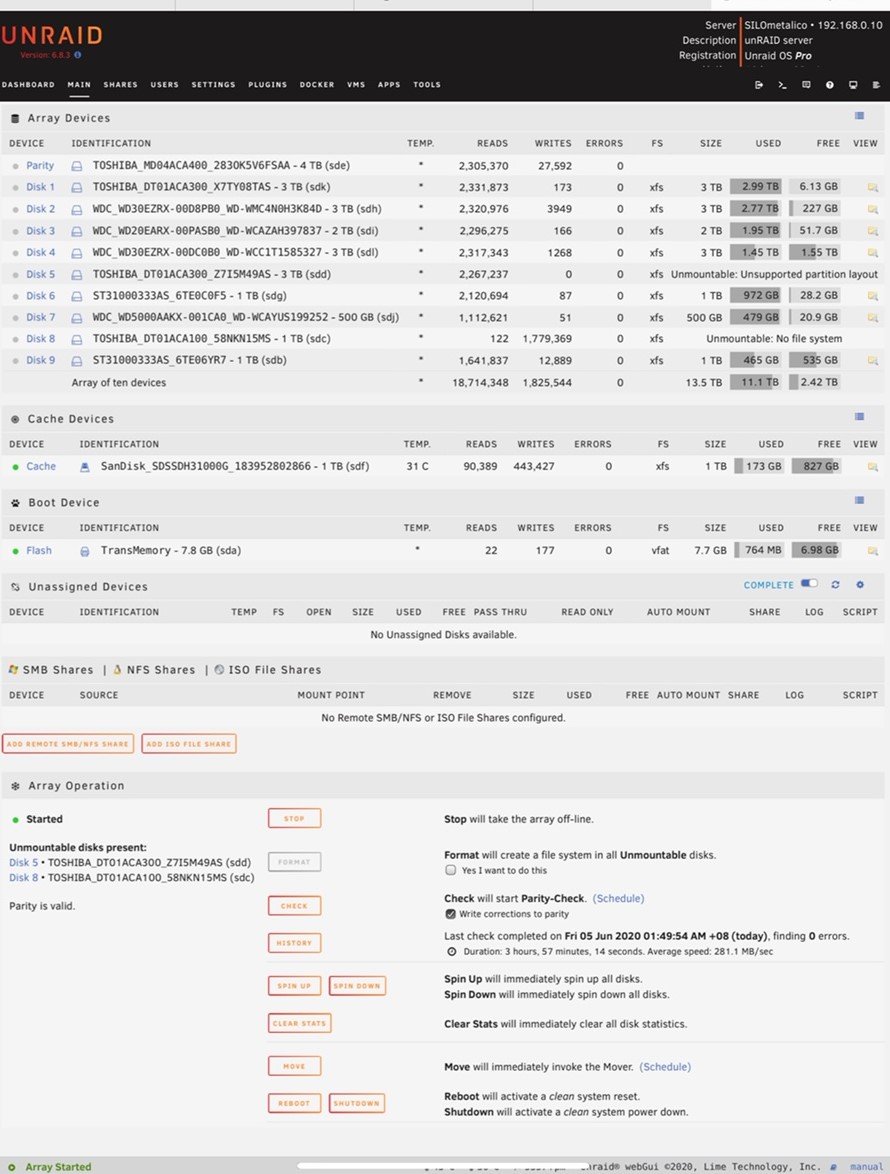

when my array started, another disk (disk 5) suddenly had the "unmountable: unsupported partition layout", but the drive was green. the array started with 2 faulty drives. oh! the horrors....
i had the worst feeling in my bones... array started with 2 missing/bad drives, in my simple mind it means the parity is no longer valid and i won't be able to rebuild the data for disk 8.
anyway while thinking about what to do about disk 5, i started preparing my disk replacement 8. I'm using unassigned devices and unassigned devices plus. I was actually looking for the preclear function but seems to have gone missing. there was some partitions that was on the disk, so i deleted them. but still no preclear. so i thought nevermind that, just this once i will have to replace a drive without preclearing first. i really need to start my server otherwise nothing in my entire house will work. not even internet because pfsense is running as a VM in unraid (having second thoughts about that now).
so at this point i figured i will try getting disk 5 back to normal state. I don't think it is actually faulty. it was fine just earlier. probably a loose connection. if i can get disk 5 back then unraid can rebuild disk 8.
so i shutdown unraid, pulled and replugged disk 5 and started up again, same result.
i shutdown again, pulled and replugged into another drive bay. basically i swapped disk 5 and disk 8 so i'm pretty sure there shouldn't be any issue with the connection. still same result. the array starts as if nothing is wrong, but disk 5 still shows "unmountable: unsupported partition layout" and disk 8 is not installed.
i went to maintenance mode, tried running the check from GUI, but as far as i could tell the results didn't show anything to repair. i ran the check with -n, -nV, -V and left the options blank. as far as i know it didn't have anything to repair, so it actually didn't do anything.

Any time you get an ‘unmountable’ disk showing that previously mounted OK (including one being emulated) then the way to recover from this is to run a file system check/repair.   A rebuild will never fix this state as it will simply rebuild back to the same ‘unmountable’ state.
Disk5 is showing as "invalid partition", so not necessarily a filesystem problem, please post the diagnostics: Tools -> Diagnostics

If parity is valid disk5 can be rebuilt, since rebuilding recreates the partition, you can test this unassigning disk5 and starting the array, check that the emulated disk mounts and contents look correct, if all OK you can rebuild on top, but if you know or suspect that parity isn't valid this won't work.

It can't fix "unmountable: no filesystem", if can fix "unmountable: invalid partition", of course that after fixing the partition there can also be filesystem corruption.
Parity might show valid but still be invalid, or partially out of sync if something was done before that might cause it, and a disk can still rebuild successfully but have some corruption, but if there's nothing you did to suspect it might no be valid it should be.

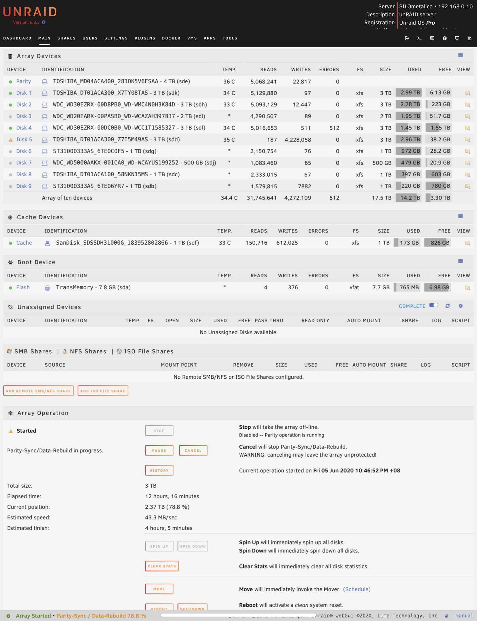

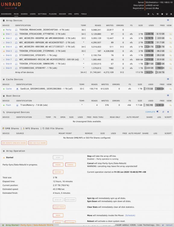

I started getting udma crc error warnings from disk 4. a lot. Last warning said there were 5622.
that can’t be good right? Does it mean disk 5 will have a lot of corrupted files after the rebuild? it isn’t even halfway through and already 5622 errors.
why is this happening suddenly? It’s like the universe hates me.
I'm quite sure I didn’t have any errors when disk 8 was being rebuilt.
CRC errors are usually the result of a bad SATA cable, replace it, and they are corrected, so it won't corrupt data.
Can I pause the parity/data rebuild while I check the cable?
Is it ok to shutdown unraid during rebuild?
udma crc errors now at 34577 and Unraid main page now shows 512 errors.
Rebuild seems unusually slow.
I’m kinda lost. Should I shutdown and check the connections now or should I wait until disk 5 rebuild is finished.
after checking the cables and all, should I rebuild disk 5 again? Would the errors cause data corruption?
Since there are actual read errors you should cancel the rebuild, shutdown and replace the cable, rebuild will then re-start from the beginning.
