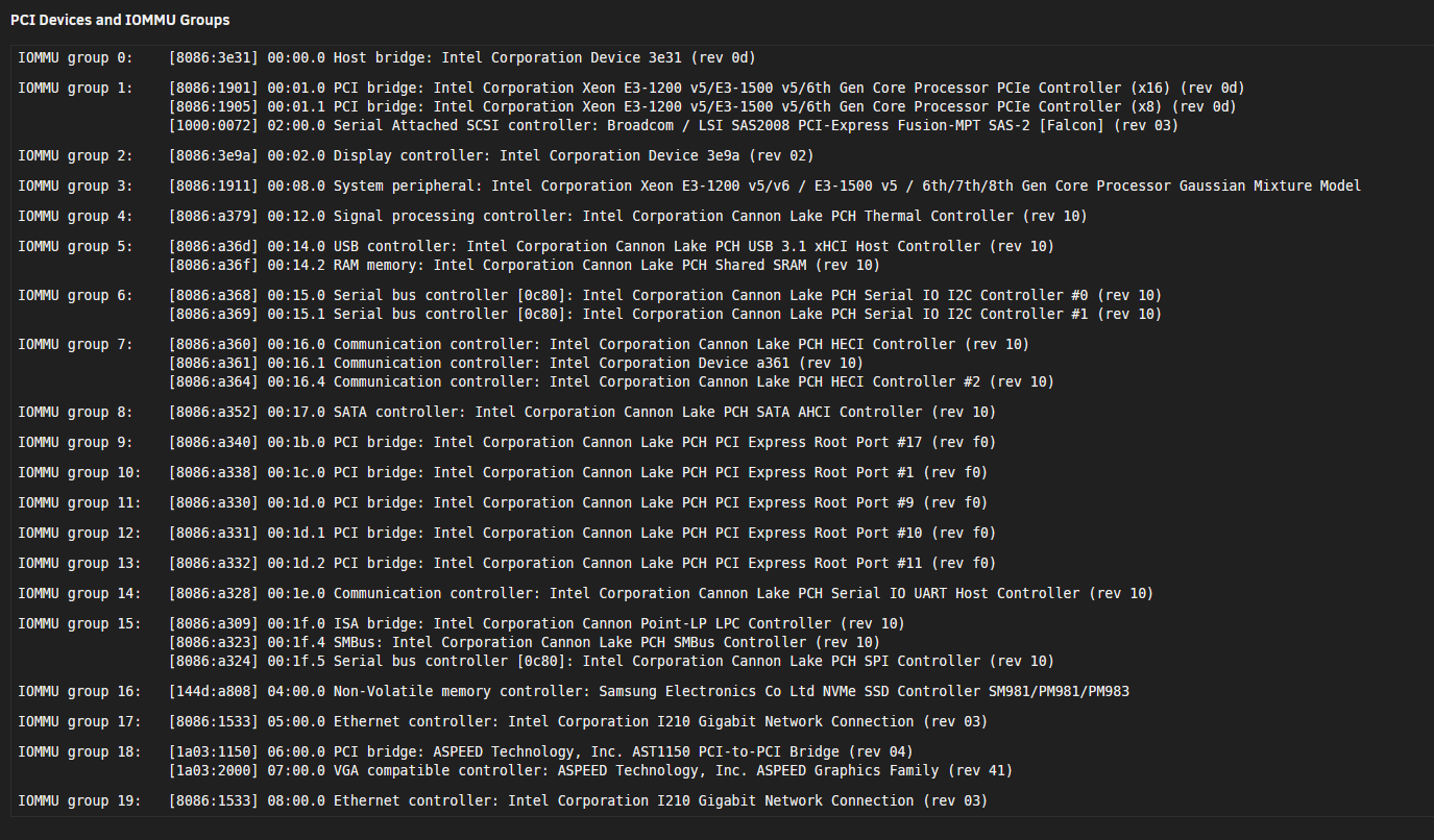

I'm reviving an older thread here... but just curious how the two of you are enjoying your builds currently? I'm currently considering either an E-2288G or E2246G with an ASRock Rack E3C246D4U.
Any issues this motherboard and challenges around the IOMMU groups and VM PCI passthrough? Also, are there any issues with having both IPMI (ASPEED BMC) and iGPU enabled at the same time? I'm coming from an E3-1245v5 (with iGPU) on a Supermicro board that I researched poorly (does not support iGPU at all... d'oh). I've also faced significant issues with IOMMU groups being ugly and not great for VFIO.
I am not passing through any hardware to a VM, but below are the IOMMU groups on the E3C246DU with an E-2288G installed.  Frankly, I would go with the E-2278G unless you really need that extra 300 MHz on the base clock speed.  The reduced TDP of the E-2278G is worth it for less heat.

Thank you! This is all extremely helpful feedback. Those IOMMU groups looks much better than my current Supermicro board. Also good to hear about the iGPU/BMC. I'm not too concerned about losing the video output as I'll have a GPU passthrough mostly hooked up to the a monitor.
