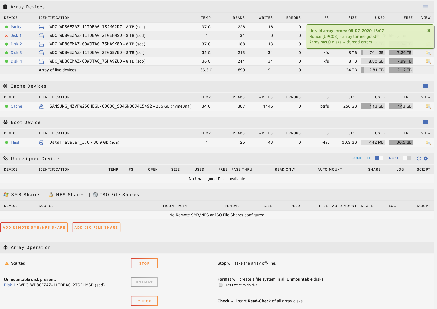

okay, I did the follow step:
1. shut down
2. check the connection is correct
3. turn on the machine
4. all led lights for every SATA port is on
5. generate diagnostics report: upc03-diagnostics-20200705-1311.zip
6. start array
7. generate diagnostics report: upc03-diagnostics-20200705-1313.zip
8. screen capture: Screenshot from 2020-07-05 13-14-55.png
thanks a lot!
upc03-diagnostics-20200705-1313.zip upc03-diagnostics-20200705-1311.zip
Check filesystem on the emulated disk1, if contents looks correct after it's fixed, and only if that's true, you can rebuild on top, I would also suggest replacing/swapping cables on disk1 before rebuilding to rule them out.

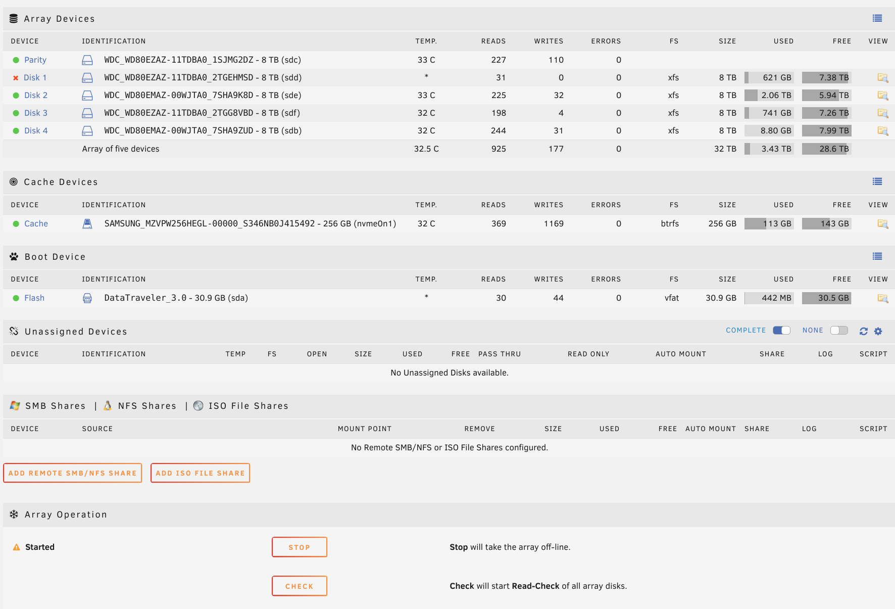

I did the following, but drive 1 is still disabled.
1.  shutdown machine
2.  change all cables
3. start machine
4. start array with maintenance mode
5. fix disk 1: xfs_repair -d
6. reboot machine
7. start machine with maintenance mode or not (both tried)
8. drive 1 is still disabled.
9. generate diagnostics report: upc03-diagnostics-20200705-1648.zip
10. screen capture: Screenshot from 2020-07-05 16-46-00.png
