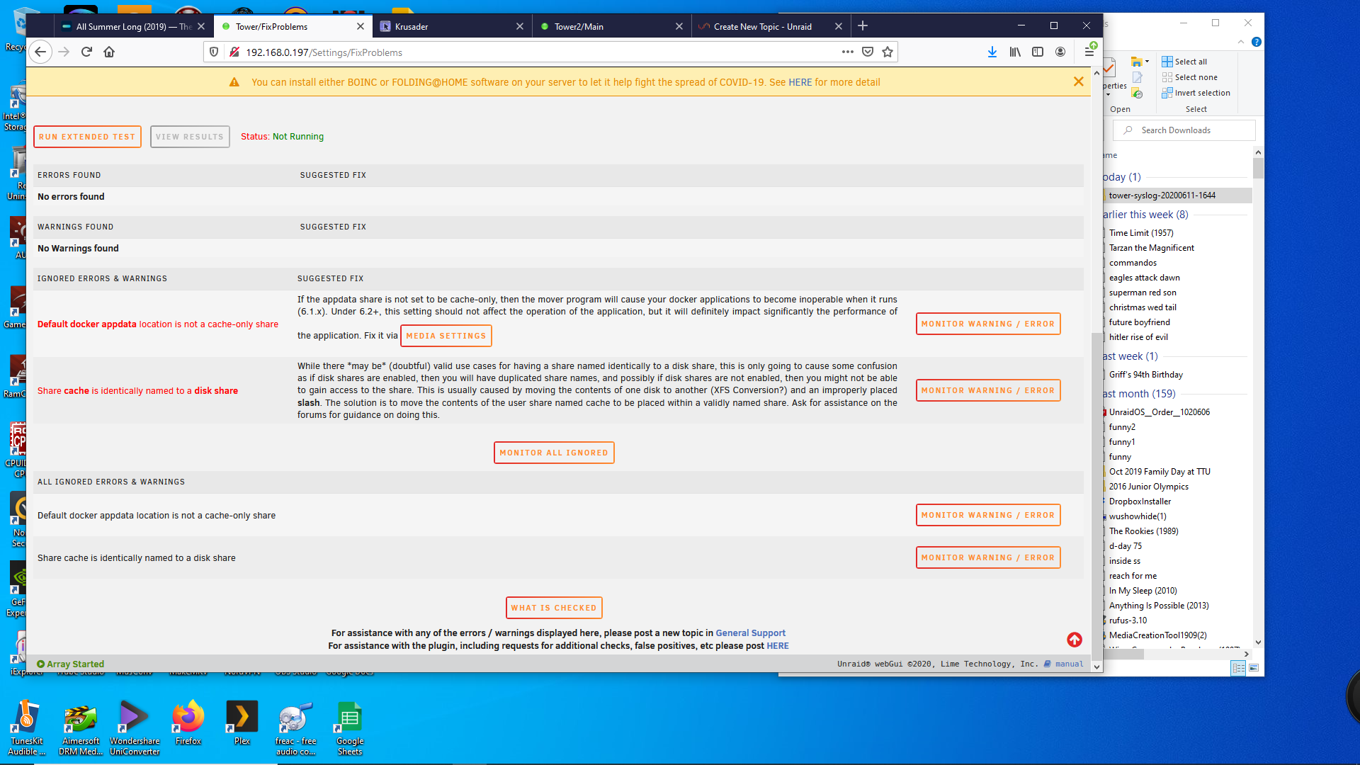

New variation on: Share cache is identically named to a disk share
tower-diagnostics-20191217-1231.zipThanks to Plex and probably my ineptude, I have a variation on this Fix Common Problem error.....

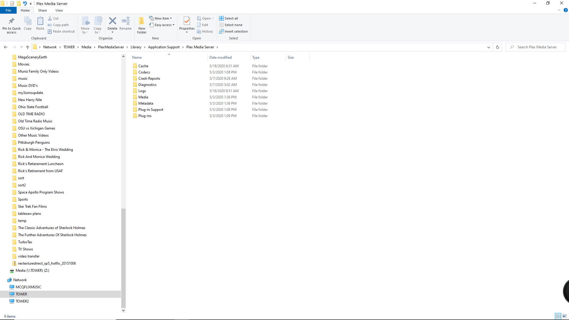

Previously had UNRAID specific version of Plex installed that had some issues.  So I  had the binhex-Plexpass version installed and it went wonky on me.  I got pretty tired of constantly needing to correct it that I removed it and installed the Plex linuxserver version....same story, so I installed Plexinc version and now it's all stable....but received this error from Fix Common Problems..I investigated and here are screenshots of what I found:

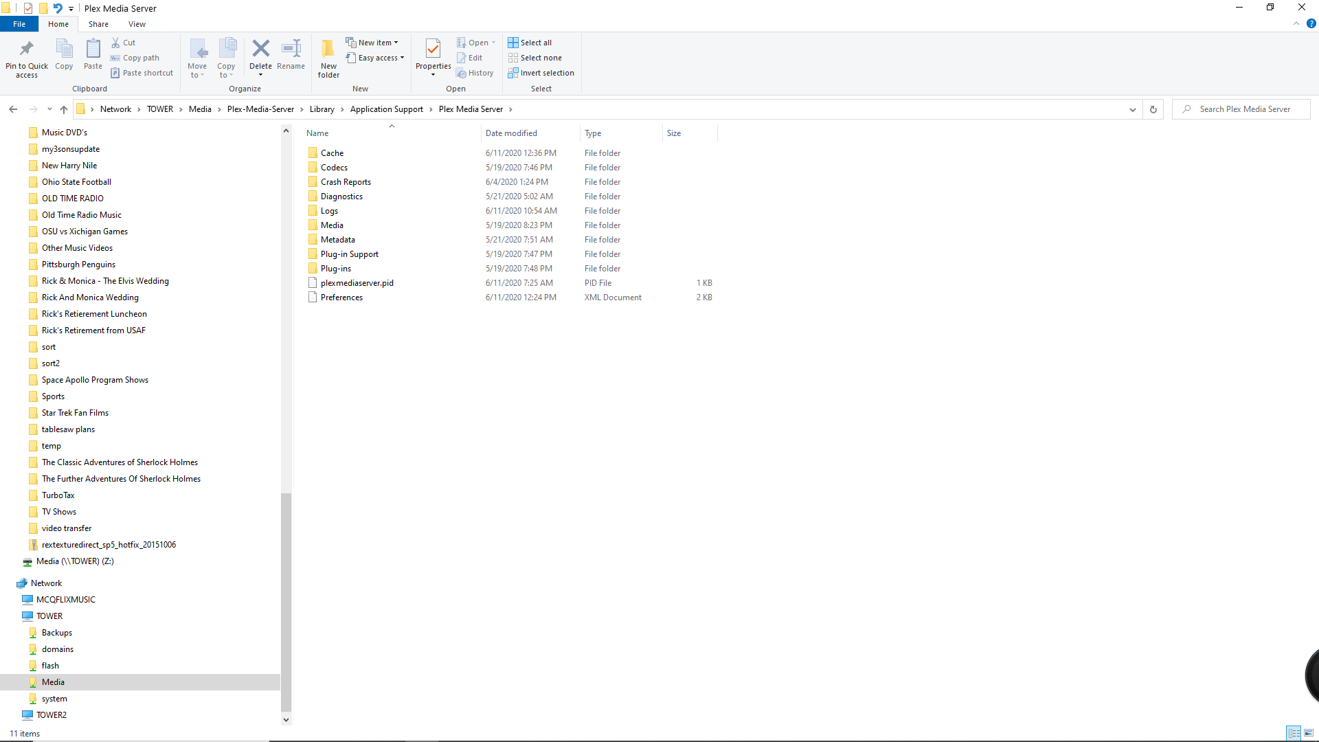

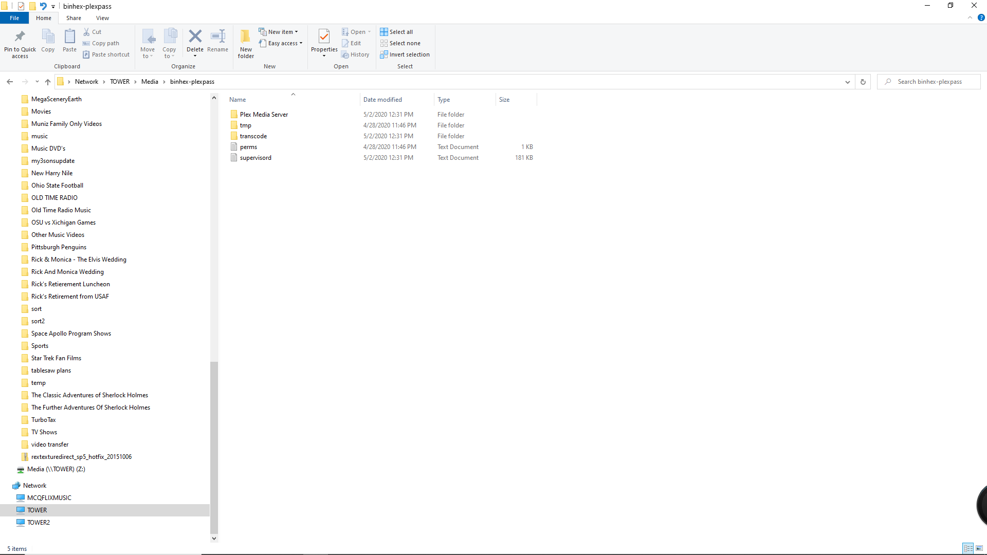

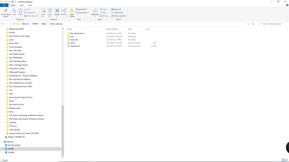

1..in My Media Share found binhex-plexpass  got me curious
2..Now I found both this further down the folder

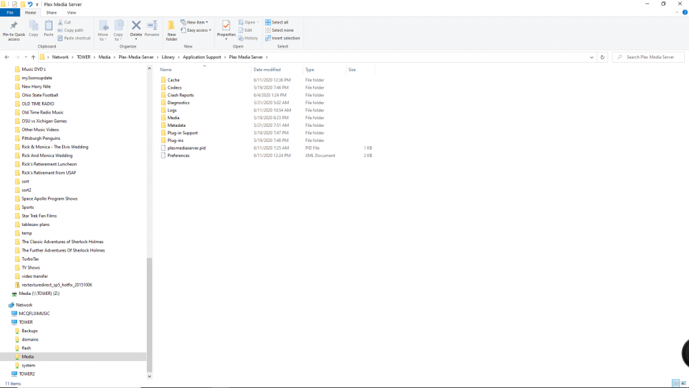

3..And also this folder
Folder 3 is, I believe the correct folder as the date is the latest modified date.  It also corrosponds to my cache....

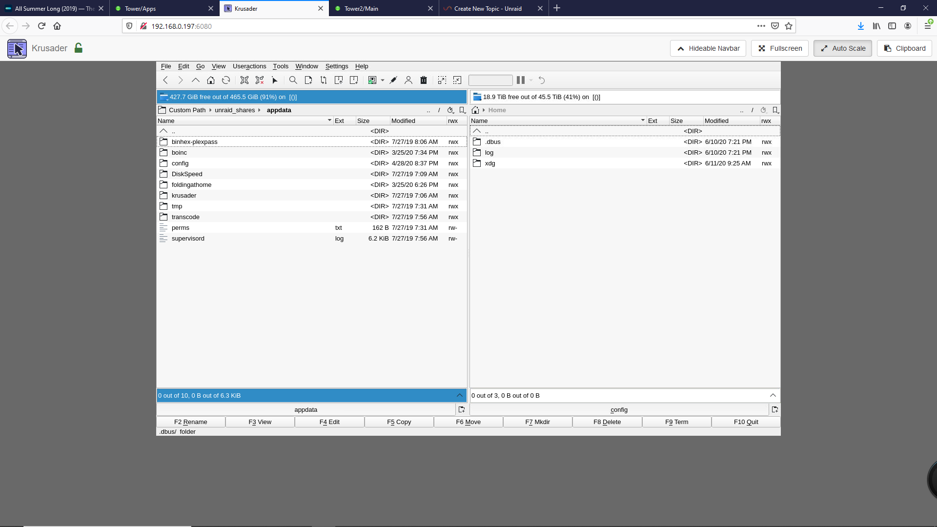

4..I use Krusader and go into my appdata and I find that binhex-Plexpass is there as well....
I have a baaaaad feeling if I use Krusader and delete this others, since it appears that inside each are metadata and listings of my files in my media share, that it will delete everything!  I'd like to free up the space but if instead of deleting I just rename, would that clear the error and ensure UNRAID stability?  Log files attached as well

Yes, I know about the other warning...fixing one problem at a time here! :)

Not clear what FCP is complaining about with the share named "cache". According to your diagnostics you don't have a share by that name.
The screenshots you give showing a folder named "Cache" is just a subfolder of the plex appdata (which for some reason isn't in your appdata folder).

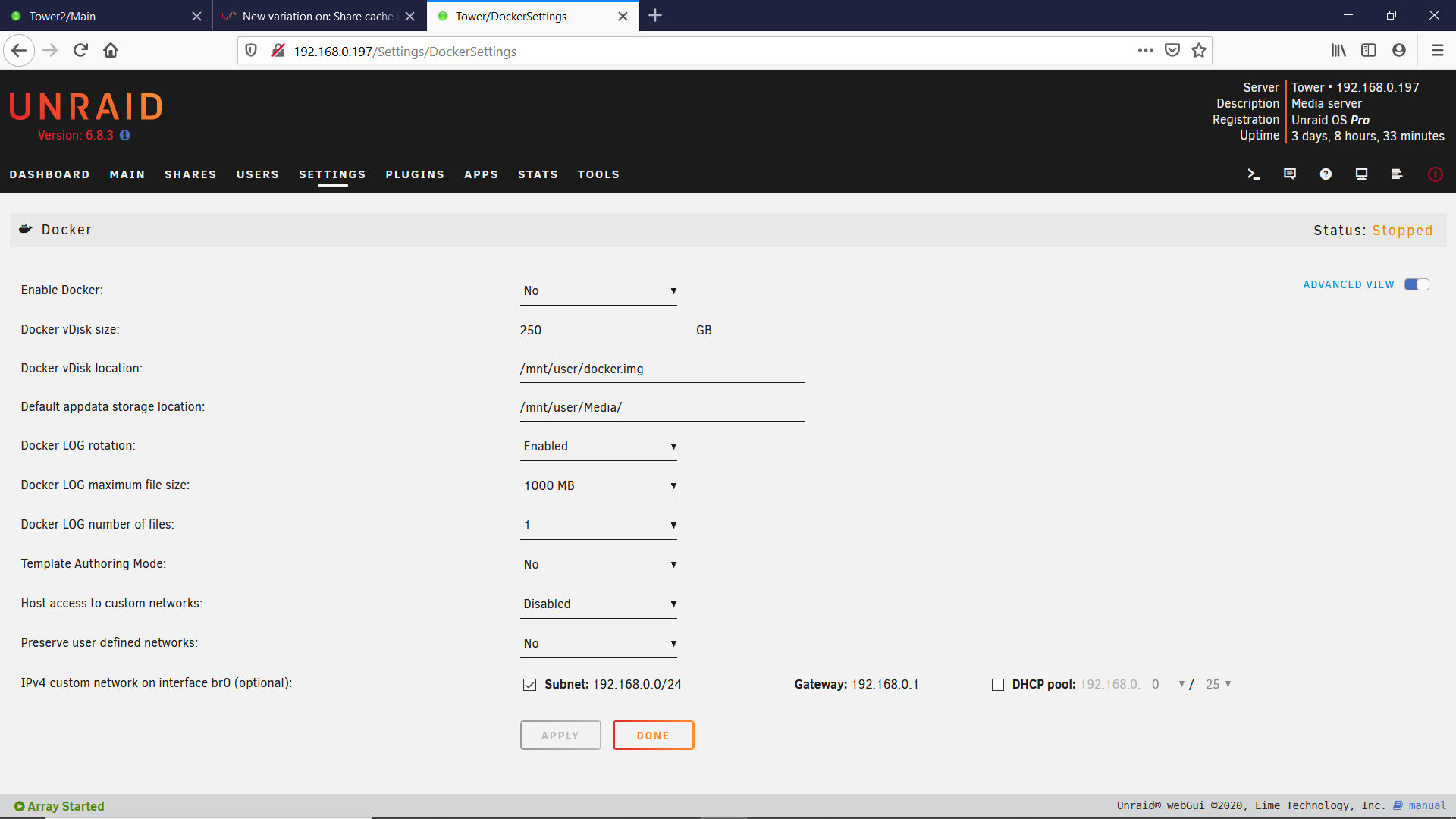

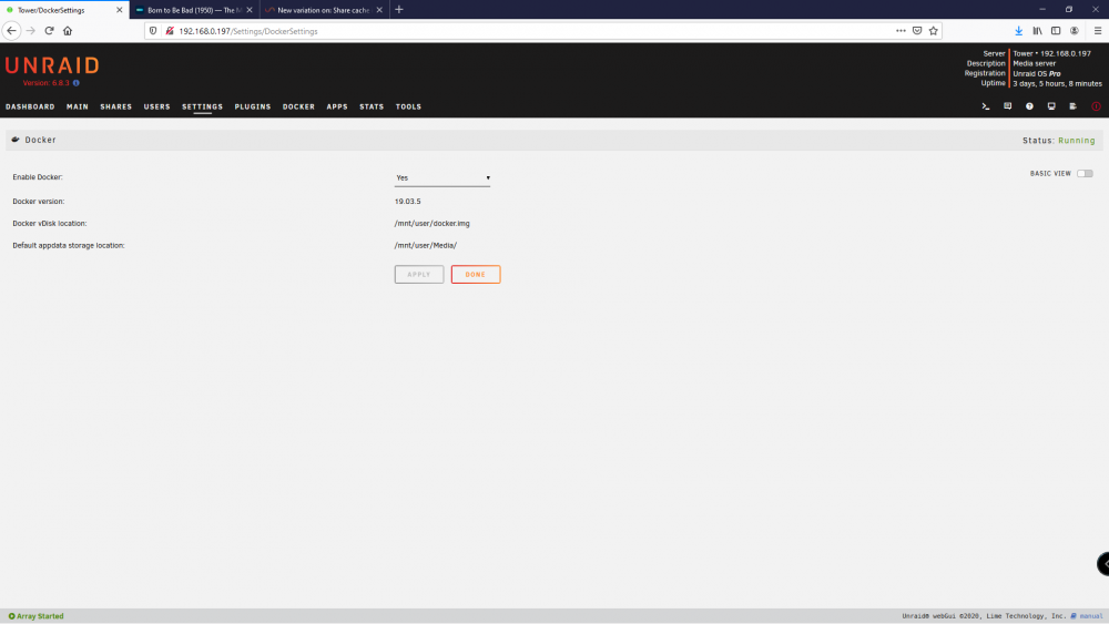

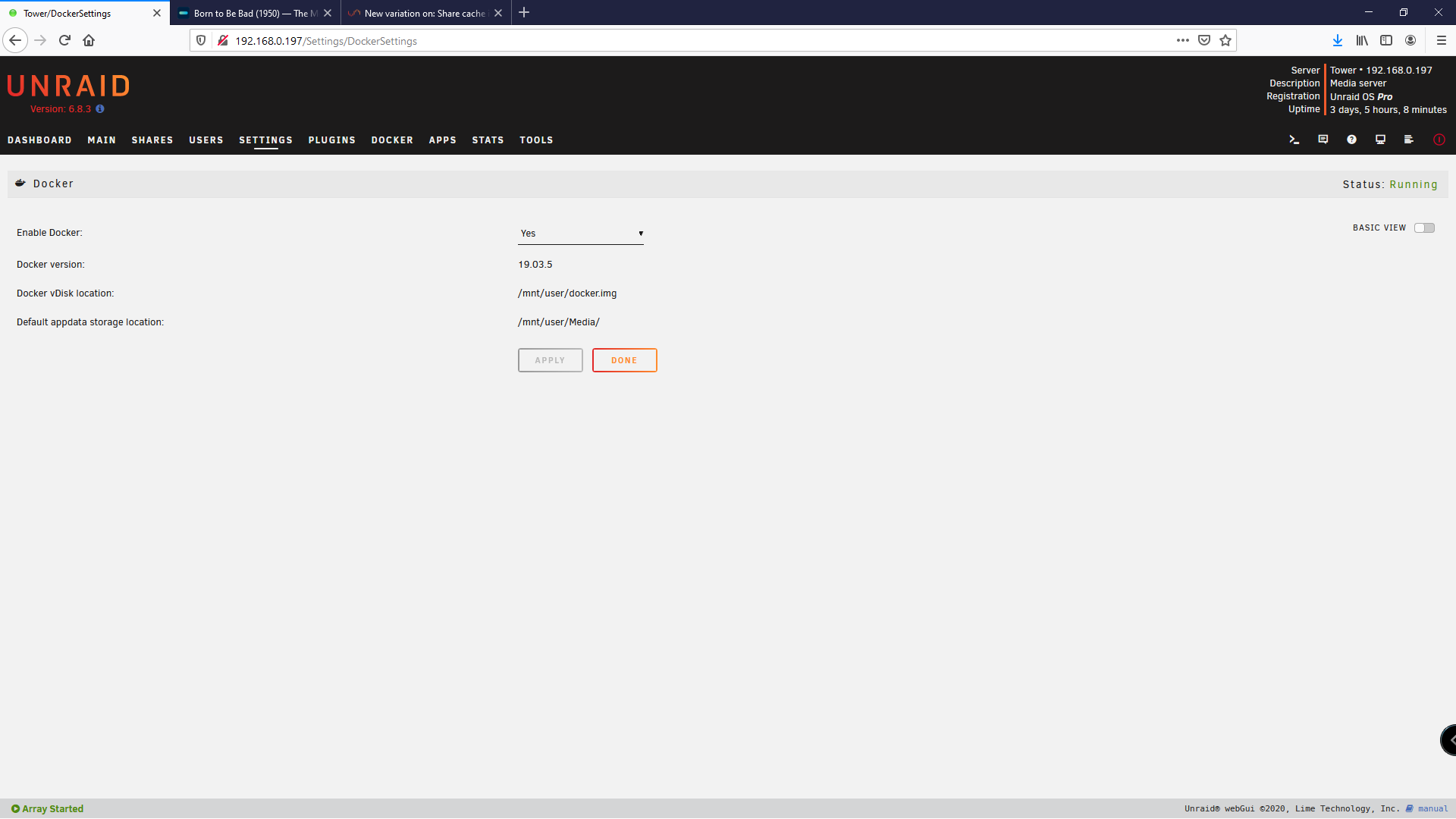

Post a screenshot of Settings - Docker.
Okie doke
Go to Settings - Docker, set Enable docker to No. Then, on that same page, delete the docker image. Move the slider from Basic View to Advanced View and post a screenshot.
OK, done and attached

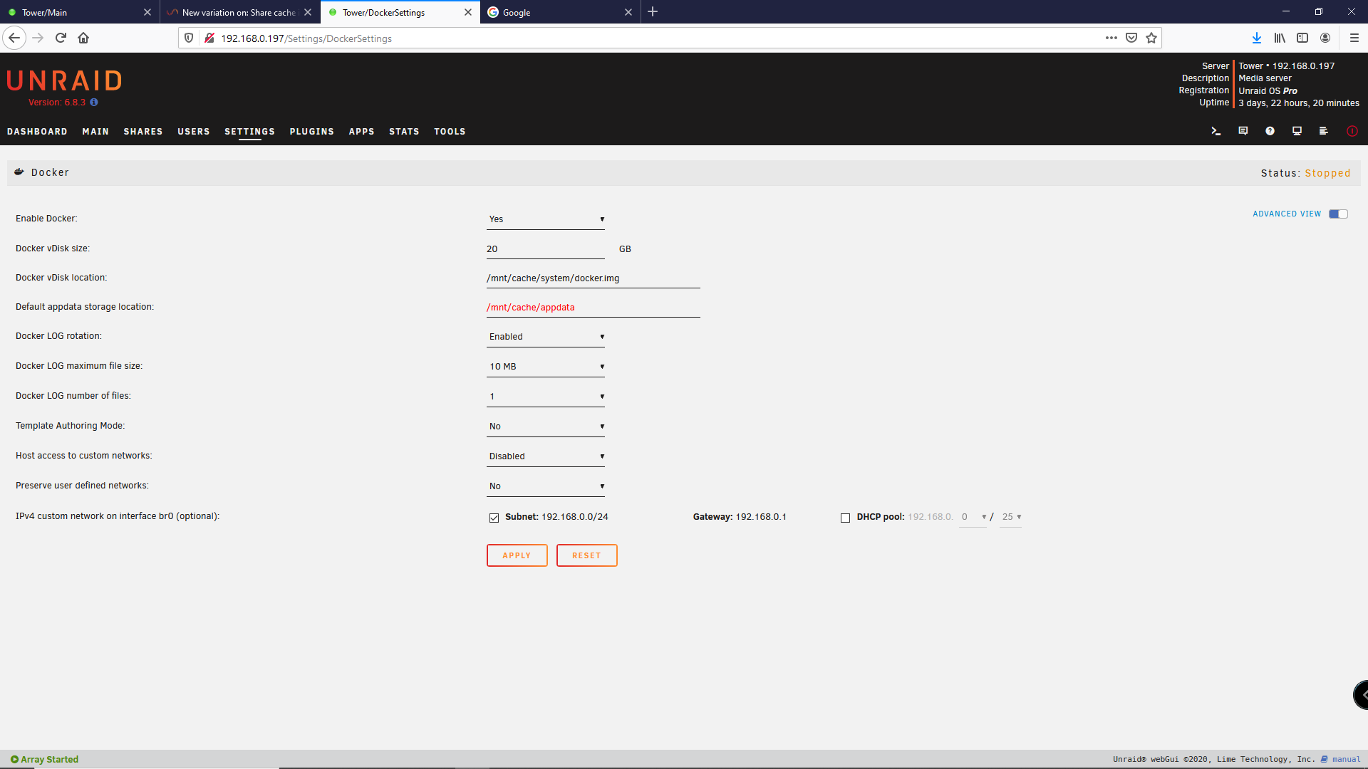

Make these changes:
Docker vDisk size - 20GB
Docker vDisk location - /mnt/cache/system/docker.img
Default appdata storage location - /mnt/cache/appdata
Docker LOG maximum file size 10MB
Then
Enable Docker - Yes
click Apply button

Up top at the beginning I've a screen shot that shows that even after removing the dockers, the folders remained for each of those versions with the data under the first line folder.  Like to get rid of them since they're taking up space and doing nothing but not at the expense of all my data in the folder I want, Plex-Media-Server folder which is the docker I'm going to reinstall
I'm trying to get you to a more standard setup of the docker system. All of those plex library folders you had from all the other plex installs are in the Media share. The standard place for those is in the appdata share.
Is the Media share where your media are stored, such as the actual movie files, etc?
Yes, the media share is where I have the movies, photos, etc.
The good news is everything in those folders are dupes and haven't been updated.  Meanwhile, the Plex-Media-Server folder, which is linked to the Docker I want to use, has been updating.  I'm thinking I can delete the others but I've been burned before so trying to move cautiously this time.  Moving files from my backup back to the primary server takes about 3 weeks to move it all and set up

Did the above set up as you directed....but, it appears it doesn't like: Default appdata storage location - /mnt/cache/appdata.....came up red when I enabled docker to yes and hit apply.  Attached the screenshot.  Could this be happening because appdata folder is /mnt/user/appdata and there is a separate /mnt/user/cache?

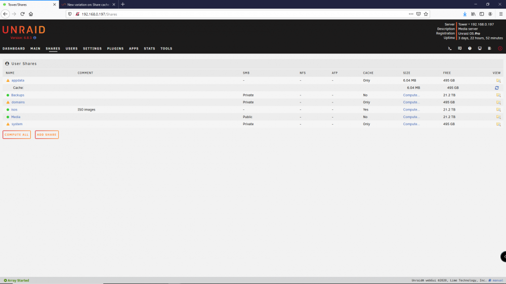

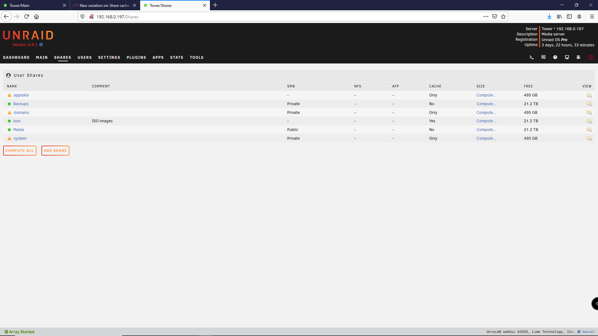

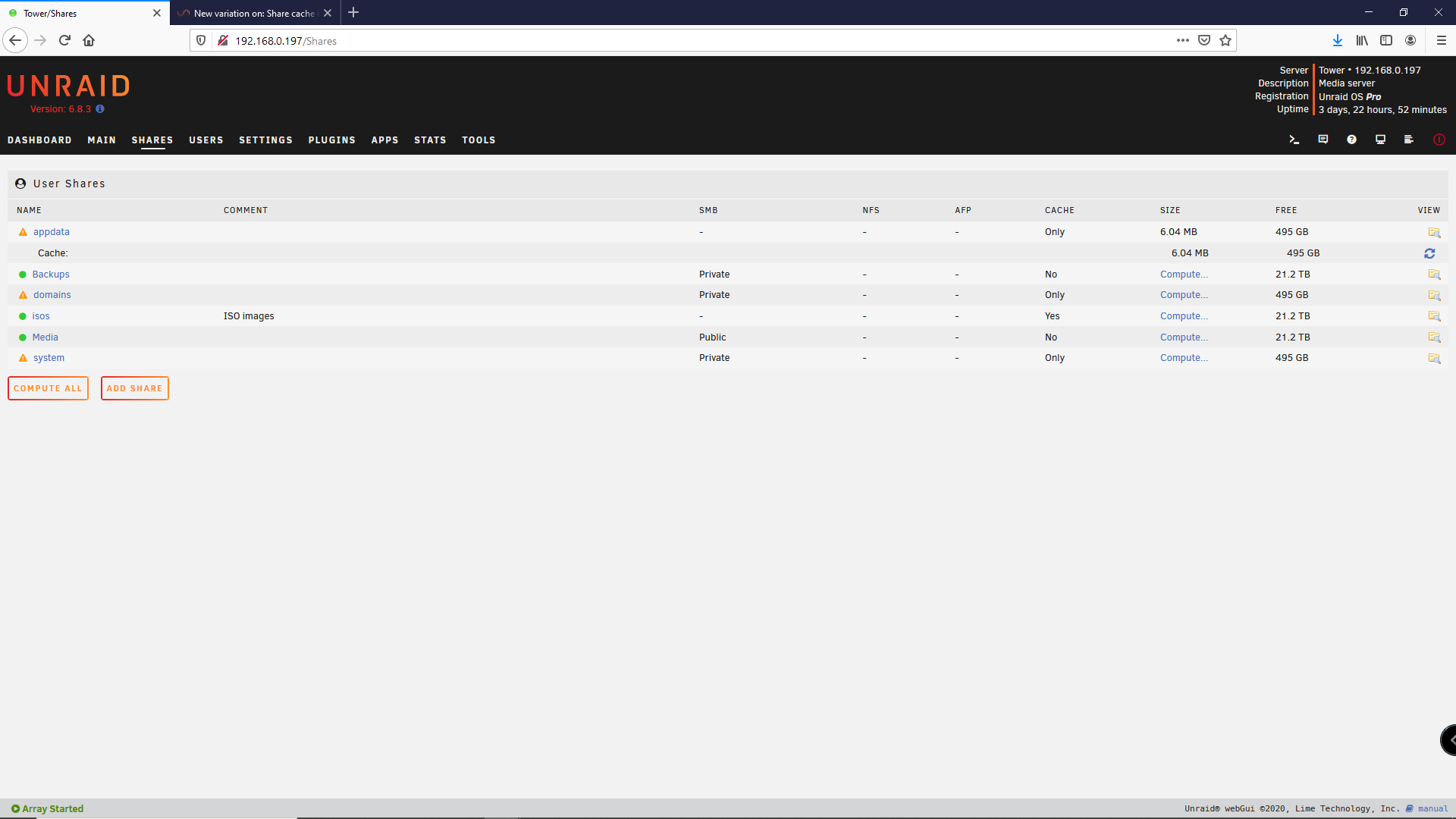

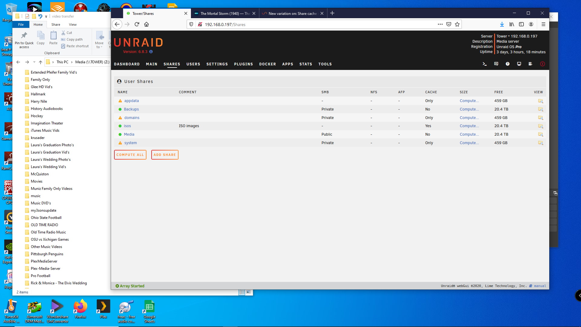

Looking at my shares and there is no cache share, starting to wonder, "should there be?"
Looking again at your FCP screenshot, it says that warning about a share named cache is a warning that you have set to ignore. I don't think you have that condition anymore but it is still set to ignore it.
There should definitely not be a share named cache. That is the whole point of the FCP warning. Since user shares are simply the top level folders on cache and array, there are several ways someone can accidentally create a user share with the same name as a disk, and that is why there is a warning for that. It is easy to get confused, and in fact, it can confuse SMB, if you have a user share with the same name as a disk.
On that User Shares page, click Compute... for appdata share and post a screenshot.
That's what I thought, but the conficting FCP message is throwing me off, as well as the docker settings not taking.  I reset the warnings in FCP and did a recan....still shows the same 2 warnings as before.
