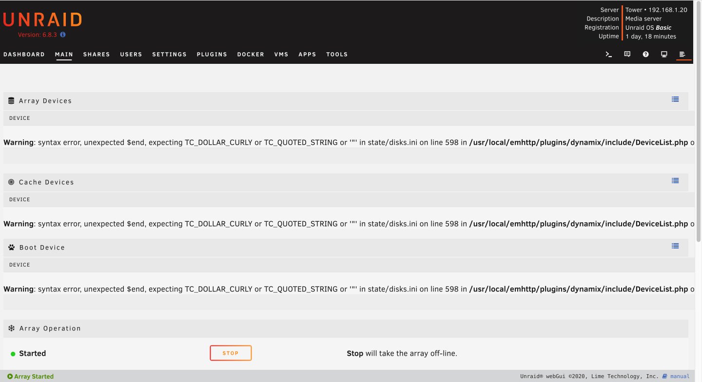

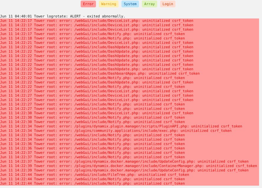

Hoping someone might be able to assist with this issue, as I've searched (and tried) several different options, but to no avail.
This all started when I recently upgraded my parity drive (from a 3tb WD to a 4tb Seagate).  The obvious answer is that something is wrong with the drive, but I'm not sure.  The array starts up fine, no errors of any kind, and the server runs normally for about a day.  Then, all of the drives (including the USB boot drive) disappear from the array.  Sometimes I get an "Array Undefined" message in the lower left of the browser, sometimes not.  Sometimes I can see the shares, sometimes they're gone.  When the shares are missing I can't access the files through my Mac, but Plex can continue to run normally.
I changed the cables, updated the USB drive, and upgraded from 6.4 to 6.8, but the same issues remain.  I've attached a few images along with this post, as they are the only error messages I've been getting.  I have no Dockers and no VMs, the only app I have installed is the Community App plug-in.
