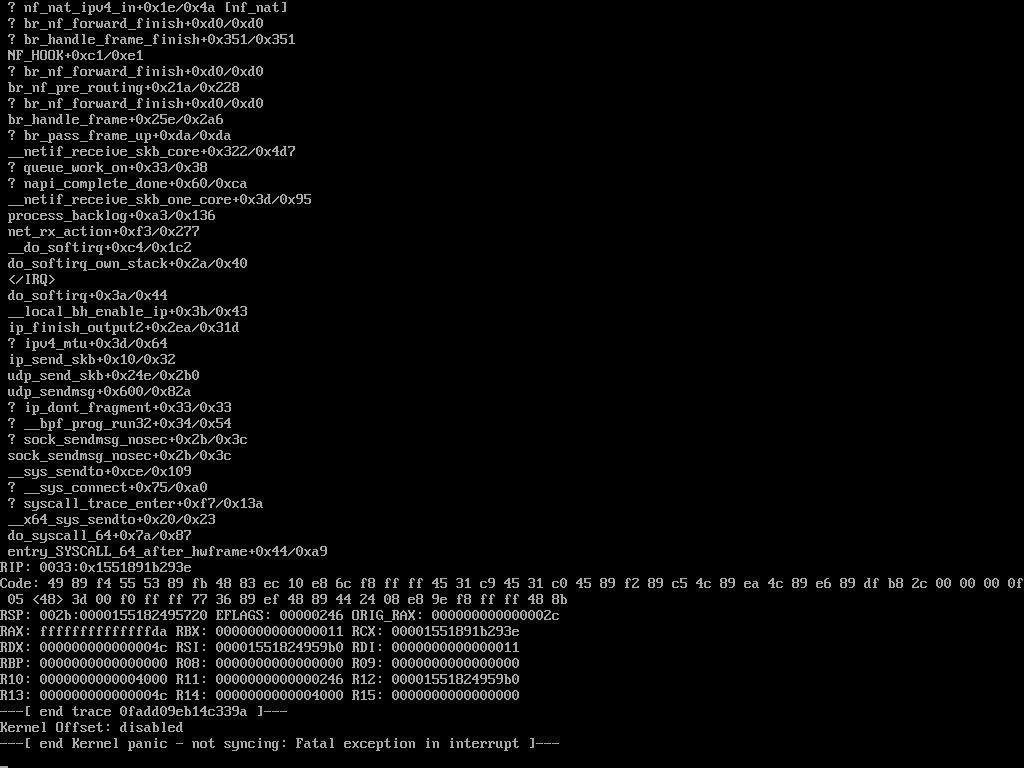

The past week or so I've been getting kernel panics on my server.  This has definitely been happening on the most recent betas (6.9.0-beta1 and beta22) and may have been happening on the stable release as well.  Unfortunately as the kernel panics, there are no logs of what was happening before or what went wrong, attached is the only screenshot I've been able to pull from the console screen.  Any suggestions would be much appreciated.

If that fails, try dropping the memory speed from it's overclock setting of 3200 down to its native speed of 2666
Will do, thanks!
Update: The server crashed again.  I have now reset the RAM overclock so it's running at stock speeds.
The panic does always appear to be in some kind of TCP stack, so that might be relevant if it crashes again.
Final update: The server has not crashed again, so I can comfortably say that the problem was the overclocked RAM.  Thank you everyone for your help!
