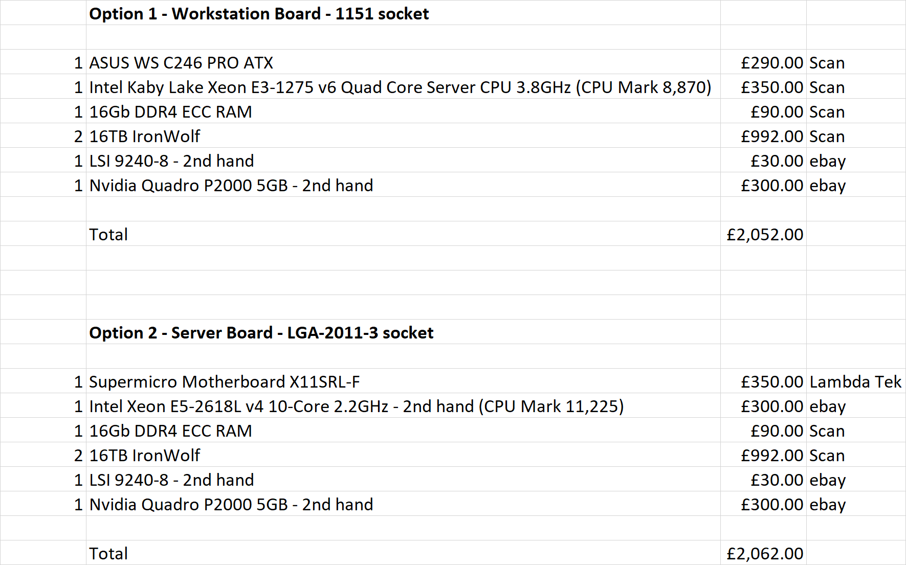

July 6, 20206 yr Hi all, I've put together a couple of mobo / CPU combos which im just not sure is best bang for buck or could be make cheaper without too much compromise. Here the chassis it's going into where i would like to reuse the PSU and drive cages. Heres some info on that right here Quick Sync is an advantage when hardware transcoding in Plex - i'm not sure that is really important if a graphics card is being used, such as the P2000 but i'm wondering if just using the CPU for transcoding rather than a separate GPU for the Workstation option will be ok and net a bit of a saving in the build cost. I can always add a GPU in at a later point in time if i feel i need it i thinking. Does that make sense or am i looking at this wrong? The 2618L is higher performing - but older tech. Power consumption looks to be the same. I have some 4TB drives from a Synology NAS i might use - got to to figure out the storage element a little tbh, but that's a lot easier.

August 3, 20206 yr Author Hi Zonediver, thanks for the reply. I don't think i was being clear at all. What i was trying to say is that i would want to use iGPU for transcoding with discrete GPU pass-through to a gaming VM but just not sure if i will do this as i don't really get time for games and haven't had a gaming system or console for years but i like the idea of getting into some sim racing a little - might never happen. I have chosen the below hardware but struggling with an ETA on the motherboard and i keep questioning if this option is really the best for both unraid, plex (i have plex pass) but also running maybe 10 or so docker containers and some test / dev VMs and even a gaming VM. Would a better CPU be better do you think? I heard that sticking to Intel for unraid general support is best, but these new AMD CPUs are compelling from a price / feature point of view. But i would need an integrated GPU for transcoding so that limits my CPU options to the Ryzen 3 and Ryzen 5 i believe. I haven't researched how these fair with transcoding vs Intel. Here's what i've ordered so far for this build: Gigabyte Intel C246-WU4 XEON Server Motherboard Intel Xeon E-2278G, S 1151, Coffee Lake, 8 Core, 16 Thread, 3.4GHz, 5.0GHz Turbo, 16MB, UHD Graphics P630, 80W 2 x Crucial DDR4 ECC UDIMM 16GB 1 x Noctua NH-D15 Dual Radiator Quiet CPU Cooler LionLi ATX case (reused from old build) 3 x Icydock 5 x 3.5" hot swap enclosures (reused from old build) 2 x Samsung 970 Evo NVMe 500G M.2 (reused from old build) 1 x Crucial 2.5" 240GB SSD 5 x 12Tb WD Elements drives (2 parity / 3 data) LSI 9240 in IT mode Silverstone 750W modular PSU (reused from old build) It's very much overkill CPU-wise, but i'm hoping to really get a lot of VMs deployed and i managed to get the CPU and RAM at a good price through work. I'm not sure on the GPU side of things, not played games for a very long time so i need to research and look into USB pass-through as well which my become a problem. Any comments / thoughts on this build and approach are welcomed - happy to be put wrong here i'm learning on the go. Edited August 4, 20206 yr by Jacko_ Added more components

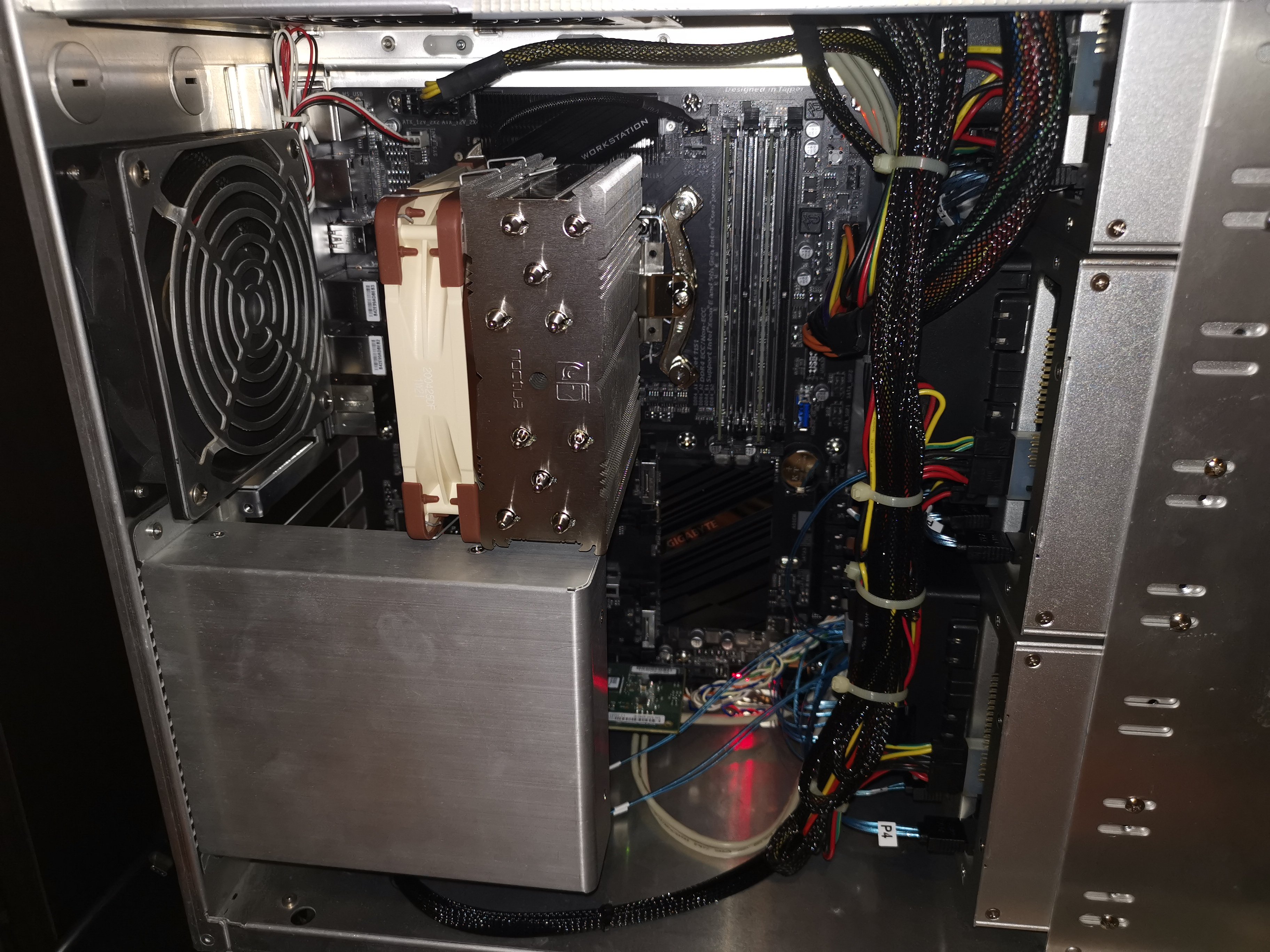

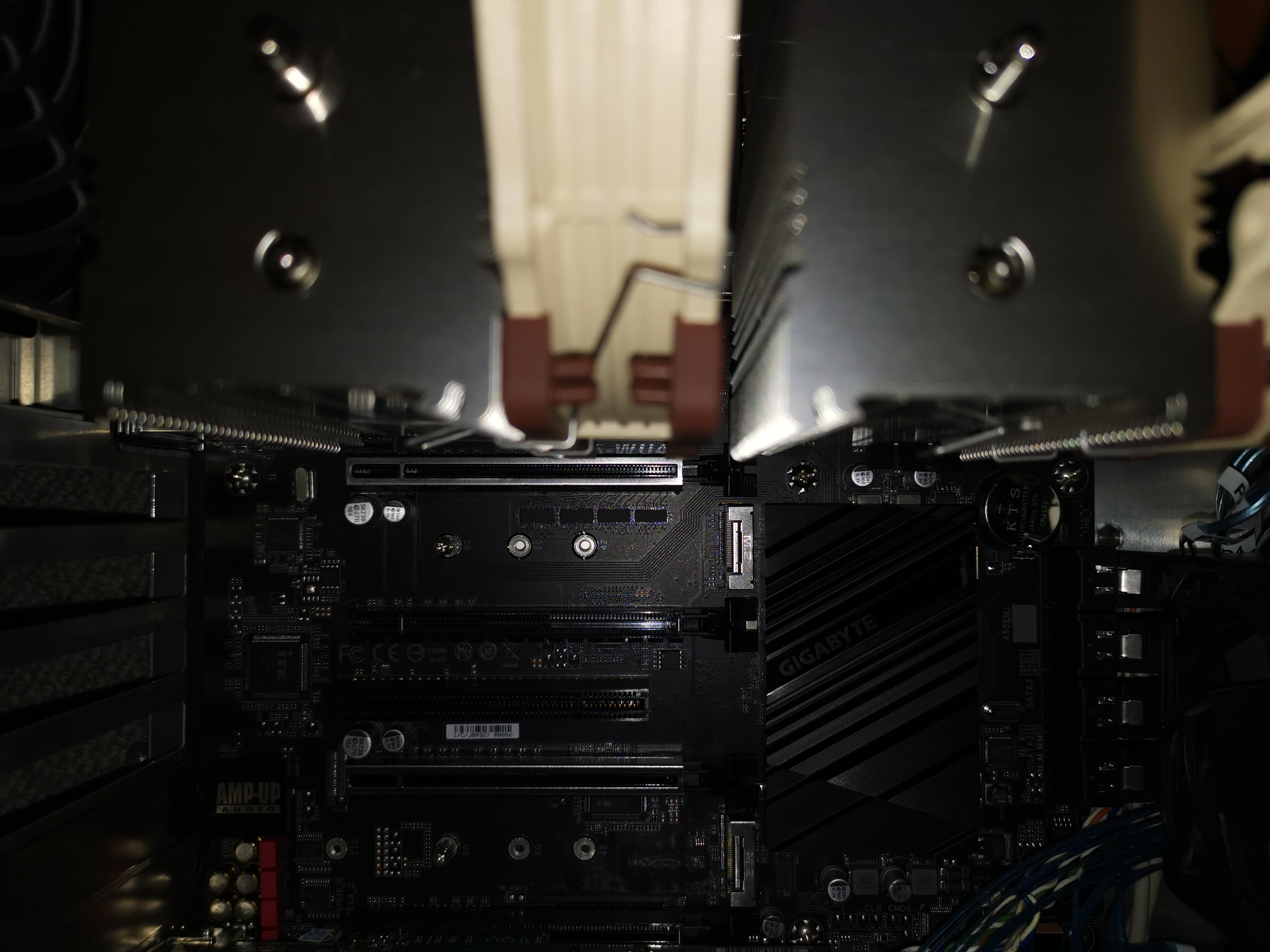

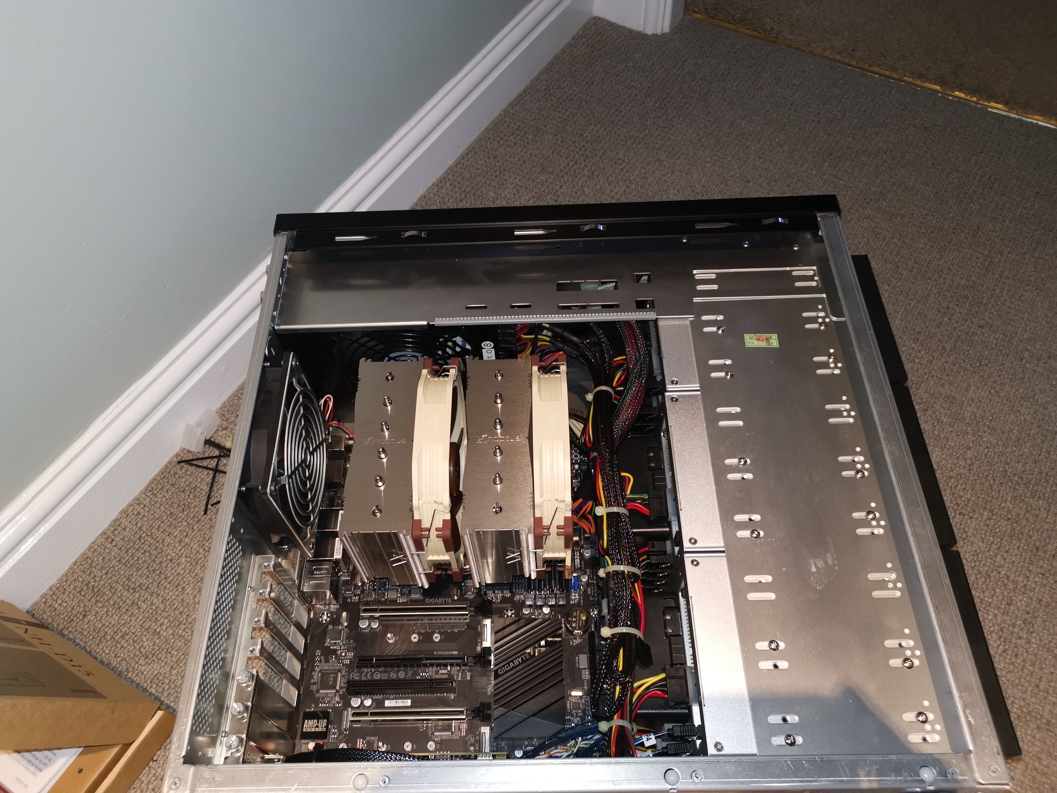

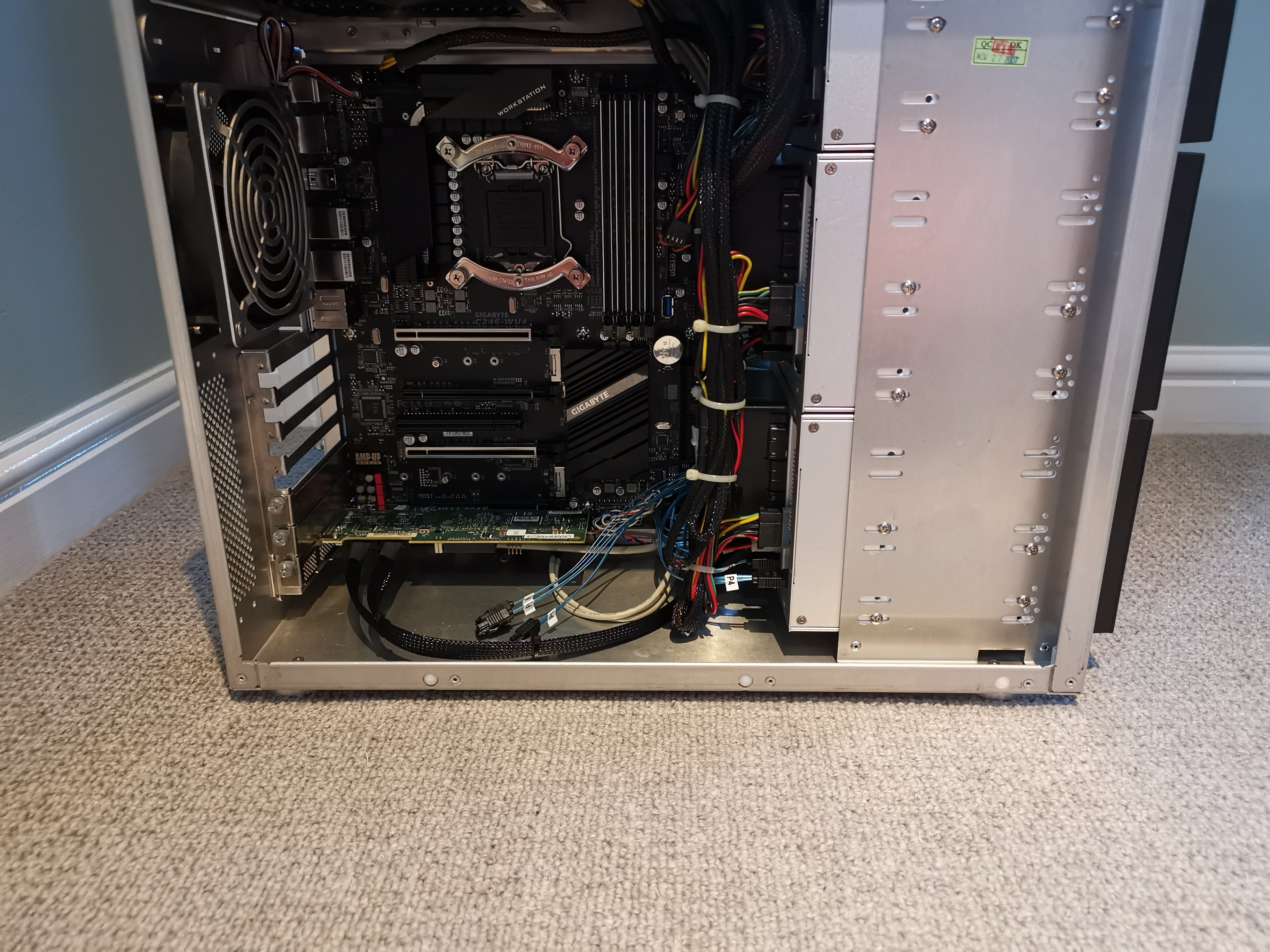

August 4, 20206 yr Author I went and collected the MB and CPU cooler today and spent an hour or so putting it together while i wait for the CPU and RAM which should hopefully be with me before the week is out. Cabling is a nightmare and i've done the best i can with it for now. It's not perfect but TBH i'll do. My main concern now is the sheer size of the CPU cooler and the available space. I've mounted the brackets so the cooler is pulling air from the front to the rear. With it mounted this way i think it will block the PCIe slot i was hoping to use for the GPU. I won't know until i can get the CPU installed and the cooler mounted but it looks like it might be a problem. I could take an angle grinder to the fins worst-case. I think returning the cooler for a small model is out of the question now as i've got my finger prints all over the thing! Here are some shots nonetheless, any advice you have please give it. The drives i've bought are WD elements which i have taken out of the housings. I'm aware of a 3v power issue with the sata power connector but these icydocks are old and each of them is powered via 3 x 4 pin molex so i don't think that will be an issue for me. I just hope the icydock back-plane doesn't limit the transfer rate, i'm not sure if they were rated for SATA2 when i bought them many years ago.
August 4, 20206 yr 45 minutes ago, Jacko_ said: Plex on SSD - check, does these need me dedicated hardware or can it be shared as part of the system cache pool? Either is fine. It really depends on what you have at hand and how big your main cache pool is. Plex db generally doesn't require dedicated storage since there isn't much of a load for it to be an issue. So it comes down to free space.
August 4, 20206 yr 40 minutes ago, Jacko_ said: I went and collected the MB and CPU cooler today and spent an hour or so putting it together while i wait for the CPU and RAM which should hopefully be with me before the week is out. Cabling is a nightmare and i've done the best i can with it for now. It's not perfect but TBH i'll do. My main concern now is the sheer size of the CPU cooler and the available space. I've mounted the brackets so the cooler is pulling air from the front to the rear. With it mounted this way i think it will block the PCIe slot i was hoping to use for the GPU. I won't know until i can get the CPU installed and the cooler mounted but it looks like it might be a problem. I could take an angle grinder to the fins worst-case. I think returning the cooler for a small model is out of the question now as i've got my finger prints all over the thing! Here are some shots nonetheless, any advice you have please give it. The drives i've bought are WD elements which i have taken out of the housings. I'm aware of a 3v power issue with the sata power connector but these icydocks are old and each of them is powered via 3 x 4 pin molex so i don't think that will be an issue for me. I just hope the icydock back-plane doesn't limit the transfer rate, i'm not sure if they were rated for SATA2 when i bought them many years ago. I mean if you're in the return period you probably can return the cooler still, fingerprints or not. That is some seriously tight clearance though, I'd definitely look at the return option before taking an angle grinder to it, especially given that the fans mount to the fins on the outside, so you'd likely destroy their mounting mechanism in trying to grind down the fins. You'd be better getting another cooler and eating the cost / using it in another build if possible. Regarding the Icydock, SATAI or SATAII is definitely gonna be more limiting than Molex vs. SATA power. If you can find a cheap SATAIII backplane I'd recommend it, because I can say right now that backplane will bottleneck your array performance from the get go. Edited August 4, 20206 yr by untraceablez Clarifying answers, adding answer to icydock comment, missed it originally.
August 4, 20206 yr Author 5 hours ago, untraceablez said: I mean if you're in the return period you probably can return the cooler still, fingerprints or not. That is some seriously tight clearance though, I'd definitely look at the return option before taking an angle grinder to it, especially given that the fans mount to the fins on the outside, so you'd likely destroy their mounting mechanism in trying to grind down the fins. You'd be better getting another cooler and eating the cost / using it in another build if possible. Regarding the Icydock, SATAI or SATAII is definitely gonna be more limiting than Molex vs. SATA power. If you can find a cheap SATAIII backplane I'd recommend it, because I can say right now that backplane will bottleneck your array performance from the get go. I'm going to give returning a shot once I've tried cleaning the prints off with some alcohol and boxing back up with all of the bits. What I have done is bought another noctua which uses a single 120mm fan so I hope all of the mounting hardware is the same, so opened bags can be replaced for unopened etc and saves me removing the motherboard to get access to the mounting bracket. So, all being well that should be possible. With regard to the sata performance while I can say for certain, I'm in the hope that the backplane has no logic that will hinder performance. If data is just passed through to the sata cable from the backplane then the performance is driven out of the connecting controller for each indavidual drive. Possibly wishful thinking but will save me a lot of money and messing about if this is the case. Im looking forward to powering on for testing and setting up.

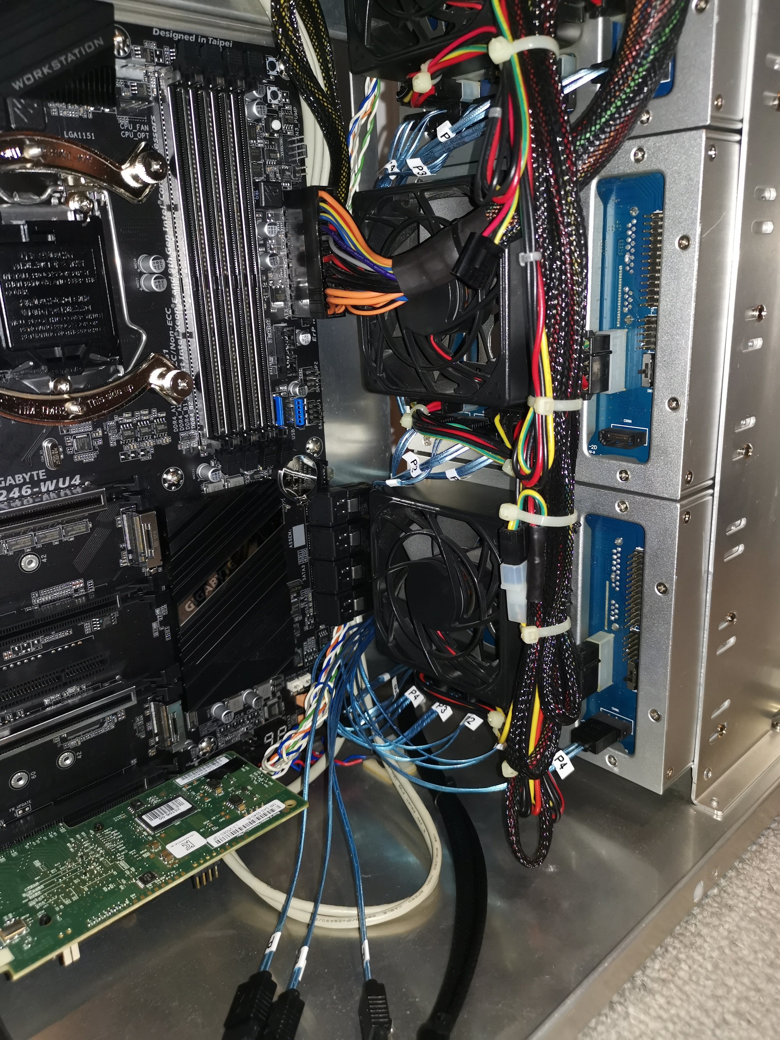

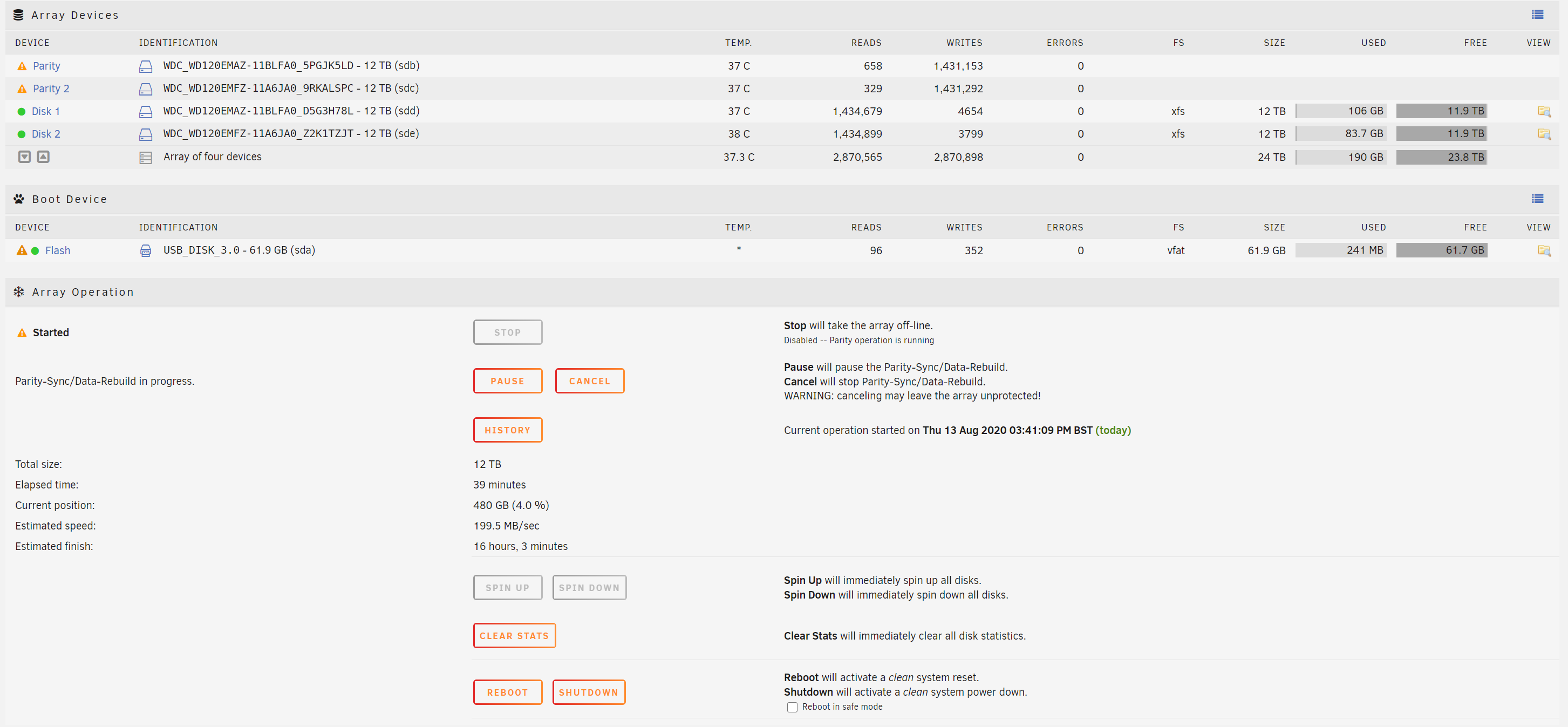

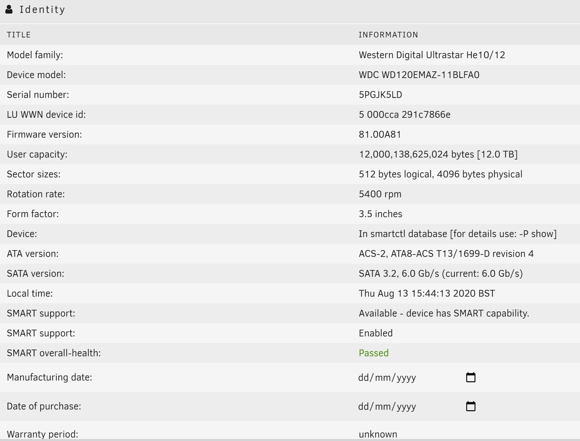

August 13, 20206 yr Author Well i'm up and running. I have not added all drives or any NVMe or SSD yet but will do in a few days. I have currently installed Version: 6.9.0-beta25. Did so on a 64Gb SD card as it was all i had available at the time, despite unraid stating 32Gb max i wonder if the new code allows for larger USB keys? I added 4 of my 5 12TB WD element drives and i have tried to add 2 of them for parity and 2 for data and i checked the drive stats. I will need to check on the read / write performance but the SATA version is showing as 3.2 @ 6Gb/s which is promising. If you recall back it was a concern that the icydock/s would be a bottleneck but that has given me hope that they will not be. I'm a little confused as to why the parity drives are showing with warnings which i suspect is due to the parity sync it is doing perhaps. Is this having to align the sectors on each of the parity drives to build up a reference table? The estimated time to complete it over 16 hours. I have the larger cooler ready to return to the supplier and i bought a replacement online with a much smaller heatsink and with a single 120mm fan. Hopefully i can keep the temps down still. I have three fans at the rear of the icydocks, with a PCI-e 120mm fan exhuasting out the rear. 120mm fan pulling air through the heatsink and a 120mm pulling air out the rear of the case. The PSU is mounted in the top of the chassis and has 120mm fan (bearings are noisy so i want to replace this one).

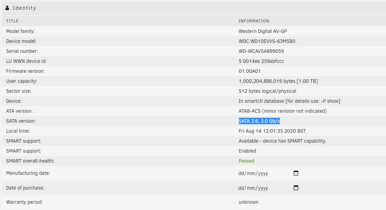

August 14, 20206 yr Author I added some old 1TB drives to the array, just testing if hotswap worked ok etc and to see if these slower drives reported SATA speed correctly and these do so SATAII @ 3Gb/s so this is great news that the icydock backplane is completely passive with no logic and will support my new shiny SATAIII drives at full speed.
