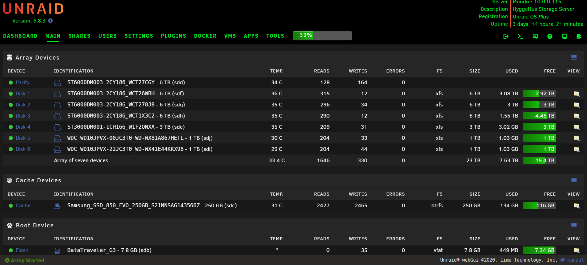

July 9, 20206 yr OK, first off, sometimes when a torrent is downloaded, the permissions are changed so that any users, can't read or write to the directory, but guest can read, but has no write, and i either have to do the "new permissions" thing on the control panel or chmod 777 from terminal... weird. Shut down to move UPS location and now Disk 3 (a 6 month old 6tb drive) is saying unmountable? I shut down correctly and am confused because there is nothing obvious to me in SMART data or otherwise that makes that drive seem any bad at all. Please help mondo-diagnostics-20200708-2239.zip
July 9, 20206 yr Author no errors on drive, should I just format it? but won't I lose the data that's on it? There are several recent things in my /downloads share that are no longer there since this morning. I don't understand why it isn't automatically re-adding the drive? mondo-smart-20200708-2203.zip
