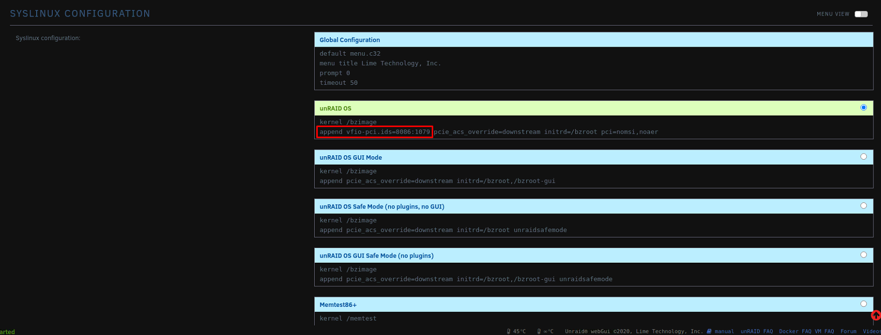

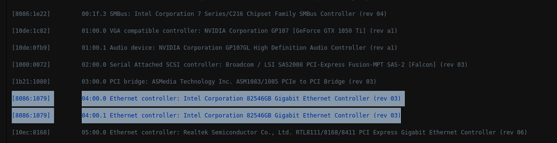

July 10, 20206 yr Hey guys I'm working on setting up my own pfsense router since I finally got gigabit internet in Australia, but my current router isn't cutting it. The NIC's show in system devices, but I seem to be failing to stop unraid for using them Above are the devices Here is my syslinux config With append vfio-pci.ids=8086:1079 I can still see the network adapters listed in NetworkSettings, so it seemed to have 0 change I then also tried append pci-stub.ids=8086:1079 With this the network adapters no longer show in NetworkSettings but I also can't see it as an option to passthrough to a VM I am running unraid 6.8.3 unraid-diagnostics-20200710-1317.zip Above is attached diagnostic download of my tower. in case at all relevant. Should be noted I also have PCIe ACS Override setting enabled. Any help would be appreciated as always! Edited July 10, 20206 yr by Addy grammer
