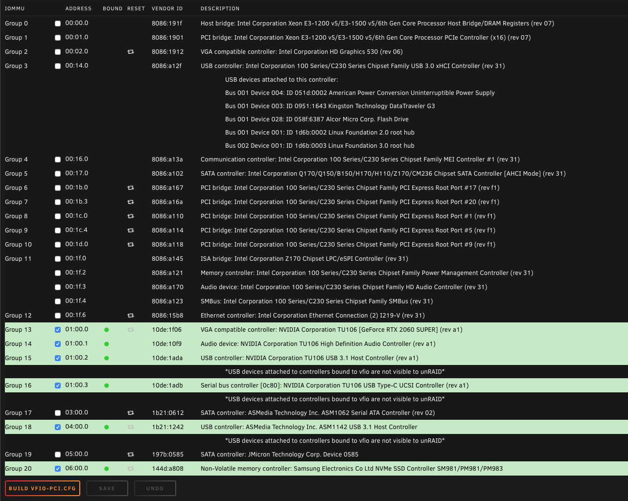

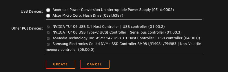

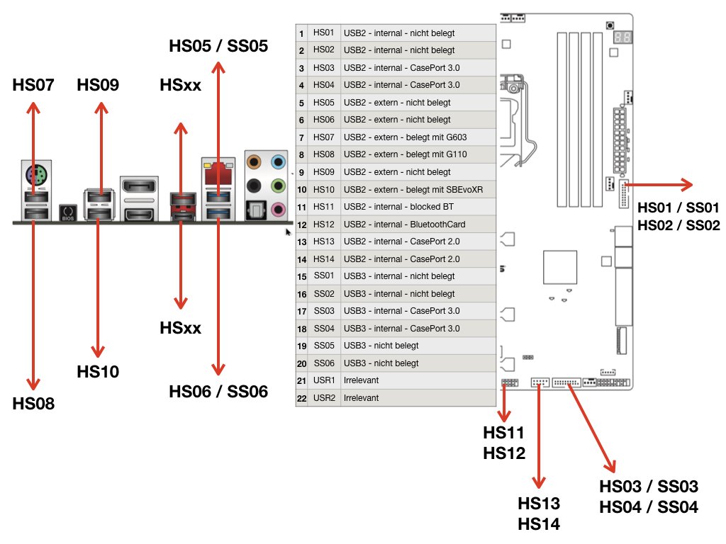

July 12, 20206 yr Author Ok - i think i found the problem. The USB3 ports (HS05-06/SS05-06 - see image below) seems not to passthrough correctly. First I attached a usb thumb drive at the USB3 port directly - nothing Next I attached the same usb drive at the USB2 port - immediately recognized by the VM Next I attached the same usb drive at the end of my 15m cable - immediately recognized by the VM So my main problem is solved - everything works now exactly as I want. Thanks for this tip. But now I have another challenge because I don't understand, why the USB2 port is working but the USB3 is not. The USB3 port is definitely working - as you can see the connected USB thumb drive (Alcor Micro Corp. Flash Drive (058f:6387)) Do you have any idea? Please find attached the vfio bindings, the vm-configuration and a screenshot from the manual ASMedia USB Controller ports are: HSxx (USB Type B) --> This port working fine for passthrough HSxx (USB Type C) --> cant be checked because I got no Type-C device HS05 / SS05 --> This port not working - whether directly (USB drive direct connected to port) nor via the long usb cable and active USB-hub HS06 / SS06 --> This port not working - whether directly (USB drive direct connected to port) nor via the long usb cable and active USB-hub
July 12, 20206 yr You have two USB controller, only ASMEDIA was passthrough by VFIO-PCI That means only typc-c and the upper port ( RED one ) are come from ASMEDIA. Other 14 ports are come from Chipset. As you haven't passthrough Chipset USB controller, in fact you can't because Unraid boot USB also attach. So, below is normal HS05 / SS05 --> This port not working - whether directly (USB drive direct connected to port) nor via the long usb cable and active USB-hub HS06 / SS06 --> This port not working - whether directly (USB drive direct connected to port) nor via the long usb cable and active USB-hub And that's why HSxx (USB Type B) --> This port working fine for passthrough HSxx (USB Type C) --> cant be checked because I got no Type-C device Edited July 12, 20206 yr by Benson

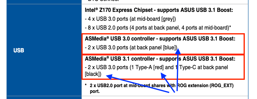

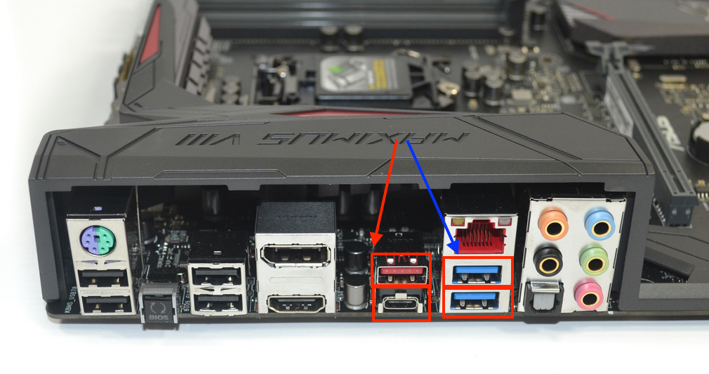

July 12, 20206 yr Author Where do you got those information? Sure that you got the ASUS HERO VIII ? My manual got a complete different information. As you can see below in the screenshot it says Quote ASMedia® USB 3.0 controller - supports ASUS USB 3.1 Boost: - 2 x USB 3.0 ports (at back panel [blue]) ASMedia® USB 3.1 controller - supports ASUS USB 3.1 Boost: - 2 x USB 3.0 ports (1 Type-A [red] and 1 Type-C at back panel [black]) And if you compare it to my back panel screen here - those four usb-ports should be ASMedia

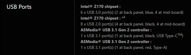

July 12, 20206 yr https://www.asus.com/Motherboards/MAXIMUS-VIII-HERO/specifications/ And ASM1142 are 2 ports only. Edited July 12, 20206 yr by Benson
July 12, 20206 yr Author ohhh man... i checked the german and french manuals as well. All saying, that ASMedia provides 4 ports. Only the specs you linked saying different things... Is there any chance to validate it?? Maybe through the connected usb thumb drive? Any cli-commands where i can see, over which controller the usb thumb drive is running?
July 12, 20206 yr 3 minutes ago, Maddeen said: Maybe through the connected usb thumb drive? Yes, remove USB controller passthrough and verify again. Pls note, as mention ASM1142 are 2 ports only. Edited July 12, 20206 yr by Benson
July 12, 20206 yr Author ha.. found it -- right in front of my eyes 🙈 Thanks for your help @Benson - CLOSED
