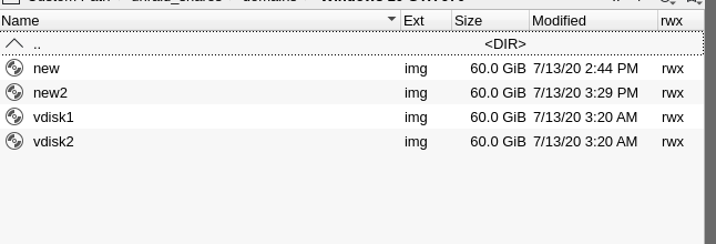

Okay so I ran the command and created new vdisks. No change in sizes as they still eat up 60G when in they're actually only half full.
I'll just rebuild the VMs using qcow2.

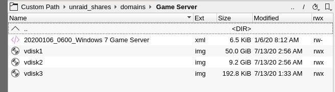

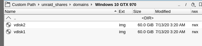

I ran the command you specified and got a similar return however other VMs created with qcow2 show correctly, also when copying to my NAS for backup the vdisk1 & vdisk2 takes up the full 60G
Fedora shows correctly which was created with qcow2 and has 30G allocated.
Windows 7 Game Server with vdisk1 being an offender, vdisk2 was created using qcow2 and has 60G allocated.
Windows 10 with vdisk1 & vdisk2 showing the full 60G despite the below....
You'd need to copy with the --sparse-always flag, assuming the NAS filesystem supports that.
QCOW2 are compressed images, so they compress the zeros, i.e., all the blank space.
I see Johnnie. Okay thanks for the help mate.
The original vdisks were copied to the nas and back again so maybe thats where the issue came from.
Edited by Mr_Jay84
