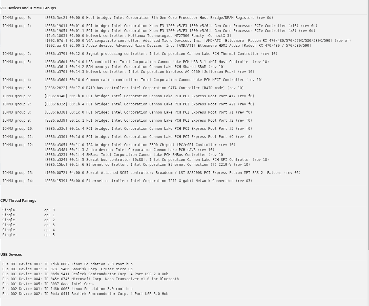

Been unraiding for a couple years now. Recently decided i wanted to use this unraid server as a second windows machine. After following the wiki page to install i got the windows vm installed but i cant seem to run it. This is the error message i get when i start the VM
Execution error
internal error: qemu unexpectedly closed the monitor: 2020-07-19T20:42:49.502359Z qemu-system-x86_64: -device vfio-pci,host=0000:00:1f.3,id=hostdev1,bus=pci.0,addr=0x6: vfio 0000:00:1f.3: group 13 is not viable Please ensure all devices within the iommu_group are bound to their vfio bus driver.

Any help would be appreciated!
Try to enable pci acs patch. Your iommu is not great
Envoyé de mon HD1913 en utilisant Tapatalk
I got it to boot after resetting unraid again. I first got it to boot with the video card working. then it stopped working and wont finish booting from the video card. If i use the onboard graphics it works if i use vnc it works but not the rx580
