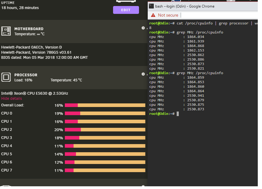

July 29, 20206 yr Author 6 hours ago, McKnight said: Haha, yeah I did indeed install and confirm the CPUs.. What I'll do is when I get home tonight, I'll check the bios for any werid settings and try and run live ubuntu and report back the CPU states from ubuntu if its the same then I guess unraid isn't the problem. Its a pretty old motherboard so it could just be some strange power saving feature. Will update later Just burning ubuntu now, but I played with the bios settings using this as a guide https://www.reddit.com/r/hackintosh/comments/6z2mc2/setting_up_the_hp_z800_workstation_a_work_in/ Anyway after booting in to unraid I get this: Still same issues with cpu power though Will update shortly with ubuntu findings Edited July 29, 20206 yr by McKnight
