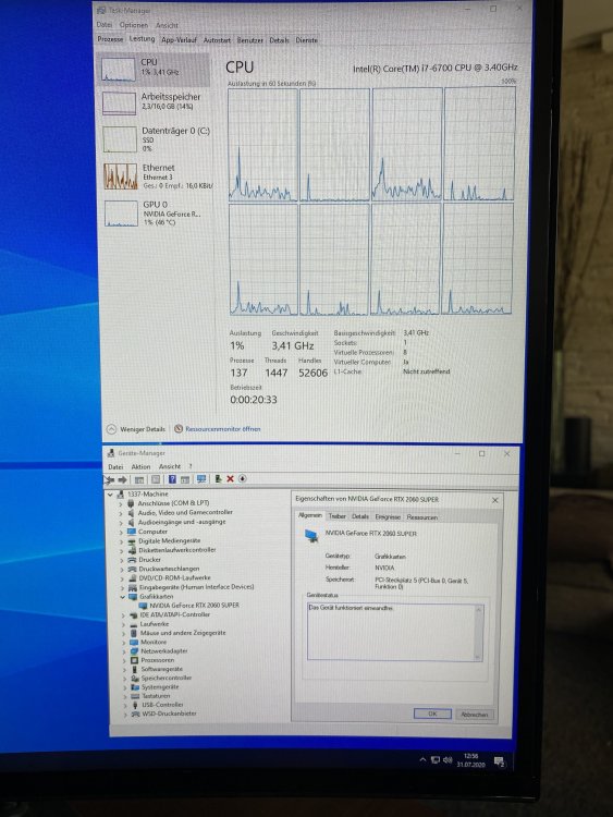

As today I can start my vm and the GPU fans immediately starts to spin up heavily bringing the vm in an unaccessible status - only forcing a shutdown and rebooting my unraid server can help to bring the GPU fans down.
Edited by Maddeen

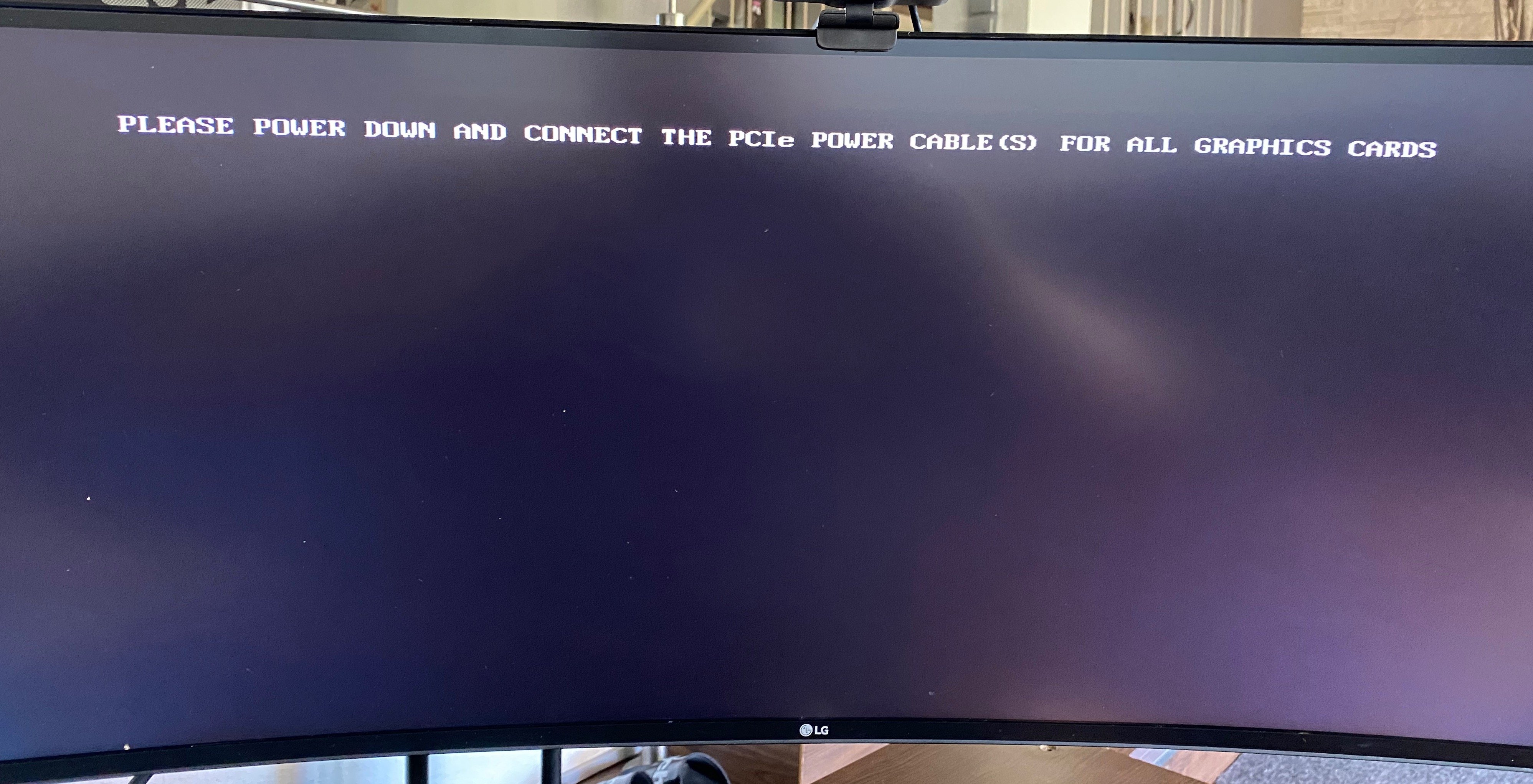

Update: I also got a message for about 2-3 times on my LCD telling me "please power down and connect the pcie power cable for this graphics card"
But in the meantime the vm started fine -- for about 3-5 minutes - and then crashed again, spinning up the GPU fans and become unresponsive 😭 (Screenshot IMG_3700.jpeg - thats what I see, when I'm connected via RDP and the VM crashes)

1) I used three different ones - the untouched from TPU, a "modded" one following THIS GUIDE and a dumped one that I generated by myself.
The dumped one is the one that causes the "please power down and connect the pcie power cable for this graphics card" error.

4) I'll double check it. But imho it can't be a problem because if the GPU dont have power it doesnt show up in the device manager of my vm (with error 43)

I opened the case - reconnected the cables at the GPU-side AND use the other 6+2 connector at my PSU.
Booted up unRAID - start the vm "Windows 10_i440fx_4.2_own_Vbios" -- and its running fine --- for now about 30 minutes without any problems. (see screenshot)
Maybe the cable got a loose connection because the cable connected at the GPU is also right next to the side wall of the case
Later I'll try some gaming to make sure, that is stable and reliable and give a final feedback for the community.

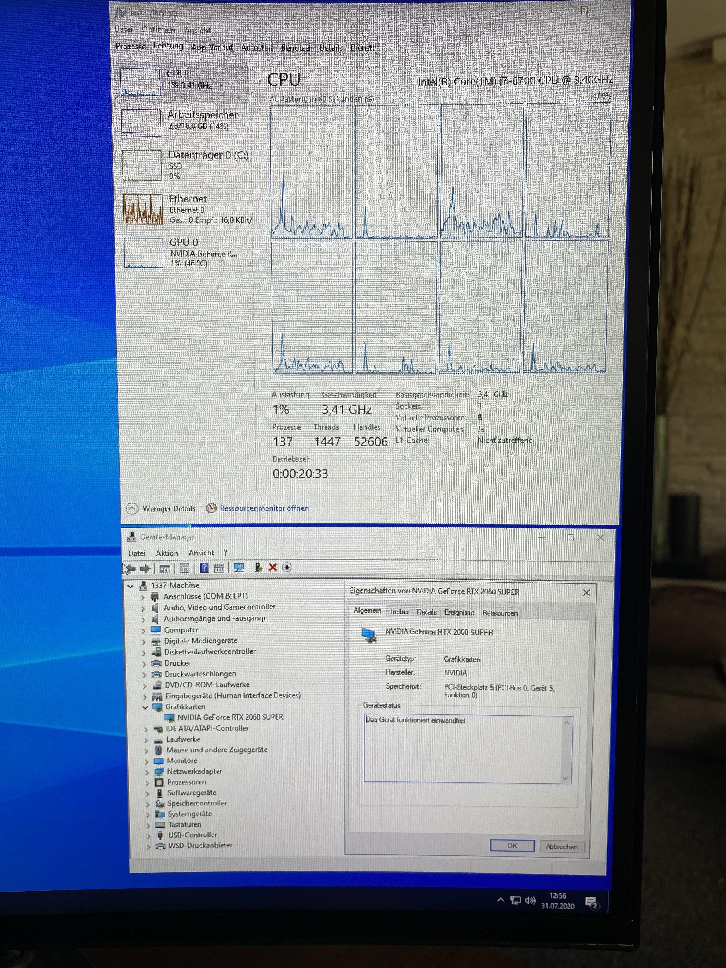

@testdasi - as promised - here's the update:
The vm (build on your edits) runs without any problems so far. I recently gamed about 2 hours - flawless :)
Thanks again and have a nice weekend.
