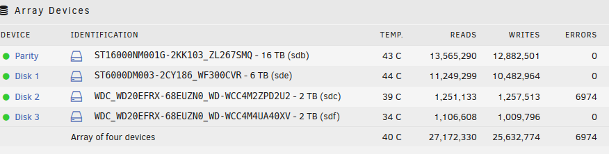

Does this mean this drive is dying?
Woke up this morning and noticed this disk has thrown 6974 errors.  It still shows green.
https://wiki.unraid.net/Troubleshooting#Hard_drive_failures
This FAQ suggests nothing to worry about, but it says no-zero.  6974 seems a bit more worrisome than non-zero.
Should I get a replacement?
For what it's worth, I'm copying a ton of data to the array right now (and for the last few days).

Well the SMART test has been stuck at 90% for quite a while now, so I'm just going to put the diagnostics here now.  Syslog looks like it's a bunch of read errors.  What does that mean?

Some of that might be connection issues, but there are these mixed in:
Jul 28 18:29:04 vault kernel: ata6.00: cmd 25/00:28:a8:08:72/00:03:06:00:00/e0 tag 5 dma 413696 in
Jul 28 18:29:04 vault kernel:         res 51/40:17:b0:09:72/00:02:06:00:00/e0 Emask 0x9 (media error)
Also, this SMART attribute is something to watch out for on WD Reds, in fact, I have it added to the notifications for those disks I have:

Regarding the connection issues, like a sketchy SATA cable or something?
Regarding the replacement, yeah I've got a spare drive.  Should I swap it out, or take a wait and see approach?
Did the short SMART test ever complete? I would replace. Do you know how?

Short smart test completed without error
Run an extended SMART test on it, maybe replace it first.
Extended SMART test said it had errors in the extended test but unraid still shows the drive is healthy.  Very strange.
Anyway I've got low activity on the system this morning so I'm going to replace it.
Any chance someone could explain what I should be looking at in that Extended SMART test?
That's normal, you'd likely have more errors on the next check/read, that disk should be replaced.
