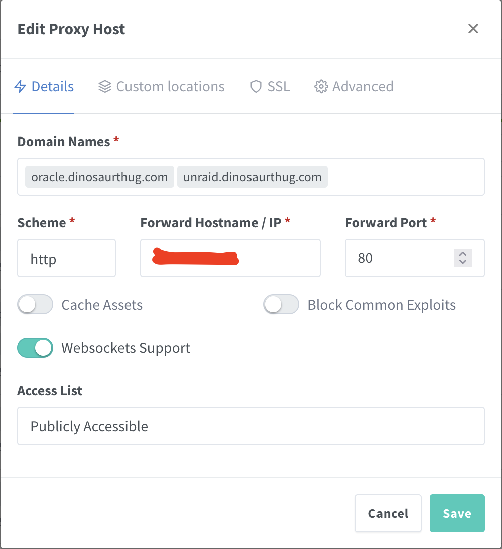

August 19, 20251 yr On 3/12/2024 at 1:40 PM, Vitek said:Could you show your config in Nginx proxy manager for Unraid web ui? Enabling WebSocket support does not work for me ;(Not sure if it helps you guys more than 1 year later but, I got it to work (make sure to also have a local DNS record in either pi-hole, your router, adblock home etc)my server name is oracle and i own dinosaurthug.com through cloudflare so I also generated an SSL certificate through them. Note: I do not expose this to the internet (I did not open/forward any ports)
