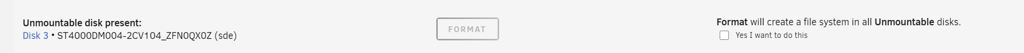

I reboot unraid then array can be start, but disk3 show Unmountable No File System issue, and I found  357015781_2020-08-07014605.thumb.png.698c6dfb1488d13beaf9712d5fcbbf60.png
Does it means data in Disk 3 has lost?There's my new diagnostics.

On 8/7/2020 at 3:35 AM, Squid said:
Did you
DO NOT FORMAT THE DRIVE
Also looks like you've got a bad / loose SATA connection within the system
