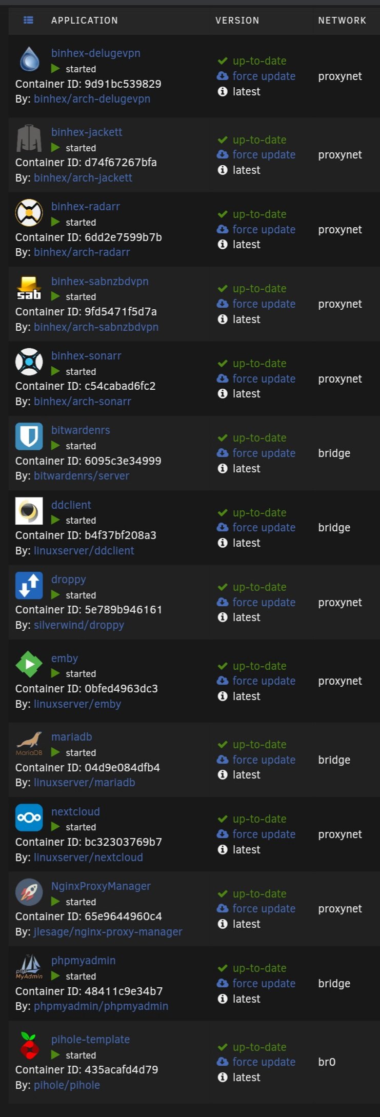

I have the below Dockers running and everything seems to be going well. I checked in on my Cloudflare dashboard and was surprised/shocked at the amount of attempts to access my site there have been. USA, Germany, Brazil, all sorts, from all places.
Now I don't know how many of these are genuine or are some sort of "bot" for backend systems scouring the Internet, however regardless, I want to ensure that I do all that I can to protect my server. I have utilised all of Cloudflares services to help, such as geoIP blocking, but I want to cover all bases.
I only have three ports open, 80, 443 and one for my WireGuard VPN. 80 and 443 are running behind NginxProxyManager and there is nothing in my unRAID logs to cause me any concern, at present. I wanted to use Fail2Ban that was incorporated into Linuxserver/Letsencrypt however I have (as of yesterday) made the move over to NginxProxyManager and they do not include it unfortunately.

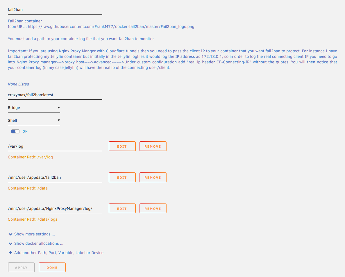

Would you be able to tell me what path i am suppose to put in the screenshot specifically ?

I have that template for fail2ban:

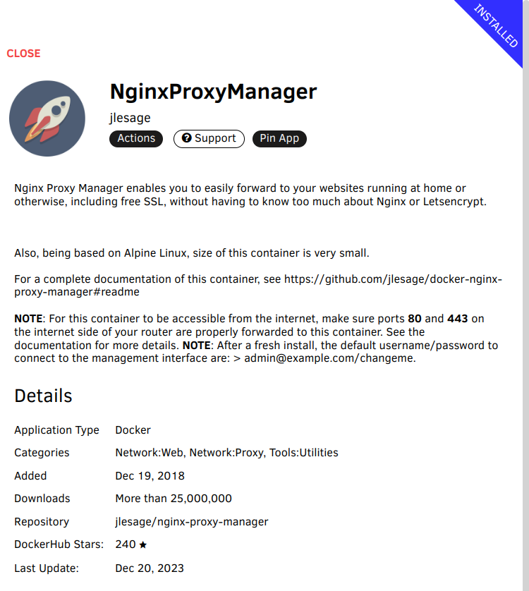

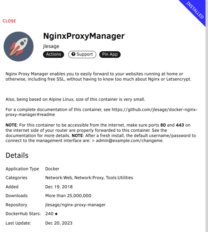

I have that NPM docker container:
I try to setup with that tutorial but stuck after jail.local file:
