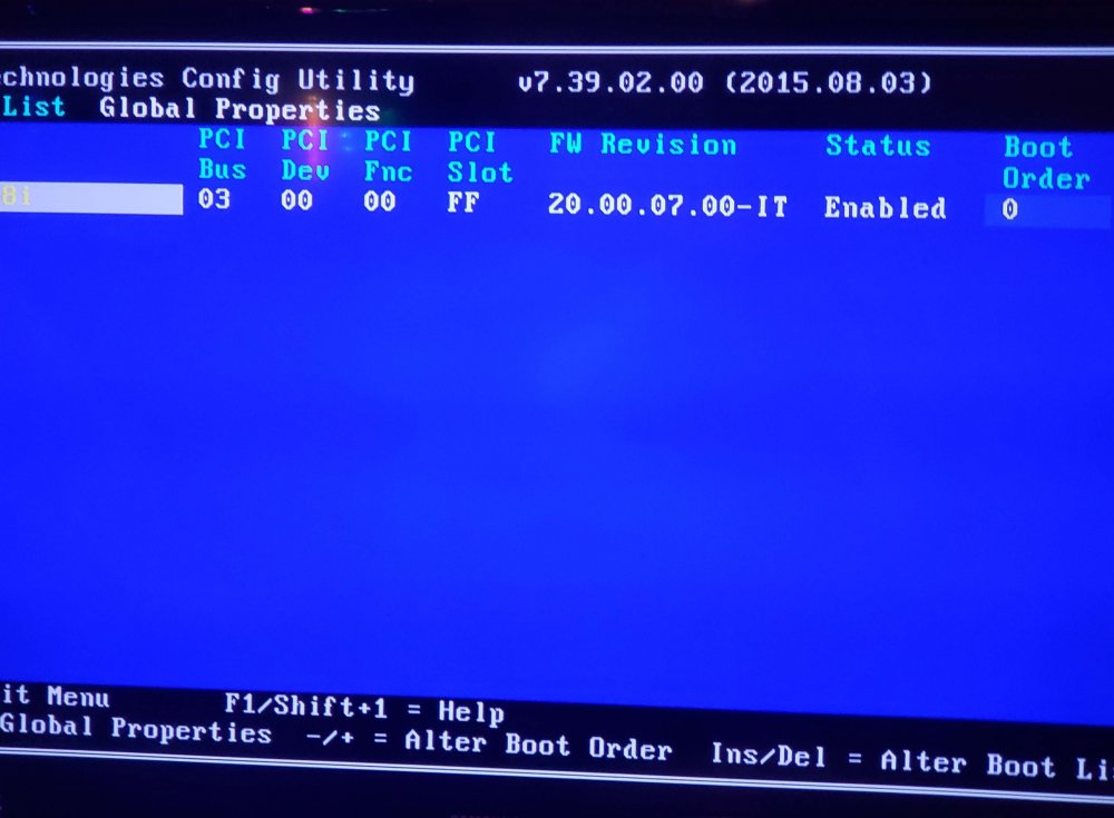

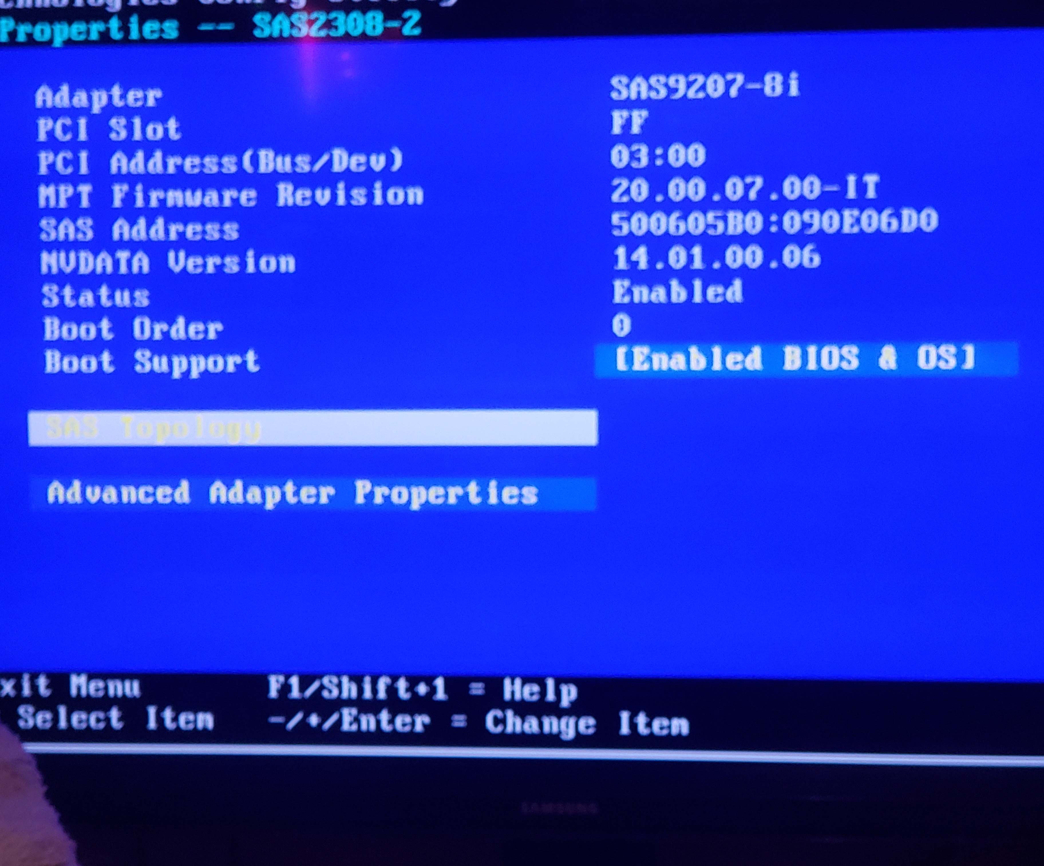

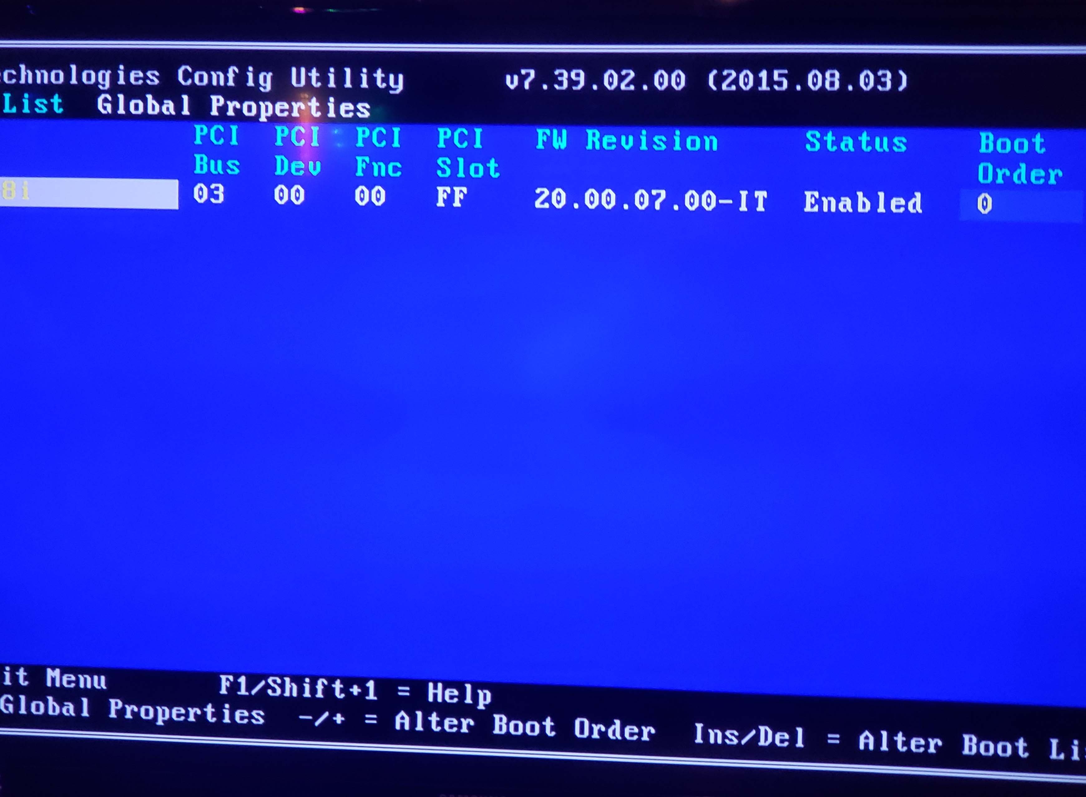

September 2, 20206 yr Hi. I just bought this card https://www.amazon.ca/gp/product/B0085FT2JC/ref=ppx_yo_dt_b_asin_title_o00_s00?ie=UTF8&psc=1 When Unraid boots it shows the LSI Card. The Avago Utility tool doesn't show any drives. I can't find the card in my BIOS unless I'[m missing it. Card is In IT Mode - FW 20 4 Drives connected to the card are WD 4TB - Came from my Qnap. ASUSTeK COMPUTER INC. - ROG STRIX X470-F GAMING Processor:AMD Ryzen 9 3900X 12-Core @ 4 GHz The card does show under system devices ( NOT UNDER SCSI Devices) IOMMU group 15:[1022:43d0] 01:00.0 USB controller: Advanced Micro Devices, Inc. [AMD] Device 43d0 (rev 01) [1022:43c8] 01:00.1 SATA controller: Advanced Micro Devices, Inc. [AMD] 400 Series Chipset SATA Controller (rev 01) [1022:43c6] 01:00.2 PCI bridge: Advanced Micro Devices, Inc. [AMD] 400 Series Chipset PCIe Bridge (rev 01) [1022:43c7] 02:00.0 PCI bridge: Advanced Micro Devices, Inc. [AMD] 400 Series Chipset PCIe Port (rev 01) [1022:43c7] 02:04.0 PCI bridge: Advanced Micro Devices, Inc. [AMD] 400 Series Chipset PCIe Port (rev 01) [1022:43c7] 02:06.0 PCI bridge: Advanced Micro Devices, Inc. [AMD] 400 Series Chipset PCIe Port (rev 01) [1022:43c7] 02:07.0 PCI bridge: Advanced Micro Devices, Inc. [AMD] 400 Series Chipset PCIe Port (rev 01) [1022:43c7] 02:09.0 PCI bridge: Advanced Micro Devices, Inc. [AMD] 400 Series Chipset PCIe Port (rev 01) [1000:0087] 03:00.0 Serial Attached SCSI controller: Broadcom / LSI SAS2308 PCI-Express Fusion-MPT SAS-2 (rev 05) [1b21:1242] 04:00.0 USB controller: ASMedia Technology Inc. ASM1142 USB 3.1 Host Controller [8086:1539] 06:00.0 Ethernet controller: Intel Corporation I211 Gigabit Network Connection (rev 03) Using these cables https://www.amazon.ca/gp/product/B012BPLYJC/ref=ppx_yo_dt_b_asin_title_o05_s00?ie=UTF8&psc=1 These cables were new, tried both sets. I think this card will work, something is just out of whack somewhere. Could it be the IOMMU groups, unassigned devices? I do have a ssd drive mounted in unassigned devices. This is the 2nd card I have bought and it is the closest I have gotten. Green light is flashing. These cards sure do run hot. My case is pretty open, might have to put a fan on it. Hopefully someone can help before I pull all my hair out, or run out of money buying cards. LOL Thanks Randy
