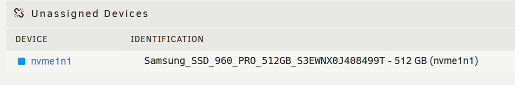

I also have installed a Seagate 960pro 512bg NVMe drive - which Unraid also sees, however, I am not able to assign it as a secondary cache option (I can assign it as a disk option). My plan was to run a RAID 1 array for my cache for extra security.

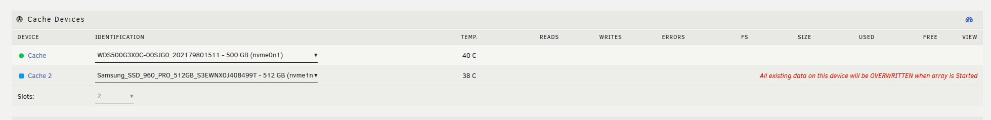

You may just need to increase the number of cache slots. Or you have chosen the wrong filesystem. Must be btrfs.
Stop the array and post another screenshot showing Cache Devices.

Thanks trurl
So I rebooted my system to start from scratch. I was able to assign another "slot 2" and I have added the second cache drive per my original plan.

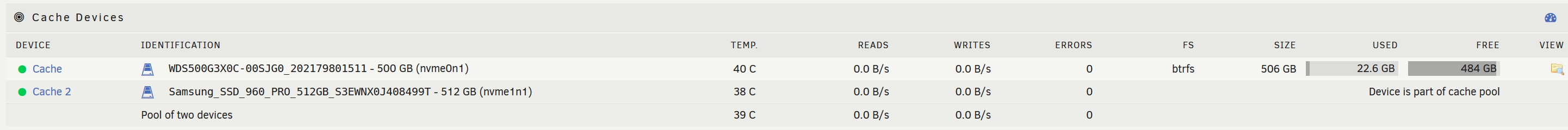

This is the operation now:
Does it seem accuate? Is it supposed to be Btrfs
BTRFS (or BTRFS encrypted) are the only file system types supported if you have more than 1 drive in the pool.
