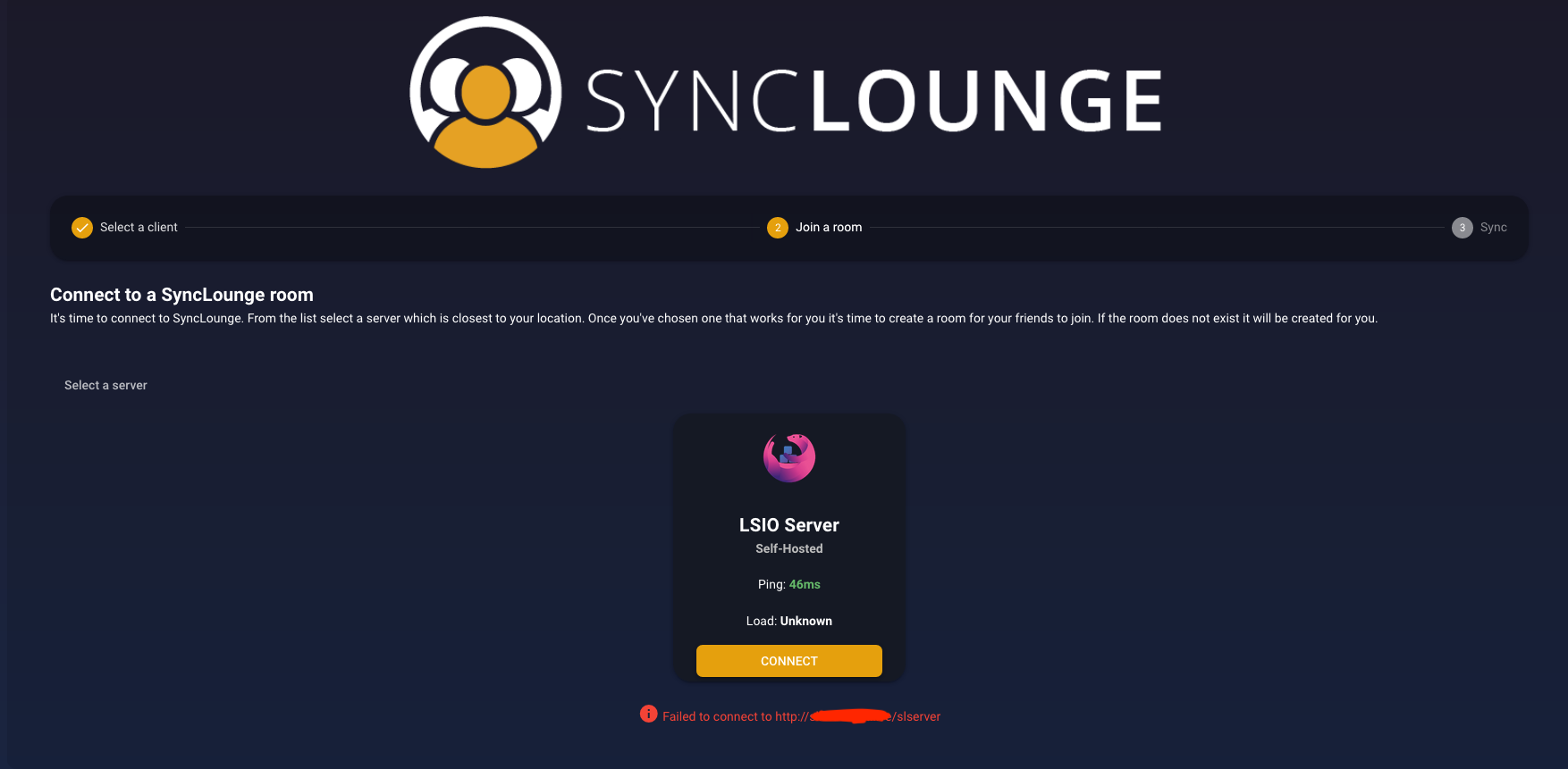

October 21, 20206 yr Hey linuxserver Thanks for this. I've managed to set up the container without any issues. In the template, I entered my reverse proxy url for synclounge (under 'EXTERNAL URL', and left all the optional stuff blank. So, now I'm in the webuil but after I login and select a client, I cannot move past Step 2:Join a Room. Seems synclounge can login and see my server, but cannot connect. It connects fine if I use the actual synclounge website..but the point was to self host synclounge in the first place. My log at startup: Quote ------------------------------------- GID/UID ------------------------------------- User uid: 99 User gid: 100 ------------------------------------- [cont-init.d] 10-adduser: exited 0. [cont-init.d] 30-config: executing... Fixing permissions. FYI, you don't need to set the PUID env var because this app is stateless [cont-init.d] 30-config: exited 0. [cont-init.d] 99-custom-files: executing... [custom-init] no custom files found exiting... [cont-init.d] 99-custom-files: exited 0. [cont-init.d] done. [services.d] starting services [services.d] done. > [email protected] server /app/synclounge > node server.js SyncLounge Server successfully started on port 8089 Running with base URL: /slserver servers/SERVERS must be an Array of JSON objects. Attempting to convert it for you. - Done. SyncLounge WebApp successfully started on port 8088 Running with base URL: /slweb Access URL is sl.xxxxxx.xxx/slweb Servers List: [ { name: 'LSIO Server', location: 'Self-Hosted', url: 'http://sl.xxxxxxxxx.xxx/slserver', image: 'https://avatars3.githubusercontent.com/u/12324908?s=200&v=4' After starting, my log keeps repeating this: Quote Catch all: /slserver/health Catch all: /slserver/health Catch all: /slserver/socket.io/?EIO=3&transport=polling&t=NL8lQ1g Catch all: /slserver/health Catch all: /slserver/health Catch all: /slserver/socket.io/?EIO=3&transport=polling&t=NL8lQuE Catch all: /slserver/health Catch all: /slserver/socket.io/?EIO=3&transport=polling&t=NL8lRH5 Catch all: /slserver/socket.io/?EIO=3&transport=polling&t=NL8lRH5 Any support on this would be greatly appreciated!

October 21, 20206 yr Thanks @disbedan015 I had so much hope.. I added 8089 as EXTERNAL SERVER PORT, and at first, it seemed to be working. I can pick up all 3 devices from step 1 (selecting the client), and when I get to step 2, it will attempt to connect, but fails with the same message after 20-30 seconds. This time the error on the bottom of the page shows: 'Failed to connect to http://sl.xxxxxxxxx.xxxx:8089/slserver' I was hopeful because it would instantly show the error message before I added the external server port. After adding it, it stopped showing the Ping or Load, yet when I clicked 'connect', it showed the loading circle, which led me to think it was working... but i got juked. Any additional suggestions to try?
October 21, 20206 yr Only other thing i did was have port forwarding setup for both 8088 and 8089 so the sever is accessible from the outside web since it defaults to public ip address access.
