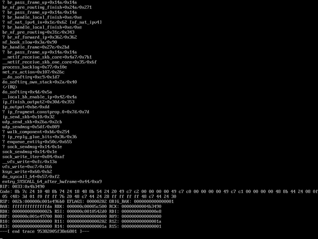

October 4, 20205 yr Hello, I am having a problem with regular crashes of my Unraid server. Those crashes usually happen after 1 - 10 days of runtime. I have attached 13 screenshots of the last screen that I took using my mainboard's remote control via webinterface. About 80% crashes happend during 02:00 AM and 09:00 AM, when nothing much happened at that time. Sometimes they occured during active usage of the server as well though. In the last ~6 months I have probably had a total amount of ~30 crashes of that kind. Unfortunately I did not have time to address them properly until now. I ruled out a few things already: corrupt appdata on a BTRFS cache drive (running array without any cache drive -> crashes remain) OpenVPN AS Docker: disabled for a few weeks, same crashes My system Unraid 6.8.3 (Unraid DVB Edition) Mainboard: Supermicro X11SPi-TF CPU: Intel Xeon Silver 4210 RAM: 4x 32GB Samsung M393A4K40CB1-CRC DDR4-2400 regECC DIMM CL17 Single (not tested with memtest before installing Unraid) GPU: 2x INNO3D GeForce GTX 1650 Single Slot Cache drive: 1000GB Samsung 970 Evo Plus M.2 2280 PCIe 3.0 HDDs (Array): 4x WD 8TB Red I bought most of the hardware as completely new hardware back in March/April this year (except for some of the HDDs which I have had already). I have then extended the server with 2 more RAM sticks and 2 graphics cards in ~May. The problems have been happening before that already, with the 2 starting memory modules I have had installed. My mainboard has 2 network ports, currently being used in bonding mode. I have used one of those ports in single mode before, but the same crashes have happened back then. I have attached some diagnostics files when the server was active. Unfortunately I could not get those diagnostics files after a crash. However, some of those diagnostics logs seem to have the same kind of errors as well. I also managed to log a "crash" when it seemed to actively happen, but only through copying the logs itself from the webinterface console, as I could not download any diagnostics through the webinterface itself at that point anymore: kernel_error_2020-09-07.txt Could these crashes by related to bad RAM? As those RAM modules are regECC-modules, I would have expected those kind of errors to look different though - but I have never used any regECC-RAM before. I am also using Pi-hole docker. As those errors usually contain something about "NAT" and IPv4/6, could this be the cause as well? Disabling Pi-hole for weeks would not be that easy though as I am using its DNS services for DNS resolution of my TV server and other important services as well.. Thanks in advance jnk diagnostics.zip screenshots.zip Edited August 3, 20215 yr by jnk22 Problem solved

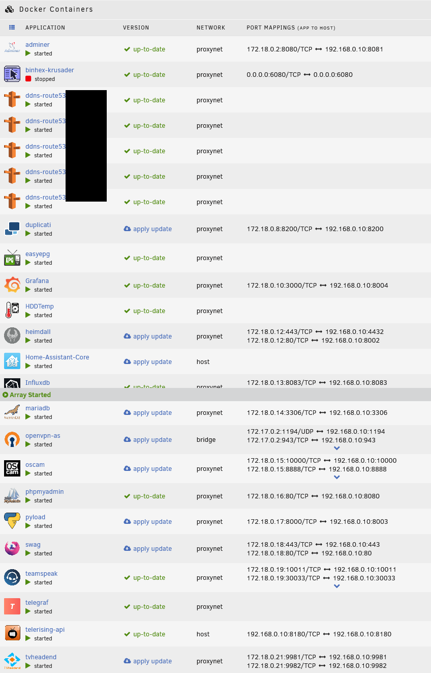

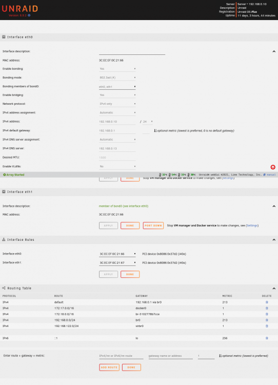

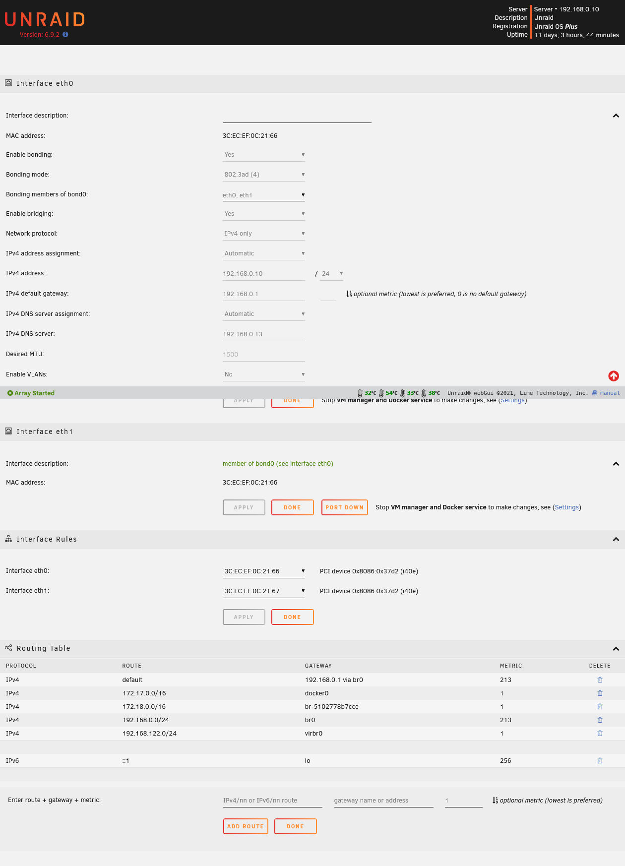

April 24, 20215 yr Author Unfortunately I still have those errors, so disabling IPv6 has not solved this error. The errors occured with all new versions: - 6.9.2 - 6.9.1 - 6.9.0 - 6.9.0-RCx - 6.8.3 This table shows that kernel crashes still appear regularly, with a longest uptime of 22 days (due to an update): It seems that more users are having those kind of crashes since ~6.9.x: I do not know if this thread is directly related to my problem, as most of those users seem to have their dockers running on "bridge" network only. My docker instances use these 3 network types: - bridge (only OpenVPN-AS - will try to replace this with WireGuard for now) - host (2x) - proxynet (21x - custom network, details attached as .txt file) As I probably cannot set up VLANs due to hardware limitations, I'll try to remove the bridge- and host-dockers by replacing them with alternatives for now to further narrow down the cause. I have attached a file with my docker-network settings and my Unraid network settings as well. latest_crash.txt docker-inspect-network-proxynet.txt Edited April 24, 20215 yr by jnk22
August 3, 20215 yr Author After 90+ days of uptime I can confirm that these changes seem to have solved my problem: - Settings -> Docker -> Host access to custom networks: Disabled - Use custom network "proxynet" for ALL docker instances (before: host + bridge + proxynet) - might be unrelated It is probably due to disabling host access to custom networks as stated here: Since then there is no call trace to be found in my logs anymore 🙂 I'll mark this thread as solved.
